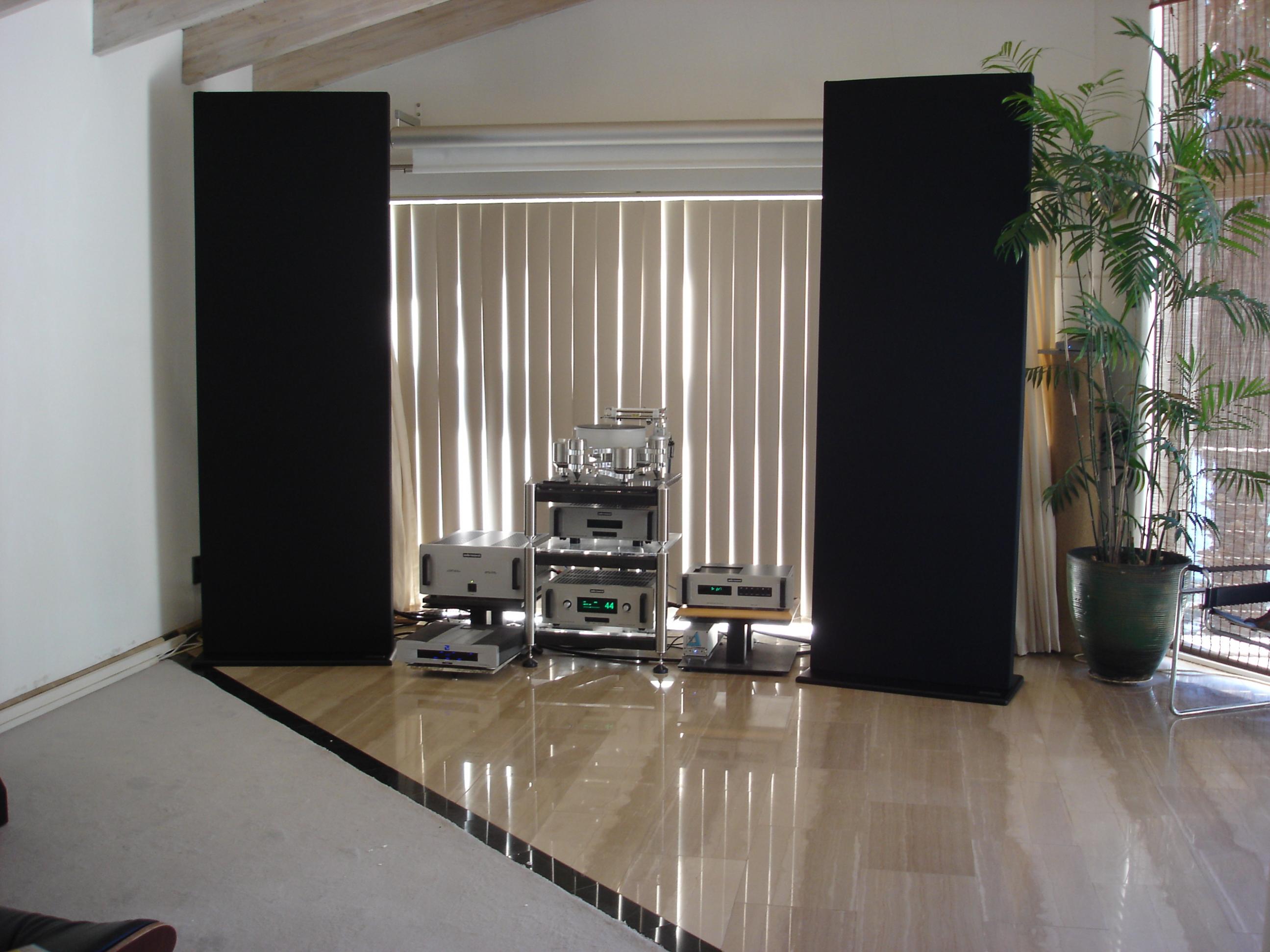

I have had great luck using the jig with my 2 prs of 6600's as fronts for 2 systems one using a pr of 4400 as rears for one set with 1+1 for the other. debating if to use a model 1 on it's side inder the Elite plasmas for centre channel.

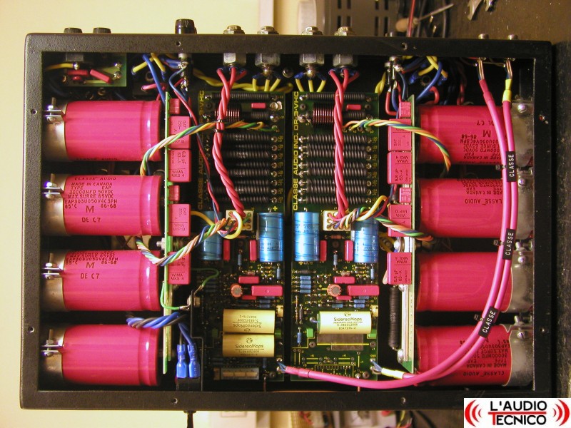

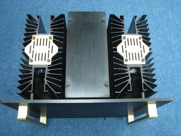

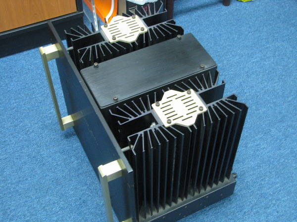

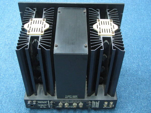

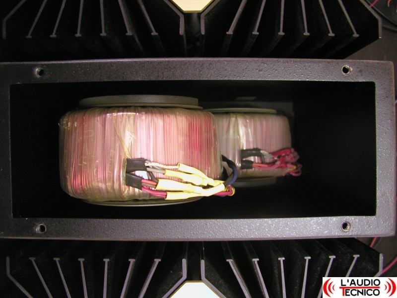

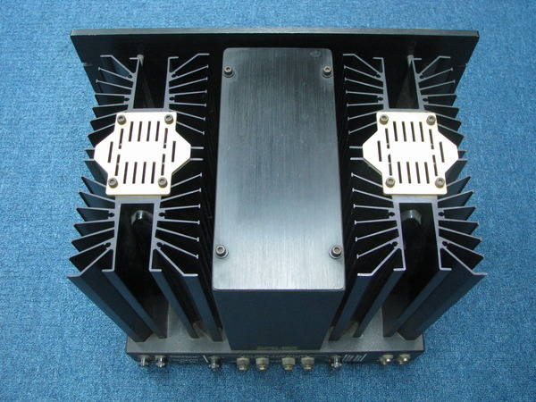

Hi guys from 1988 to 2000 this was the amplifier i used with Acoustat 1+1s - 2+2s - Spectra 22s - and Spectra 33s - all of them with a Classé DR3-VHC a little 45 watts per channel pure class A and Conrad Johnson preamps ( 3 ) sold all the system when i moved to a condo in 2000.
