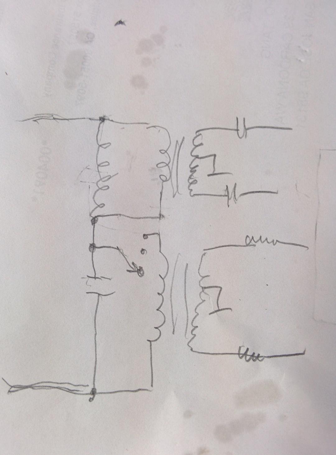

Series input configured
I had one pair of 1+1, anybody try series the input transformers and take out the one ohm resistor. Can this change make the speaker a little bit louder?
I had measured the high voltage before the 500Mohm resistor with HV probe and get 4300V, is this normal. Thanks.

Your bias voltage measurement is within expectations. High Voltage probes tend to load the supply, so you’ll never read the full 5000 VDC.
Removing the 1-ohm resistor in series with the LF transformer will not make the speaker play louder. It is there as a safety measure, since most amplifiers don’t like the speaker’s very low impedance at low frequencies. The 1-ohm resistor keeps that impedance above a practical limit.
Placing the transformers in series will not make the speaker play louder. In fact, it will pretty much ruin the entire speaker’s performance. This is a very bad idea.
Keep in mind that the 1+1 has limited panel area and is not designed to fill even medium-sized rooms with concert hall levels. I don’t know what amplification you are using, but it may be that you have reached the speaker’s inherent limit.
