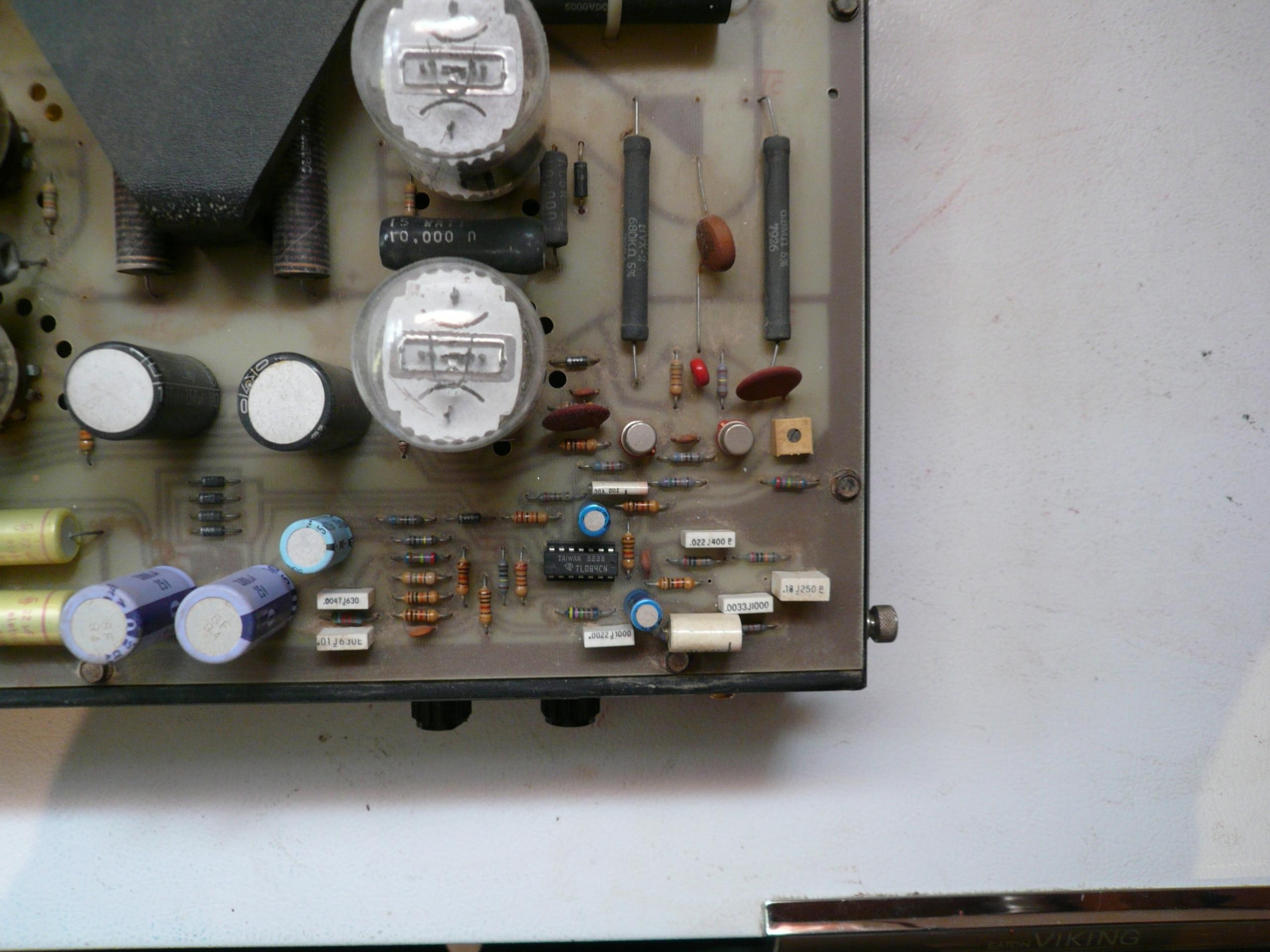

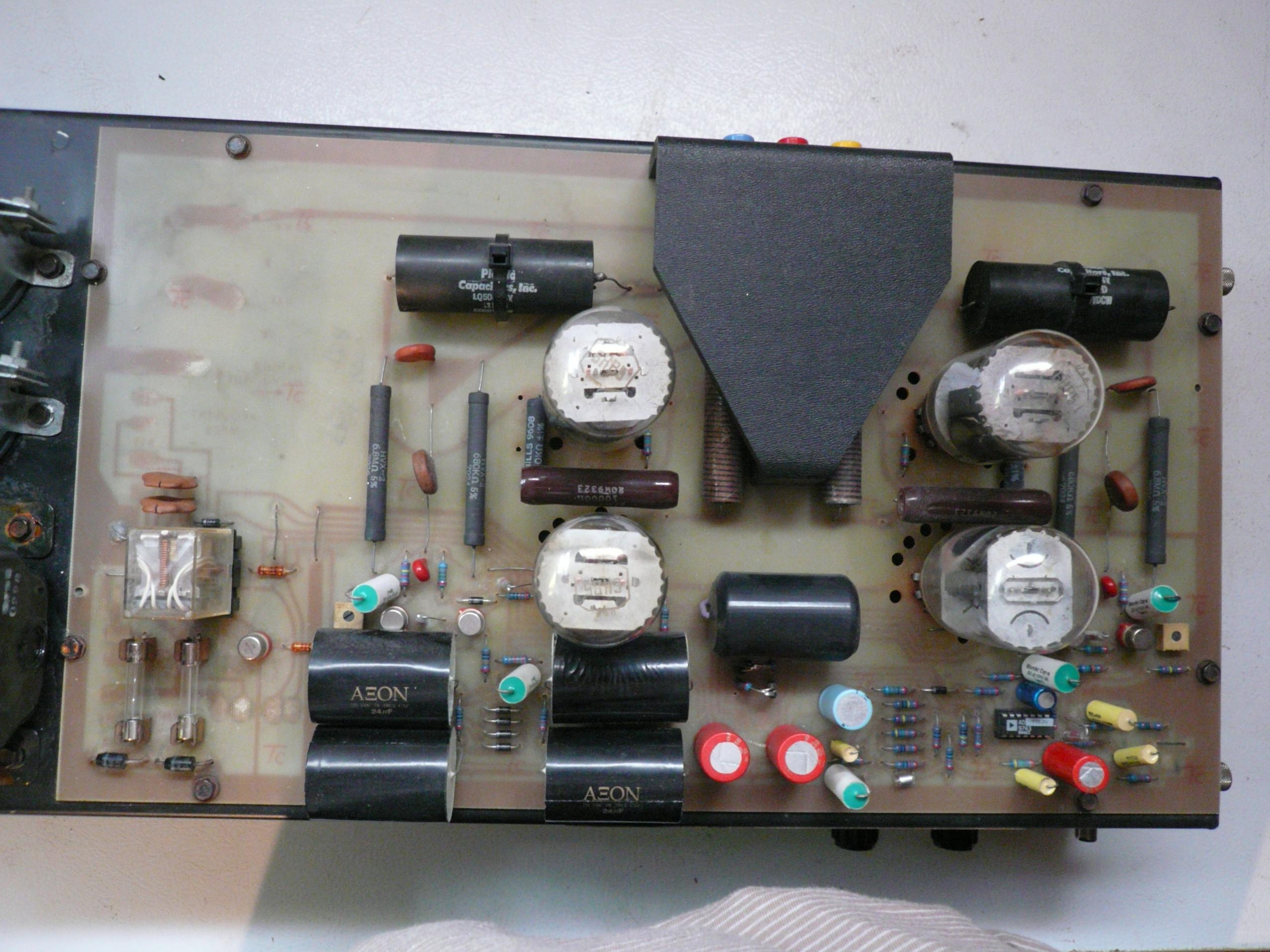

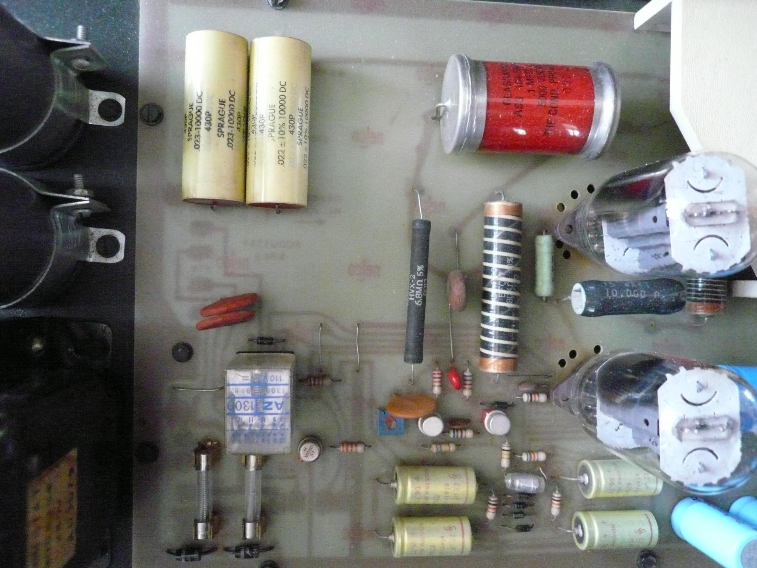

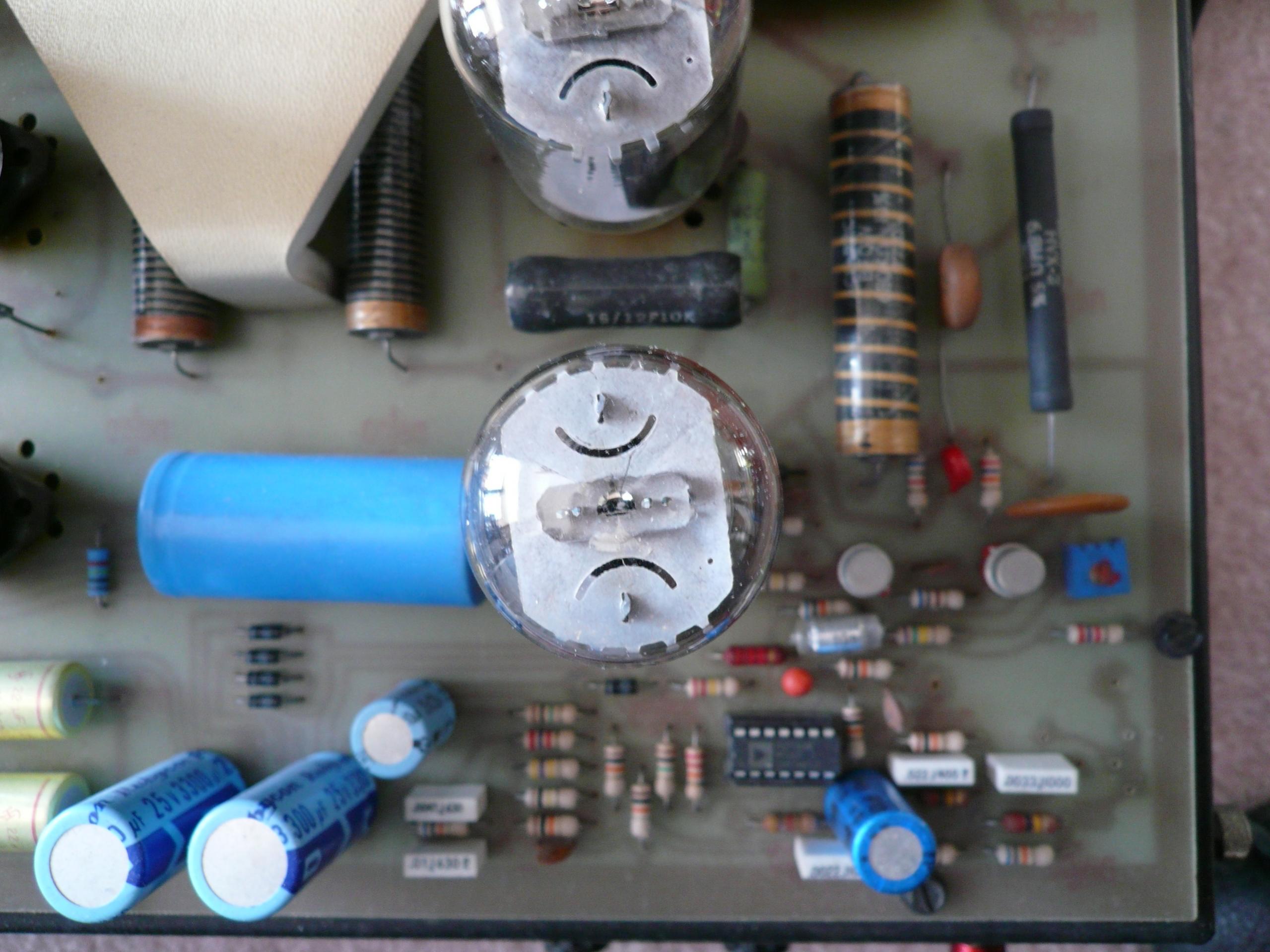

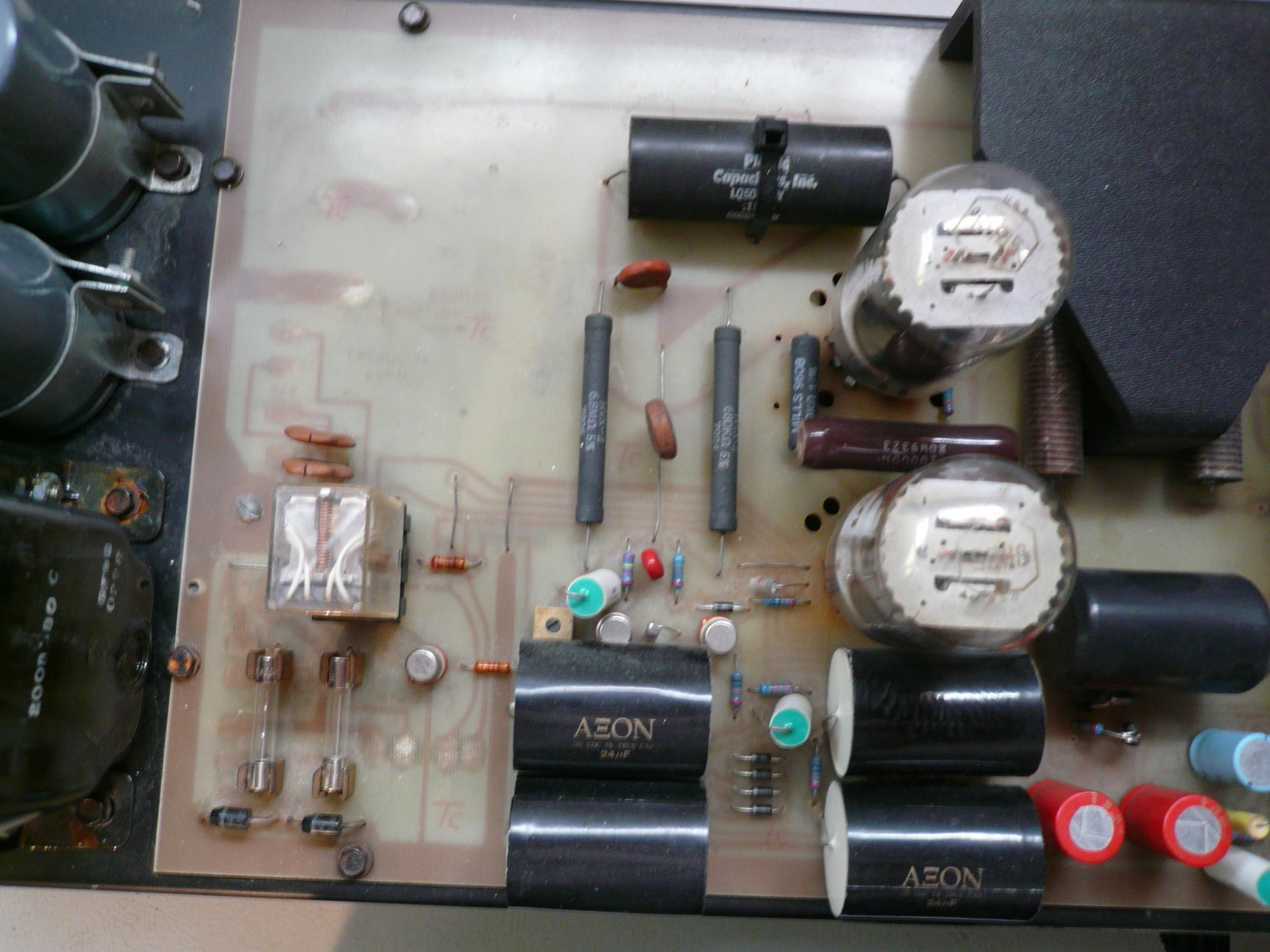

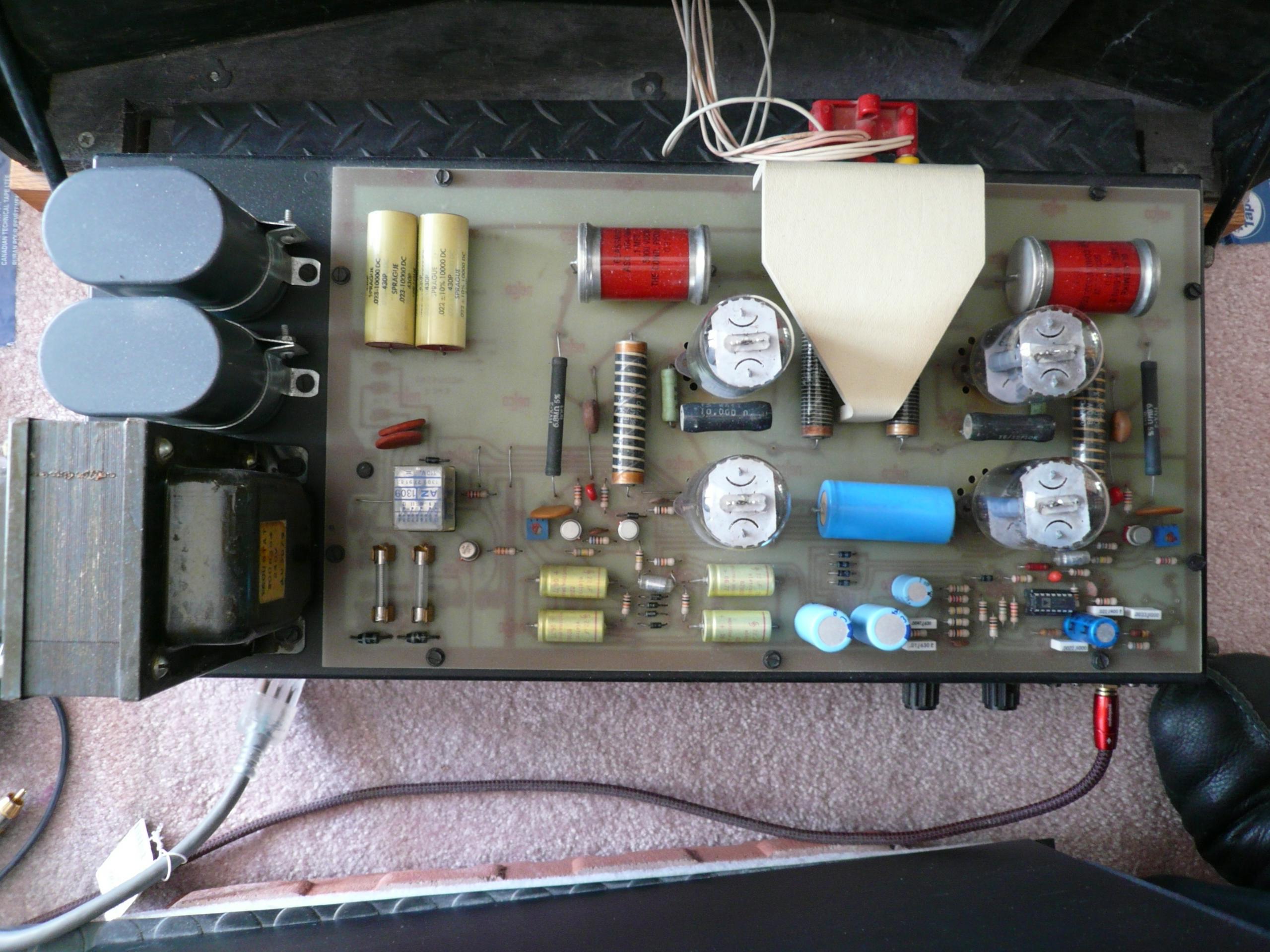

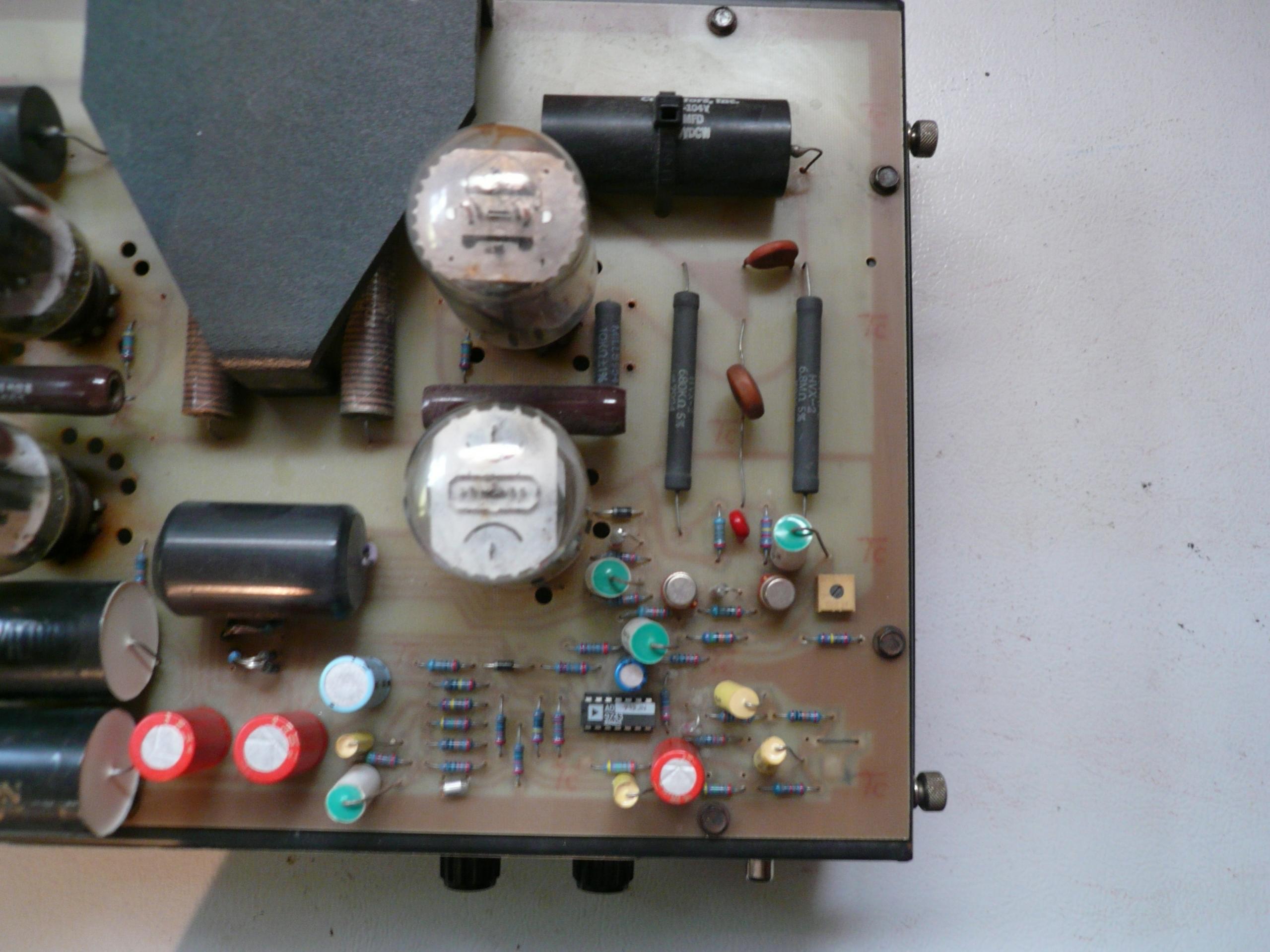

Apparently with modification, I've read that the servos can be made to drive the Spectras. Should they? Heck yeah! I have both Monitor 3 and Model 3. Ime, there really is no comparison. I have red medallion interfaces and they sound great with the Model 3 but the Servos with the Monitors are in a different league. The panels of both are identical. So yes, the King was dead when Acoustat discontinued them; very bad move imo. Others are apparently glad they converted theirs to interfaces. I don't get it. Theirs lots of upgrades and tweaks for the servos too. Mine have been stone reliable and I use them a lot. Mind you I bought them with upgraded parts. I have several pairs and the ones I bought with the Monitors were also upgraded parts versions which were stored outside in a shed for 15 years and filthy, looking like they survived a flood almost. I cleaned them up, plugged them in and they ran like a champ, no noise or any adverse behavior. Some say reliability is questionable. I have to disagree. However, the upgrades could very well be responsible for that.
What were the upgraded parts? Any pictures?
Thanks, some of the weak points I see are the possible use of tantalum caps in the circuit. Also, a protection and delay circuit would be nice given the fixed bias scheme. Should the -150 drop out, the output tube current would go thru the roof. Has anyone made the fixed bias adjustable and added a resistor at the cathode for measurement? Also, with the 150v available, it seems replacing the phase inverter/eq opamps at the input would be a nice upgrade. I don't mind the discrete driver but opamps sound horrible to me. I might try to load this into LtSpice and try some experimenting..
Any other ideas to make this amp more reliable? Maybe a different output tube like a PL509?
Here are the pics of the ones currently in use. Not sure what was done. I will take pics of the ones I referenced in your quote also.
