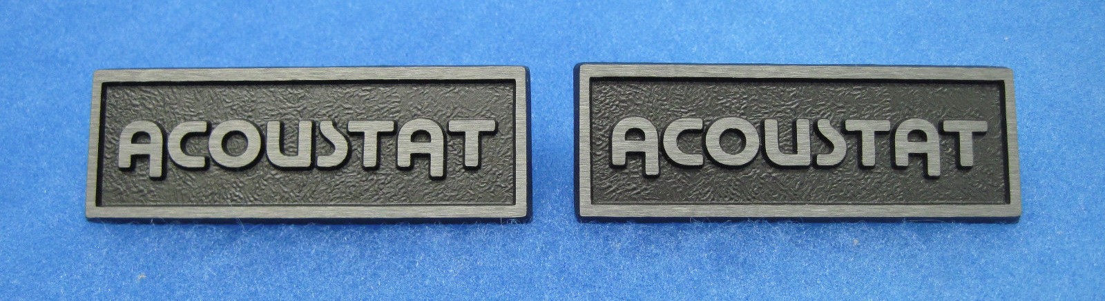

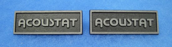

I found them on Ebay for a used pair of 1+1s I purchased a while back.The Acoustat Spectra 11s I bought recently were missing the front gold Acoustat badges that go between the 2 woofer and the panel -any idea where I could purchase a set of new ones?
acoustat badge | eBay
