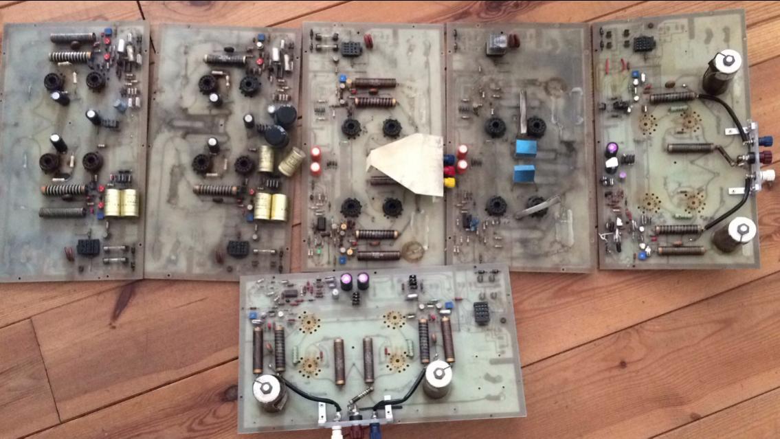

But if the panels have low output...only thing I have ever found ...is low bias...or bad leeking of bias....even with a bad interfaces trans..get the bias right....thay well play..I have had about 50 Acoustat panels now....an 10 pr of MK 121 interfaces or more....99% of any low output is Bias...buzzing...if not lose inside panel wire..Bias !
Ezey fix..Less than $30. US.
Low Bis makes people sale Acoustat For low Cash.....
I have panels...near 30 years old...never been clened....put 5k bias on them...thay can be driven to full output with 50-70 tube watts..
Good luck...have fun an great sound with Acoustat ESLs
