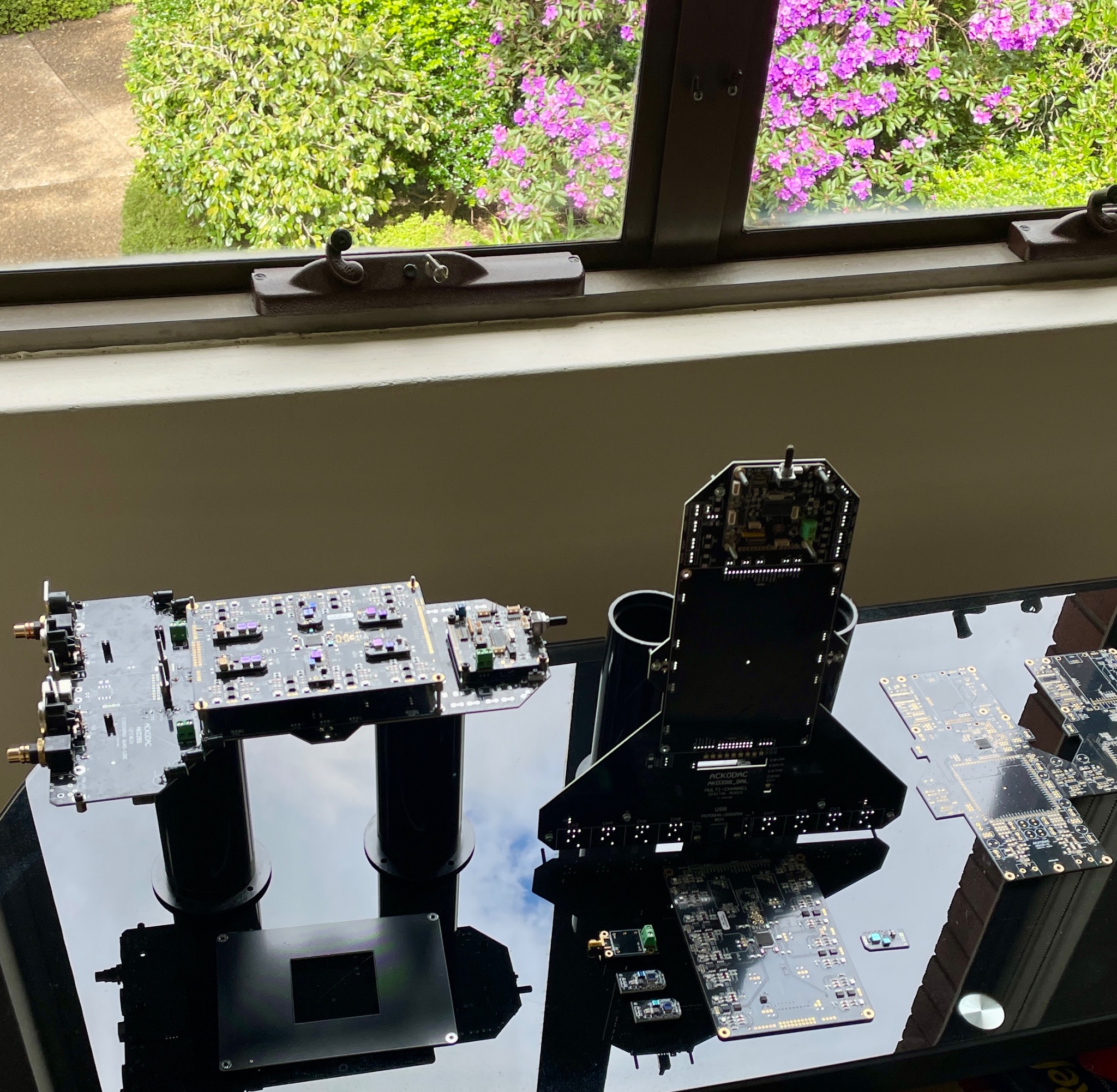

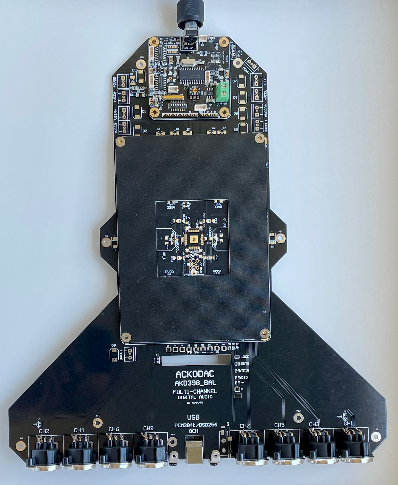

Hello @BenoitMathieu, thank you for your interest. This DAC is largely modular with the Core Module consisting of the 9039PRO chip in current output mode and x8 ch
I-V ccts laid out on the same module close to the DAC chip. Then all separate power supply modules for each section (no sharing). The Controller is a separate module with isolated connections. Clocks can be on-board or external. All these arrangements for the highest performance and flexibility.,So there is a fair bit of parts and complexity on the main board itself. After this pinouts to the application specific board for 1 to 8 channels configuration as required for the use case. For the initial batch, most modules are already included and connected up for a finished unit ready to power up and listen - for evaluation. If successful then we can discuss about different options (and prices) 🙂
A combination of, power sequencing, soft start, mute and standby functions are used to minimise pop noise during power on/off events without having to use relays. Will check these later for effectiveness…As I have had a bad experience with DIYinKH 8 channel dac because of the switch off capacitor discharging shout in the drivers, I wondered if your design was preventing this or if you plan to add microrelays in the outputs stage to switch them off early.
