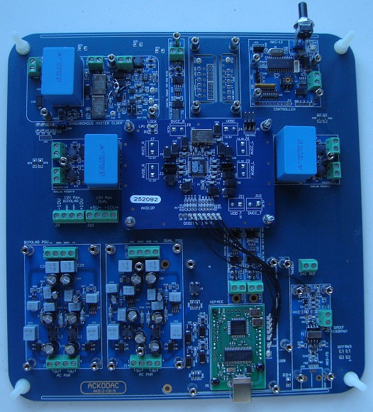

Integrated Combo
For those whose want something ready built consider the combo series. The latest one shown below has this Synchronous Master Clock. integrated. PM me for DAC user's manual and other details.

cool, a number of us have been waiting for that, thats my sub channels right there. hey but that doesnt look like the balanced outs are available on the IV? i'll send you an email later, i've got some interesting plans for this baby. could just tap them I suppose
Hi acko,
Three questions:
1. The u.fl and 2.54/5mm pin header stuff at the top centre of the combo you've just shown, are they just there to change termination style available depending on input devices i2s style?
2. With the combo boards is deleting options from the combination a possibility? Ie to purchase the one pictured above without synch master clock, spdif and usb?
3. What is the purpose of the onboard osc in a system with the synch master clock integrated?

Hi acko,
Three questions:
u.fl is used for MCLK inputs. All digital signal inputs are w.fl types. No header options. I have got adapter kits for selected transports like EXA2UI, Empirical Audio OFFRamp4 USBPAL and Hiface that would make neat connections to the DAC inputs. Will post pics soon.
Yes, you can opt out and price will reduce accordingly
Ok, shown was stock DAC module that had XO mounted already. This will be removed eventually when Sync Master Clock is used (undergoing testing now). Also, the XO for the Sync Master in the pic is CCHD957 series (45 & 49MHz) but this will be changed to NDK ones (90 & 98MHz ECL types) as soon as I receive them ~3wks and will update.
