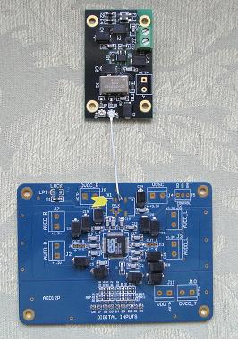

External Clock
External Clock is possible. See pic showing external Crystek 950 connected this way using a short length of coax. Tentlab or others can be done similarly.
Anybody has any feedback on Oscillators?
- external?
- onboard Chrystec or Tentlabs?
Crystek sounds pretty good.
Is Tentlab any better? Has anyone done tests to compare?
i wouldnt think it would be even as good. the standard clocks listed on the site dont appear to be that flash, support seems to be not great either atm from what ive read on here, but also there is no coax so connection would be a bit of a hack. all the same i do plan to do some comparisons once the IV is more stable and i know the system better. probably once ive got the new speakers up too
