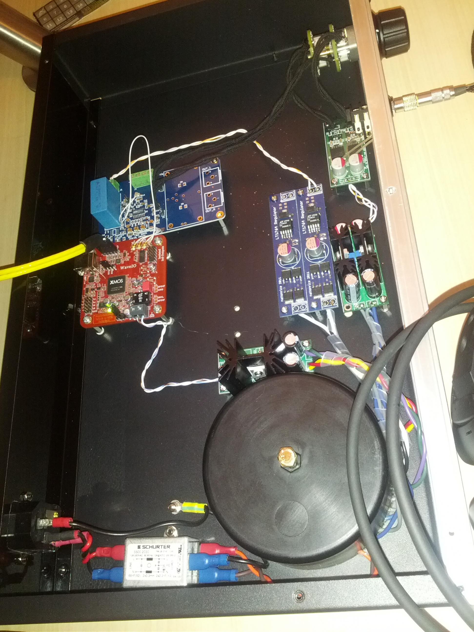

Just finished putting my AKD23P in a temporary case with a few other bits and pieces 🙂
Need a shorter u.fl cable for mclk, the ones for signal weren't long enough to reach the mclk, probably only short by ~10mm or so, next bigger size I had was a 200mm long monster.

I know those regulators =p
Is that one of qusp's octopus transformers or did you get one made?
Looks excellent!
I'm thinking of doing a similar thing and putting a small bal-se or bal-bal wire in my old sabre dac to turn it into a glorified soundcard.
Looks excellent!
Yeah I got a one off tx of my own made up by sumr, made one mistake and ended up with one of the secondaries being a bit higher than I'd like and the LT1085 I use for the WaveIO runs a bit hot even with the larger heatsink on it, not the end of the world and all runs at safe temps how it is. Considering I ordered the tx with a totally different DAC and without FIFO in mind it still turned out pretty much perfectly and will use all of the secondaries.
Yeah I thought you'd like those regs 😉 The extra LT1963 reg board will power FIFO later on and the other half of the seemingly half populated Wire PSU board is set up as another rectifier+filter and will probably power a sjostrom super reg for isolated side of the FIFO.
I grabbed a spare set of shoelaces from qusp for analogue signal wire too! 😀
Oh and the JG jfet buffer+filter for the dac output still to come yet too 🙂
I'll be taking this as it is to the Brisbane head-fi meet so hopefully will be able to compare to whatever others bring along to that, should be interesting! It has just taken the place of a usb powered 'open source usb interface' that had the same 9023 dac chip and I was using an O2 amp on the output. WaveIO->AKD23P->Wire are a fairly substantial improvement over that setup.

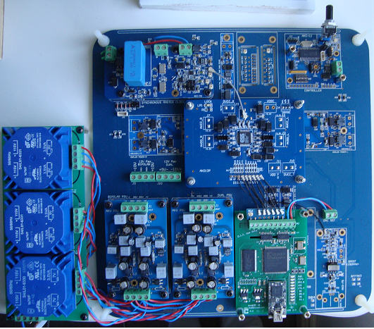

DAC Master Clock
I am not familiar with any of the asynch clocking options since I have never investigated them. Would be worth asking Acko about the 'Turbo Master Clock' though. I am not sure if it is able to work in asynch mode, its description has reference to modifications needed on transport end, which may or may not suit your application.
The AKD12P DAC module has provisions for an on-board XO or an external unit. I am leaning more towards the external one as it give options to experiment with different clock modules. Also, if the transport provides MCLK, this can be used and saves the cost of a dedicated Clock module.
As for the Turbo Clock, see how it is connected to the DAC as in the pic. The Master Clock output of the unit is connected directly to the DAC Master Clock input. There is no interaction with the EXA2UI transport at this stage, so in effect this is Async mode. Of course, you could just whack in a much cheaper clock module for this case.
The SQ of the setup is really good, so it goes to indicate that the NDK XOs and signal processing of the Turbo Clock are working well. I haven't done direct comparisons yet but based on memory, appears sounding better the Crystek types used previously with this DAC. So standard Async mode with low jitter XOs does sound very good. The other thing I have noted is that the DPLL BW of the DAC has to be at least Medium-High @192KHz and possibly Highest BW for 384KHz for stable lock.
Based on the above results, I am still undecided as to whether to go further and mod the EXA unit for synchronous operation. For this case, 2 slave clock outputs from the Turbo Clock goes into the Clock inputs of the EXA unit. The two on-board XOs need to come out. Then I have got to tap the embedded Fs signals of the EXA to switch the Turbo Clock accordingly. Fairly, intrusive process and may cause damage or void any warranty of this fairly expensive EXA unit, so treading carefully:scratch2:
Anyway, the benefits of going forward will be to get the DAC to lock at the lowest BW in the Synchronous mode. Plus DAC operating at 98.304MHz would make the jitter reduction even better compared to just using the simpler 24.576MHz MCLK directly from the EXA unit.
Also, the Master Clock from the Turbo unit is inverted w.r.t. the Slave Clocks to reduce noise further as indicated in one of the ESS App note, so all lined up!
Will all these translate to noticeable improvements?
Will find out soon ...

I was asking about the "akd16".
There are pads on the board marked "mlck", I was assuming they where
supposed to be populated by "the simpler 24.576MHz MCLK" or some
"semi high end solution".
Not at all if an external master clock is used. Maybe a misstake on my part or... ?
I will try to make a description of how I'm going to use these things.
The center of all functions will be the dsp filter that "Chapark" is working on
and at the I2S input I will have "Loriens" usb reciver. I will also be in need of
both digital and analog inputs of the dsp. If I'm not misstaken that will
disqualify the possibility to use the Wave IO as a masterclock, right? The
plan for outputs are to connect two stereo dacs to I2S and use ESS digital
volume control before sending this to four channels of John Broskie's "Unballancer".
People are giving the ess volumecontrol god reviews, I really hope that this is true.
I have also read somewhere that if syncronus mode failes it will be quite
nasty, so I'm leaning to asyncronus mode for now.
If I'm going for the "akd16" do I really have to get an external clock to get a
decent result? And if so, can I run both "akd16" on the same master as
asyncronus or will I need two external clocks?
