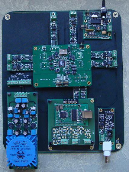

ackoDAC based on ES9018

I plan to build a 192/24 dac driven by async I2S usb interface soon. It seems as the es9012 ic is one of the best out there. As I want to use a tube I/V I fancily build I'm wondering what's the I/V resistor value range that the 9012 likes to see. Now I use 39R with the vintage Philips TDA1540 and TDA1541.

@crazyfrog: sure mate, but be aware that you will not be getting even close to the performance the dac is capable of. i've used sumR tx on the output of buffalo 2 with reasonable results, but the dac performs in voltage mode and not under ideal conditions for voltage ode either. discrete solid state IV works best imo. in the d1 thread owen did comprehensive tests and passive iv was by far the worst for measurements. of course numbers arent everything, but imo they sure are something. especially when going to the trouble of using all these power supplies and tweaks on the ackodac, best to try to eek more than under 100db out of it

I do not know how Lundahl would perform with Sabre, but on AK4396 works like a charm. It doesn't measure like an opamp attached to the DAC, but it sounds much better than any opamp. Do you know what is the minimum impedance Sabre DAC allows?
Lundahl plus jFet buffer works even better. After I made buffers after Lundahl transformers, I got much better performance.

exactly what i' saying, you should use something before the trannies to do iv, but not resistor, a simple differential jfet pair or something that can float its input above ground and present a low impedance. i believe the tx should be last, after the jfets and act as a buffer itself. impedance of the following stage should be as low as possible to maintain current mode, but if you accept that you will use voltage mode it should be higher than 200R or so per leg

i have used budP's onetics (not sumR as i wrote above, richard makes my power transformers, doesnt make signal tx) and they are very well suited, but no matter what type of transformer, it still is about the worst thing the dac could see at its output, inductive, high impedance. sound is quite good, easy on the ear, but lacking some dynamics and low level detail. i also have salas shunts, but only really have room for one for vosc in my build and its gone now due to already having plenty of heat sources in my dac. I'm using a lifepo4 battery instead, even cheaper/better. with heatsinks taken into account and the larger transformers, salas shunts are not as cheap as you make out, also with the amount of different supply voltages needed for this dac; all shunts will take up a lot of room
