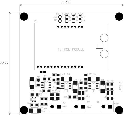

USB DAC
See preview of possible combinations:
1. AKD24 - USB Audio module, HIFace + on-board LN regs + I2S outputs. Premium version will have galvanic isolation
2. AKD20 - DAC only based on 9022 with Crystek 80MHz on-board. External power. SE output
3. AKD22 (not shown) - Combines both 24 and 22 types on a single board
Yes, board is exposed and you connect signals and mod to suit.
Actual board (AKD24) due early next week. Will post pics
Hope this helps.

cool. thanks for the pics and details and nice to see there is a lot of options. as i said earlier, i would be in for a akd-24 and akd-20(if akd-20 is not too pricey..) but i would not want to wait too long though, so i might just go with the akd-22. Hope there will be interest but judging from inexistant impressions or build reports of your offerings, i m a bit skeptical.
