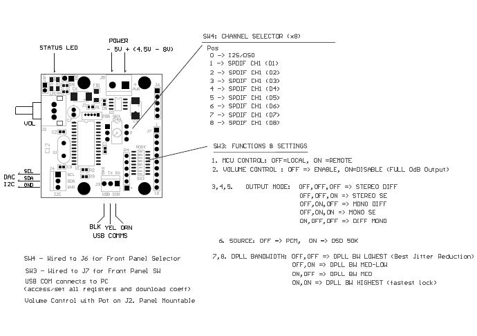

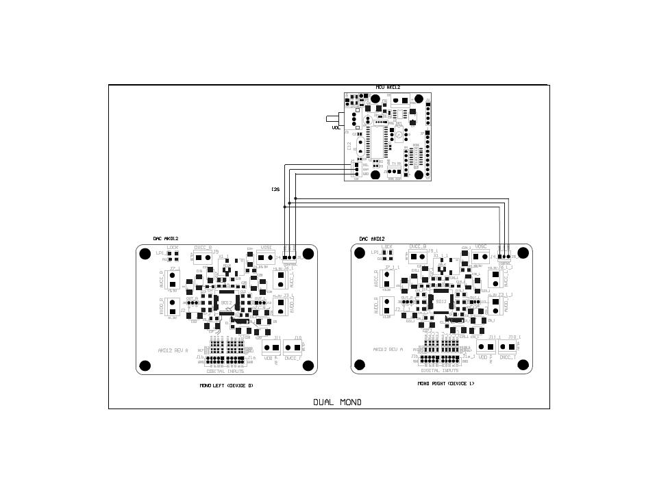

MCU
Hi All,
The DAC MCU is finally ready, a whole project by itself! See preview for setup. It can control the DAC using on-board switches or connect to PC (comms) for enhanced control. Low level (i2C) register programming allows access to any of the exposed register as in the datasheet. Also included is easy to use high level functions that can control most of the DAC operation without the need for any register information. Settings can be dowloaded to NV memory of MCU and use these instead of switches. Up to 2 DACs can be controlled (dual mono) and can be used with ES9012, ES9018(stereo) and ES9016 (stereo) chips
Those who have pre-ordered the MCUs, these have all been shipped and thank you for your patience. For those who wish to order, there is a new batch in production and will be ready in ~2wks.
This project will now move onto 8 CH version and various IV stages to match.
Regards, Acko

yes, the MCU is quite impressive and worth the wait. most definitely the most sophisticated control of a DIY dac project that I have seen and I can certainly see where the time went. kudos to you acko, many have talked about this level of control before, but it never seems to become reality.
