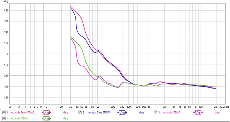

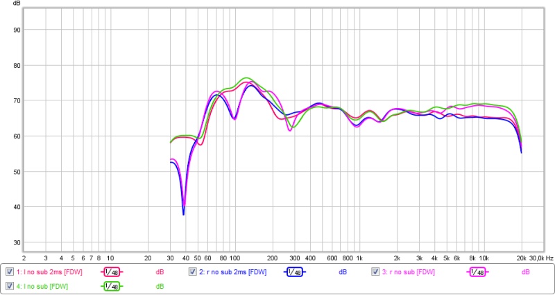

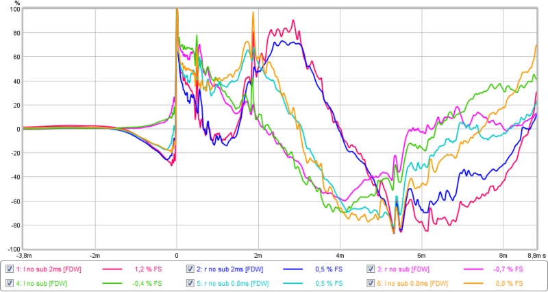

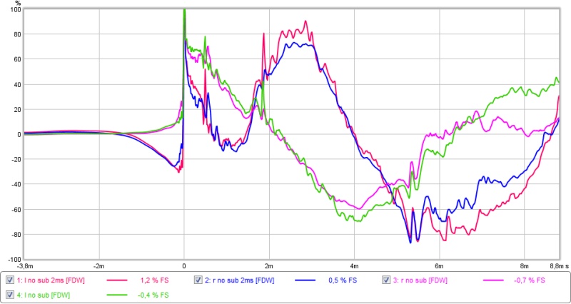

So measurements at LP with 2ms less delay on mid-tweet.
SPL
Phase
STEP
Phase and step don't look so good in comparison.

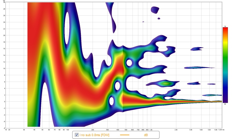

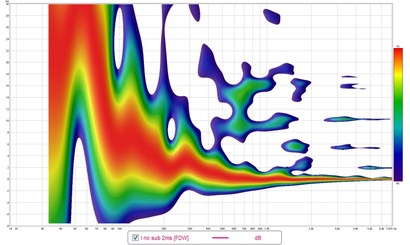

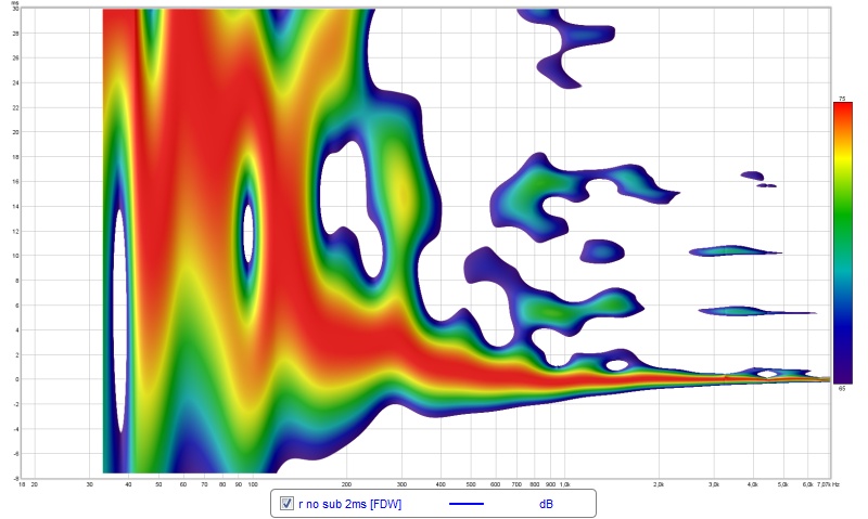

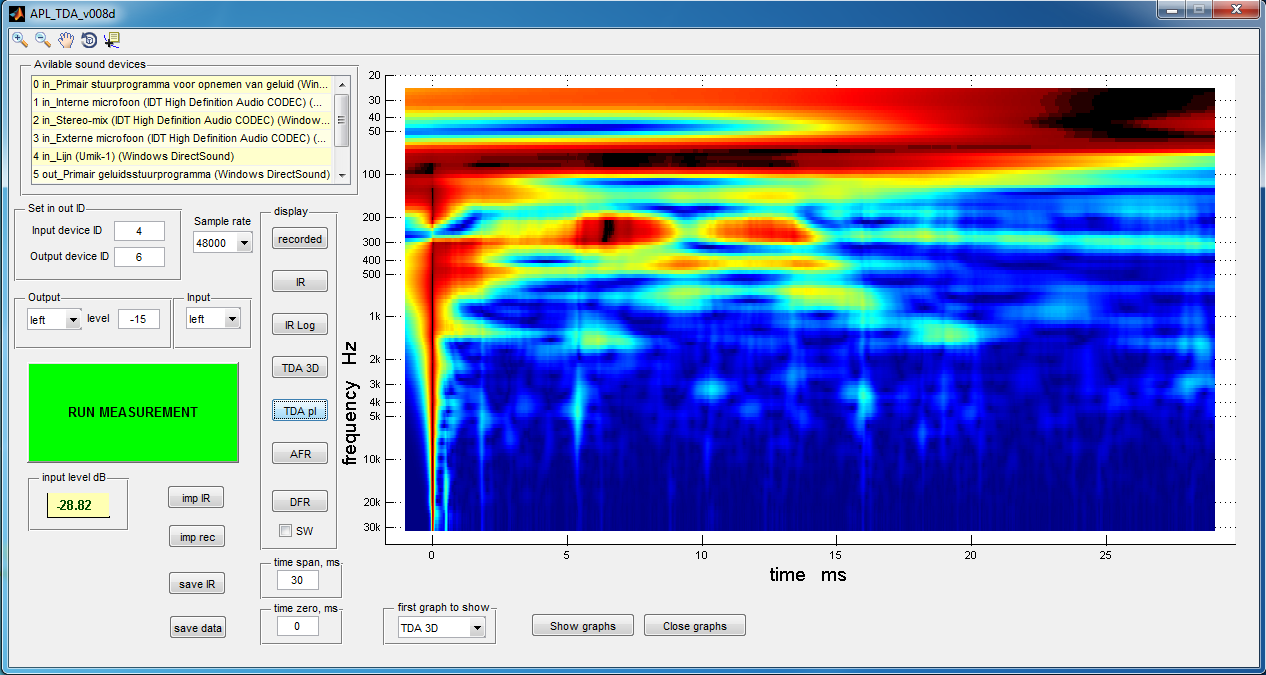

And the new wavelets without sub
left
right
SPL
Phase
STEP
left
right

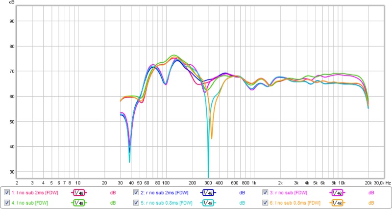

You're right, this delay isn't the answer. Judging the phase response without it all it needs is a tiny bit of help straightening out that phase bump, without an overall delay change.
Or... you could try 1 ms less, which should bring you somewhere in the middle. It did remove more of that dip. (slightly less than one ms seems to be needed).

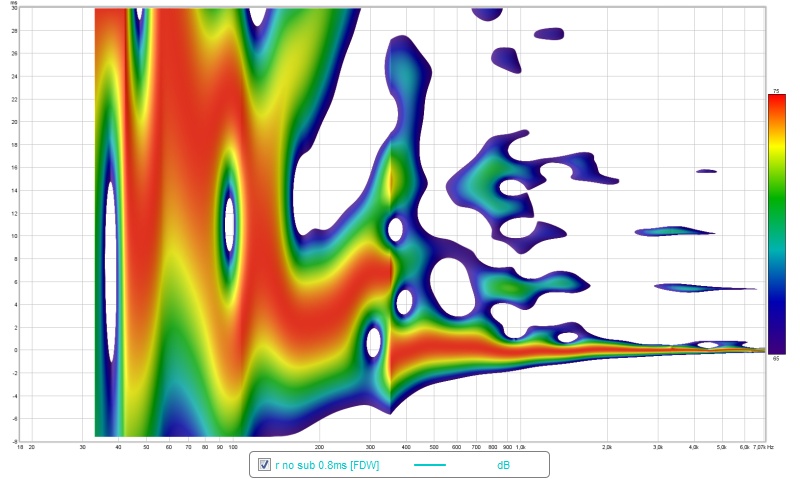

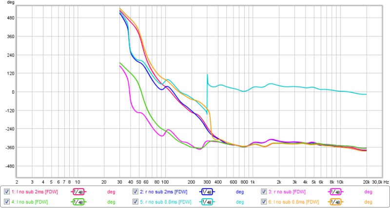

Measurements with 0.8ms less delay on mid tweet.
left
right
This also doesn't seem to do the trick (or something went wrong with the measurements, it looks really weird). I have to start cleaning up before my GF gets home so no more measurements for today. I'm going to think a bit about all these results, no way I understand the total implications of it all at the moment.
left
right

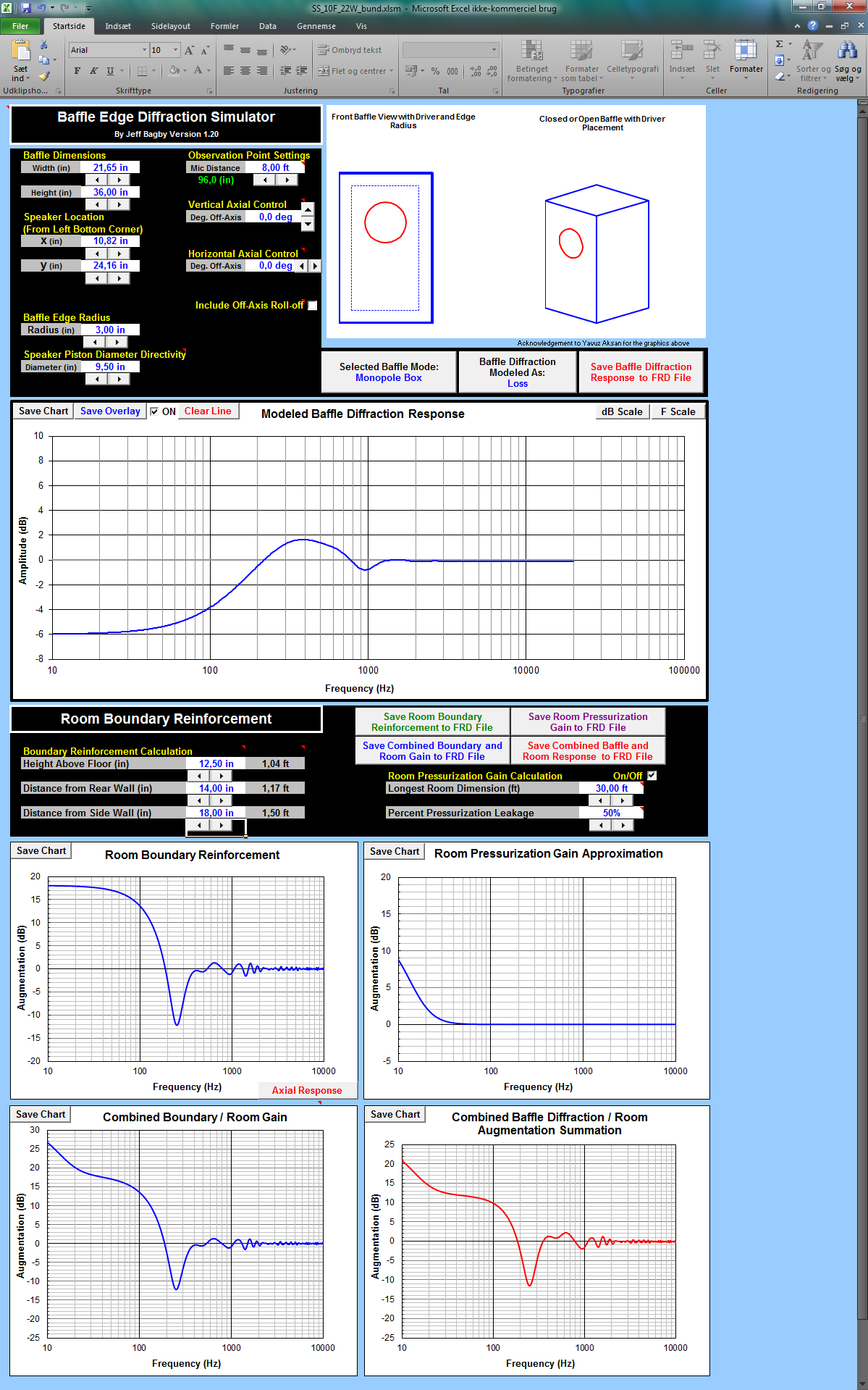

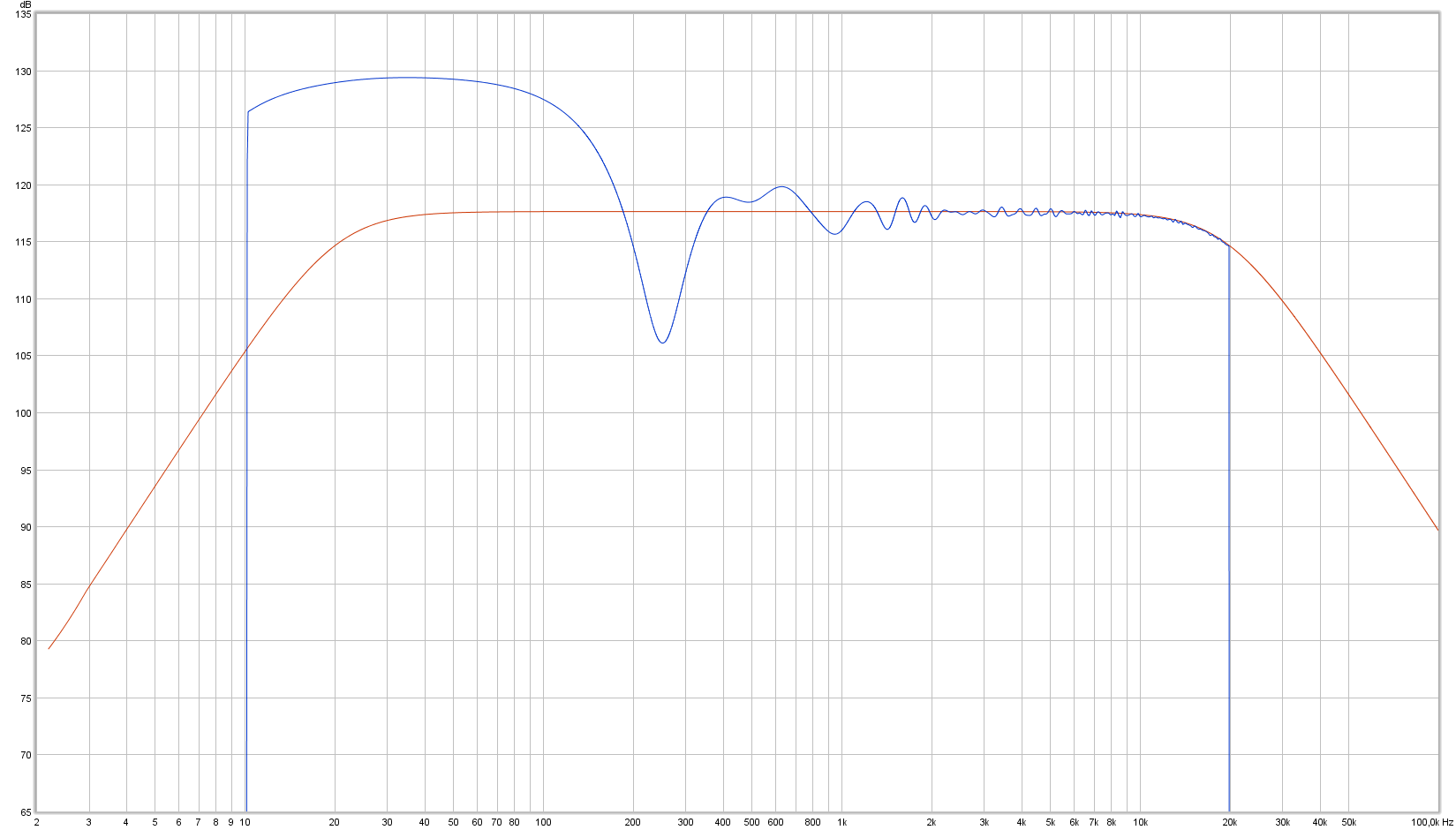

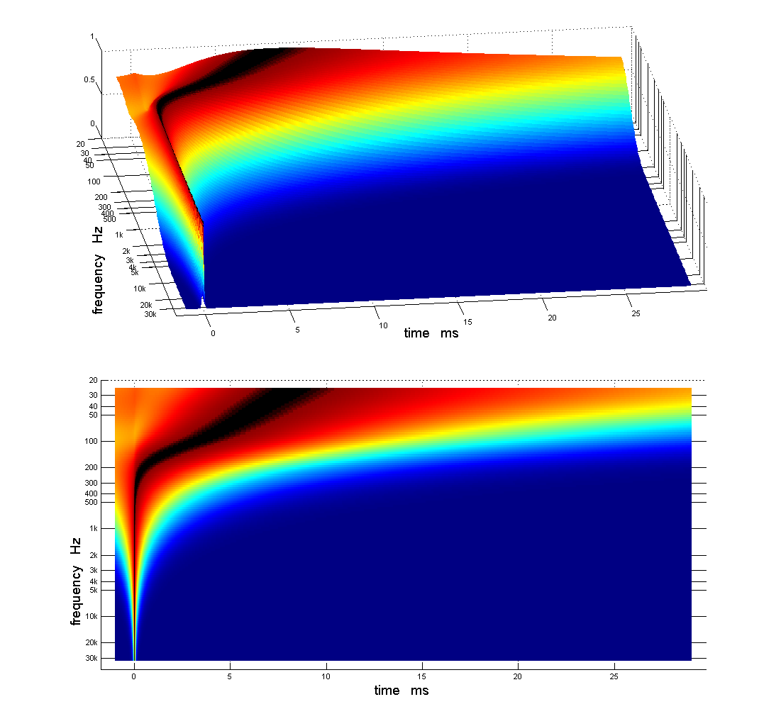

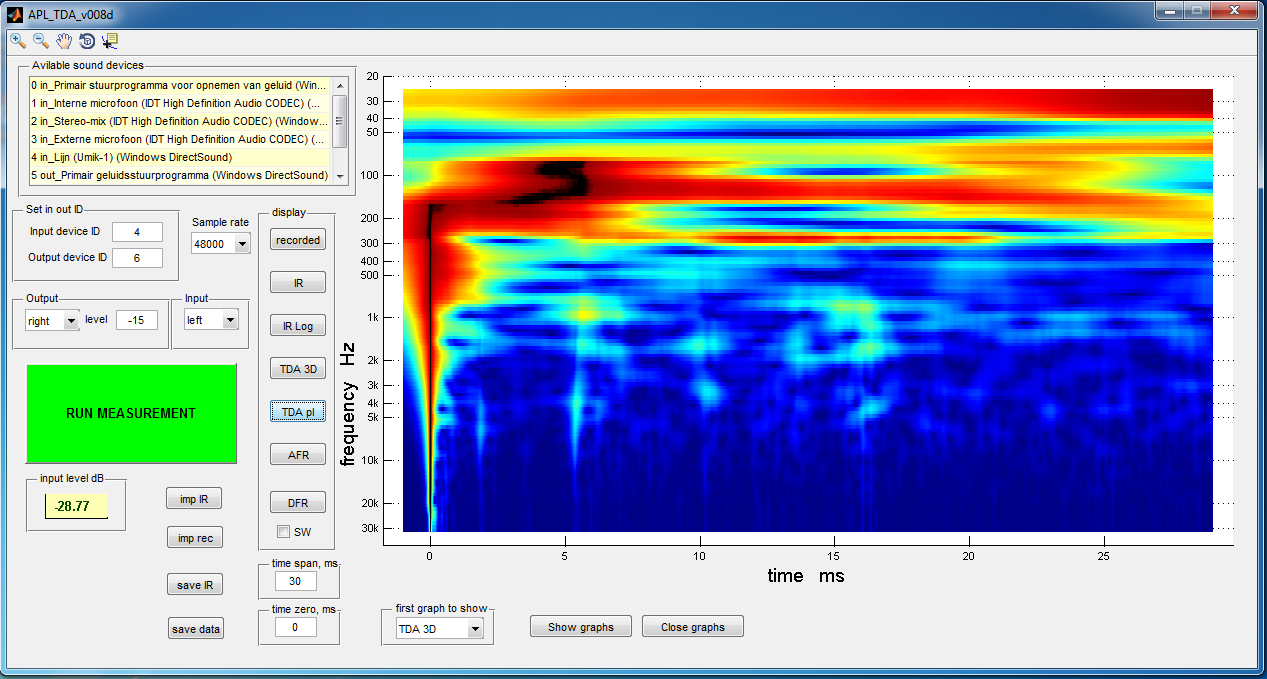

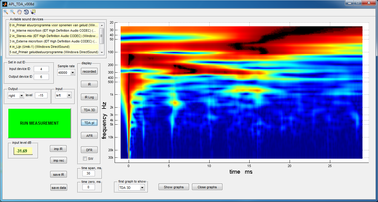

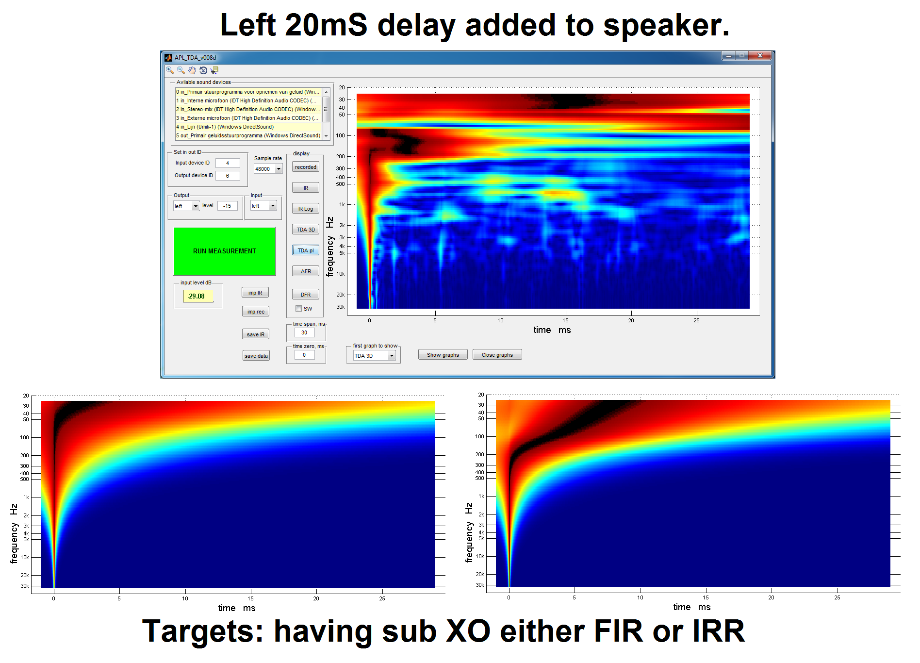

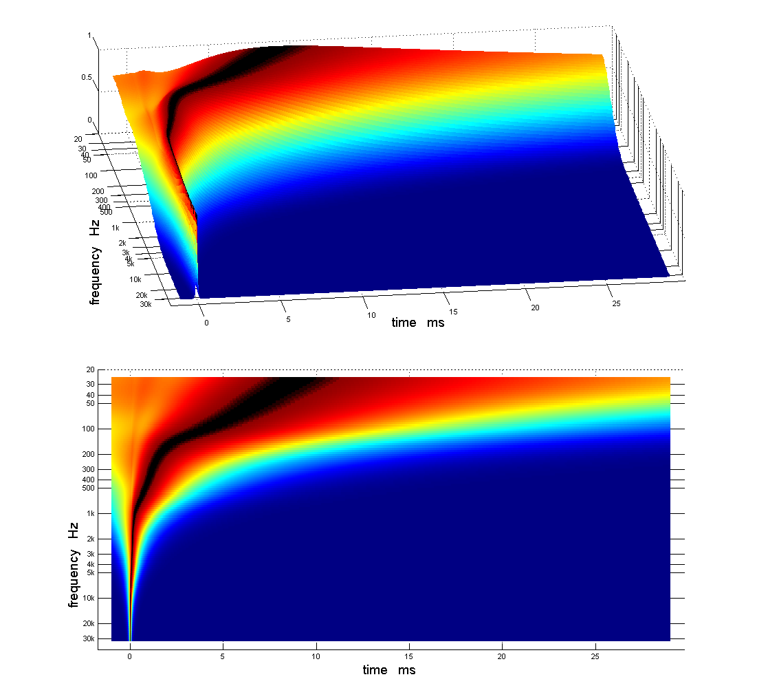

Would be curious if example Jeff Bagsby tool below can predict and confirm whats going on or maybe use room simulation menu in REW, below settings is pure guesswork regarding dimensions but as seen in REW plot room does move mountains to a perfect flat 20Hz-20kHz bandpass at listening position.

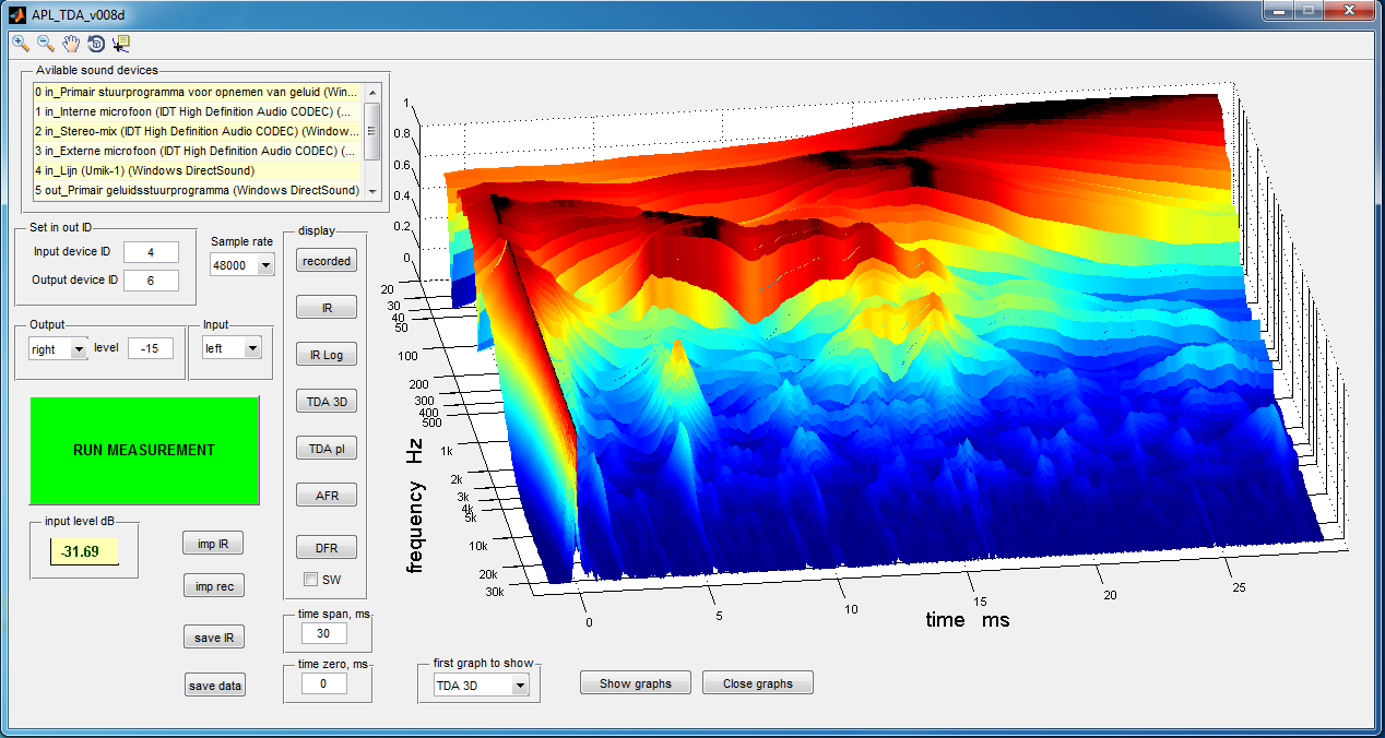

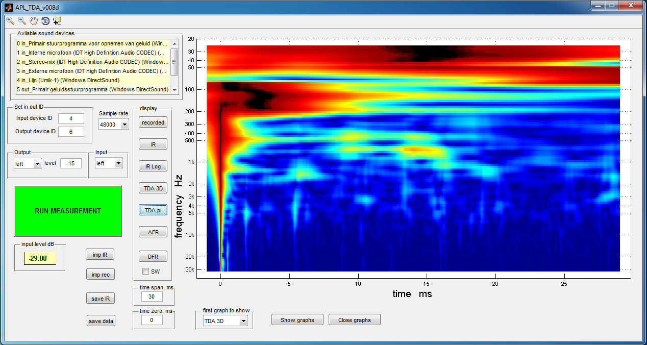

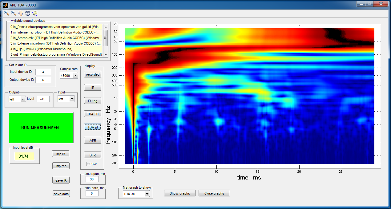

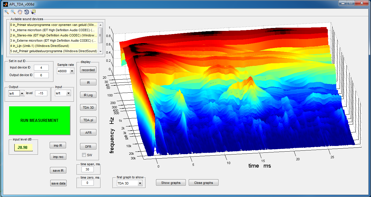

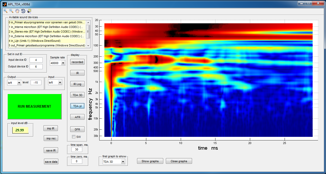

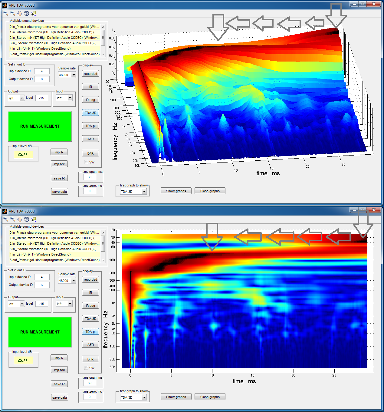

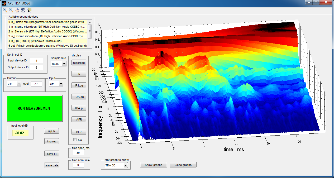

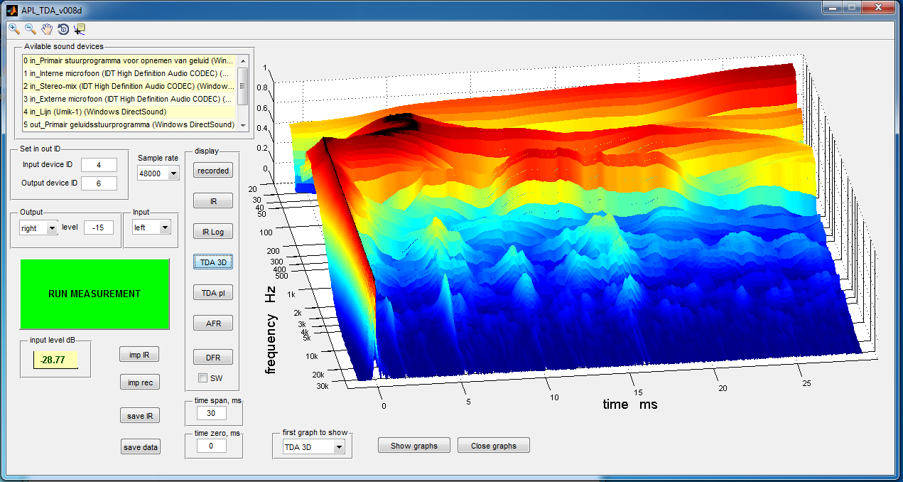

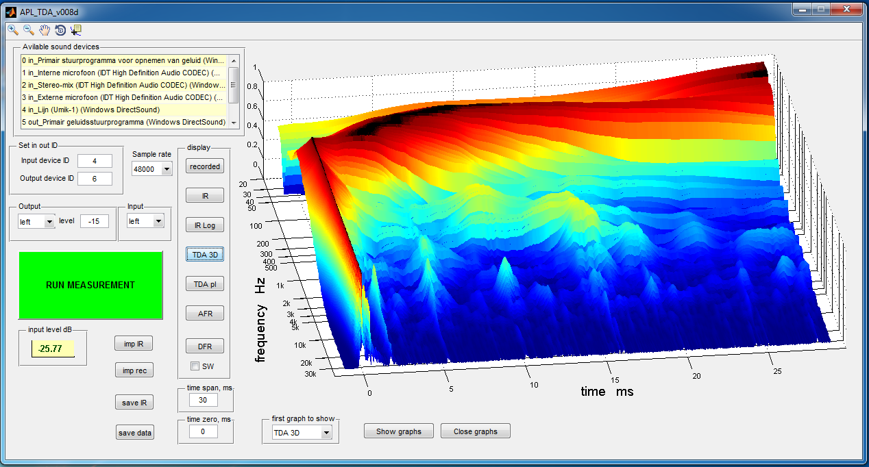

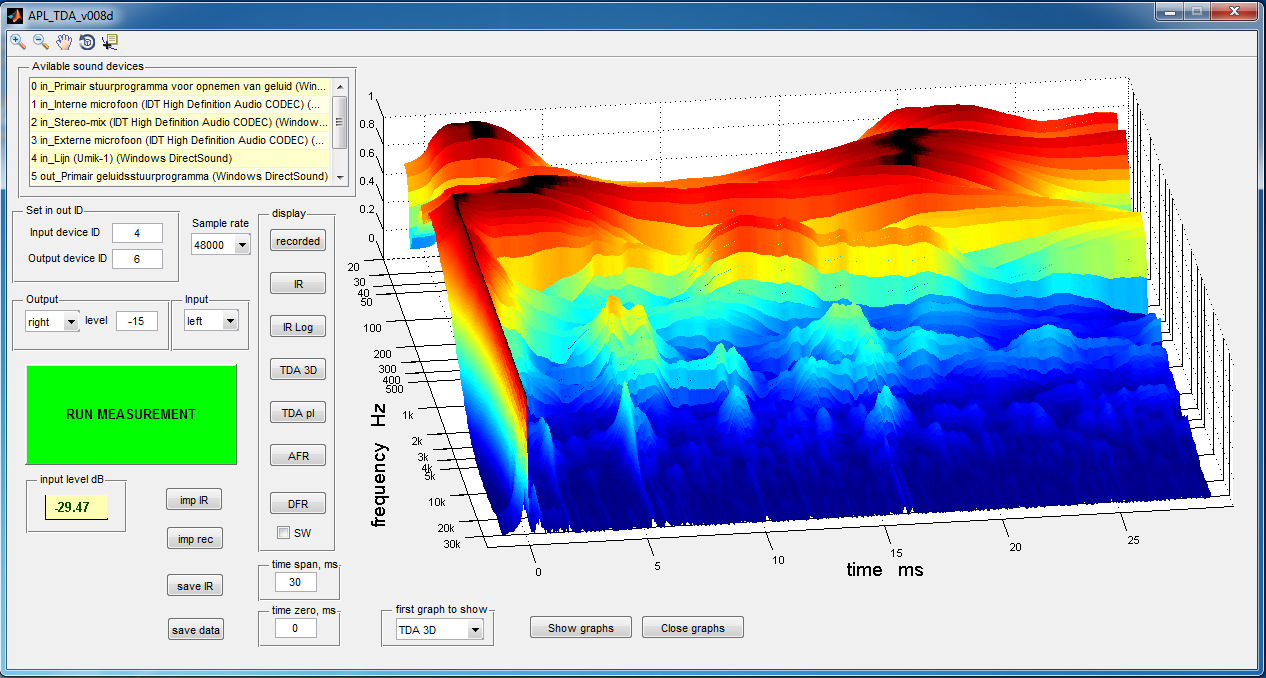

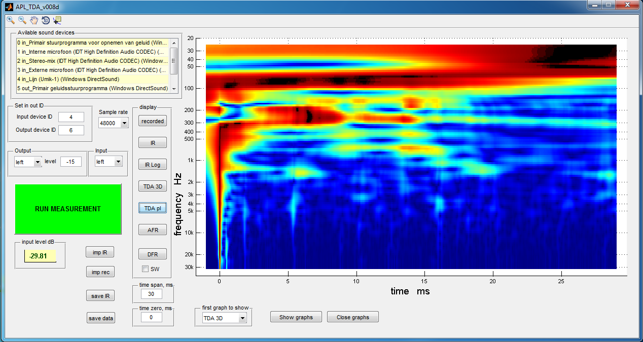

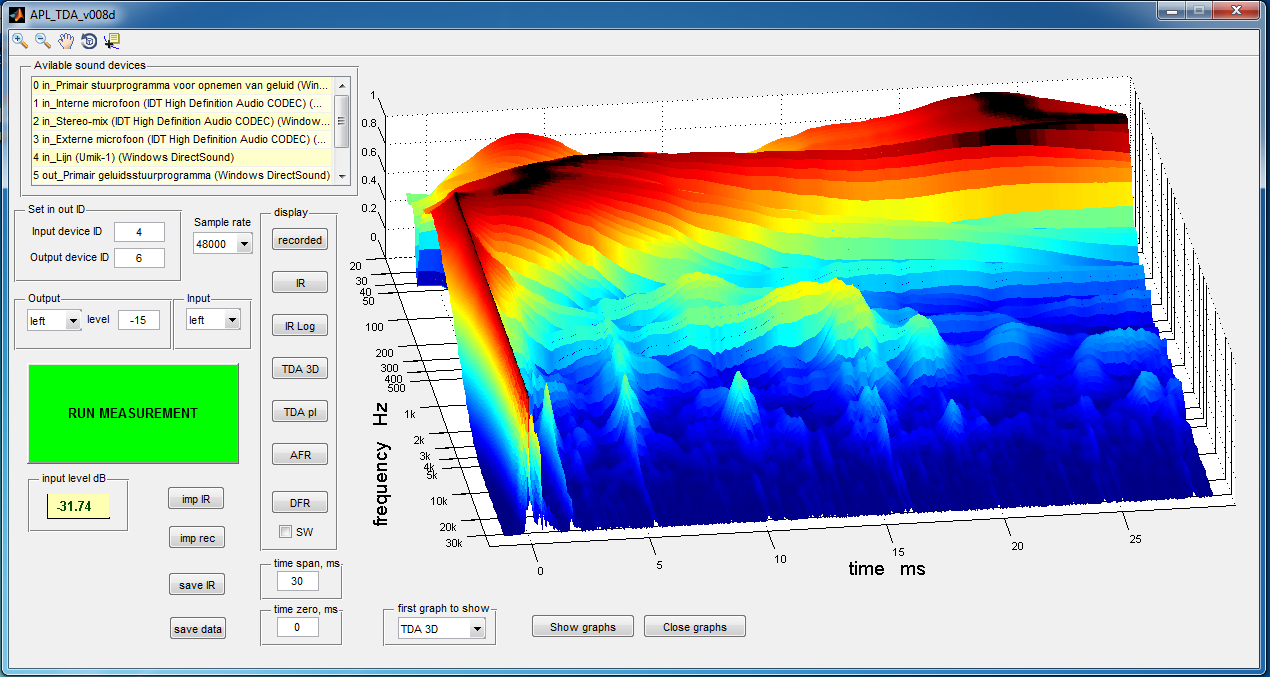

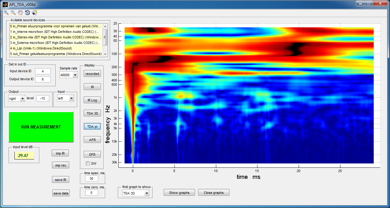

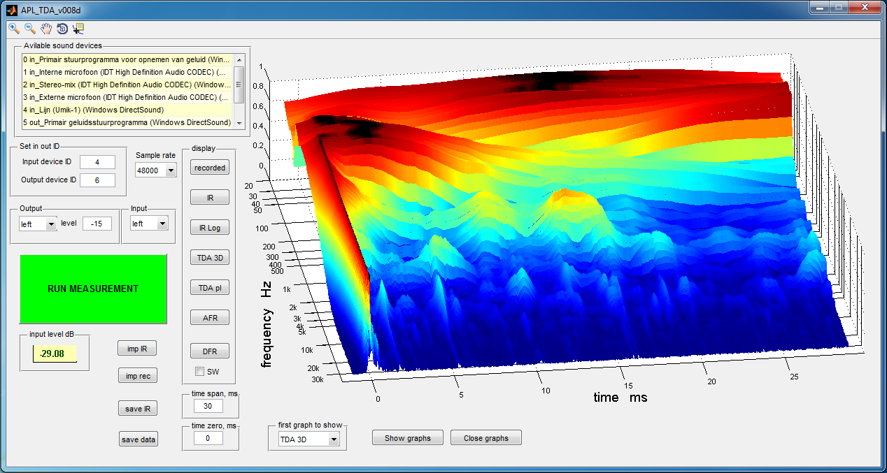

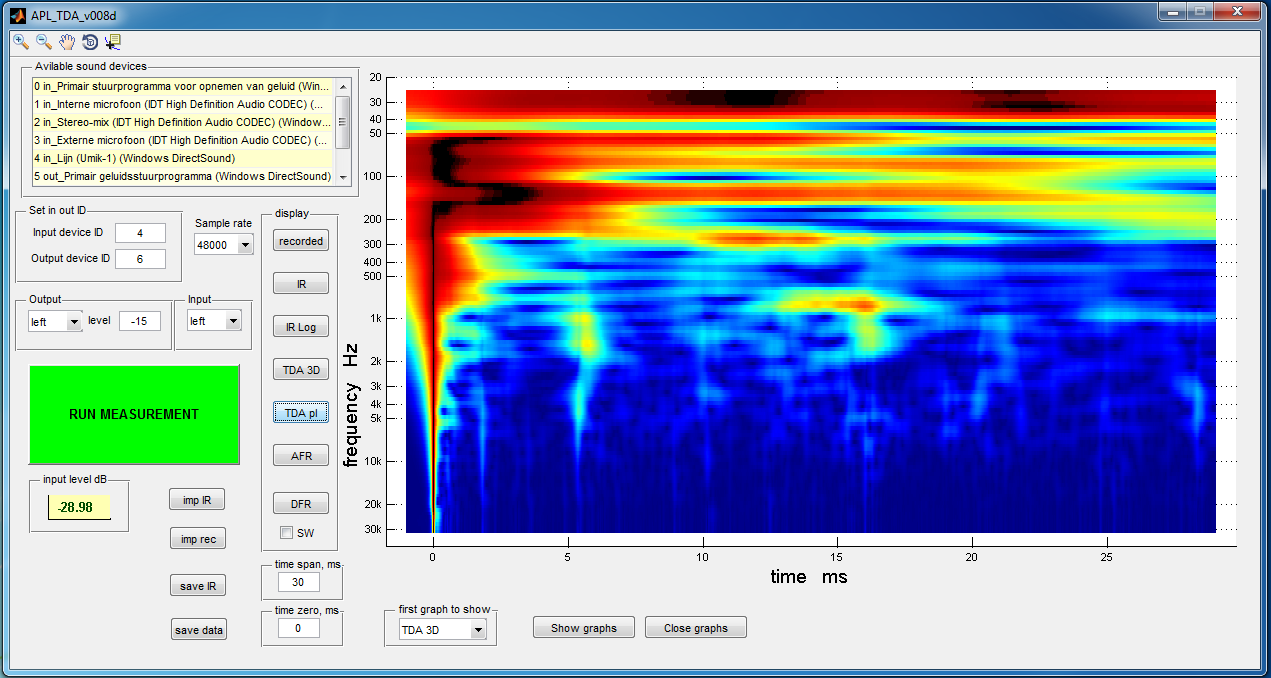

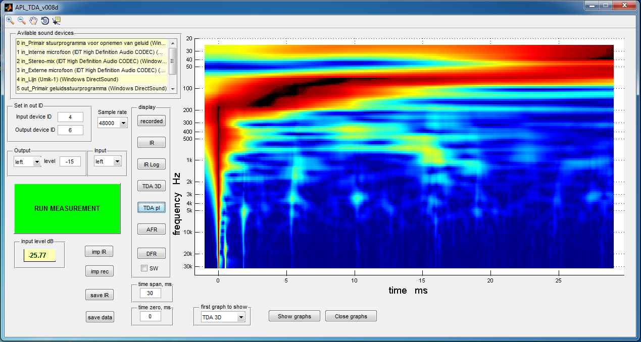

So I got APL_TDA working on the laptop but since I can't save files with the demo I'm gonna need some specific requests for graphs you'd like to see.
@ BYRTT the tool doesn't work with open versions of office and I don't have excell. I'll take a look at the REW room thingy.

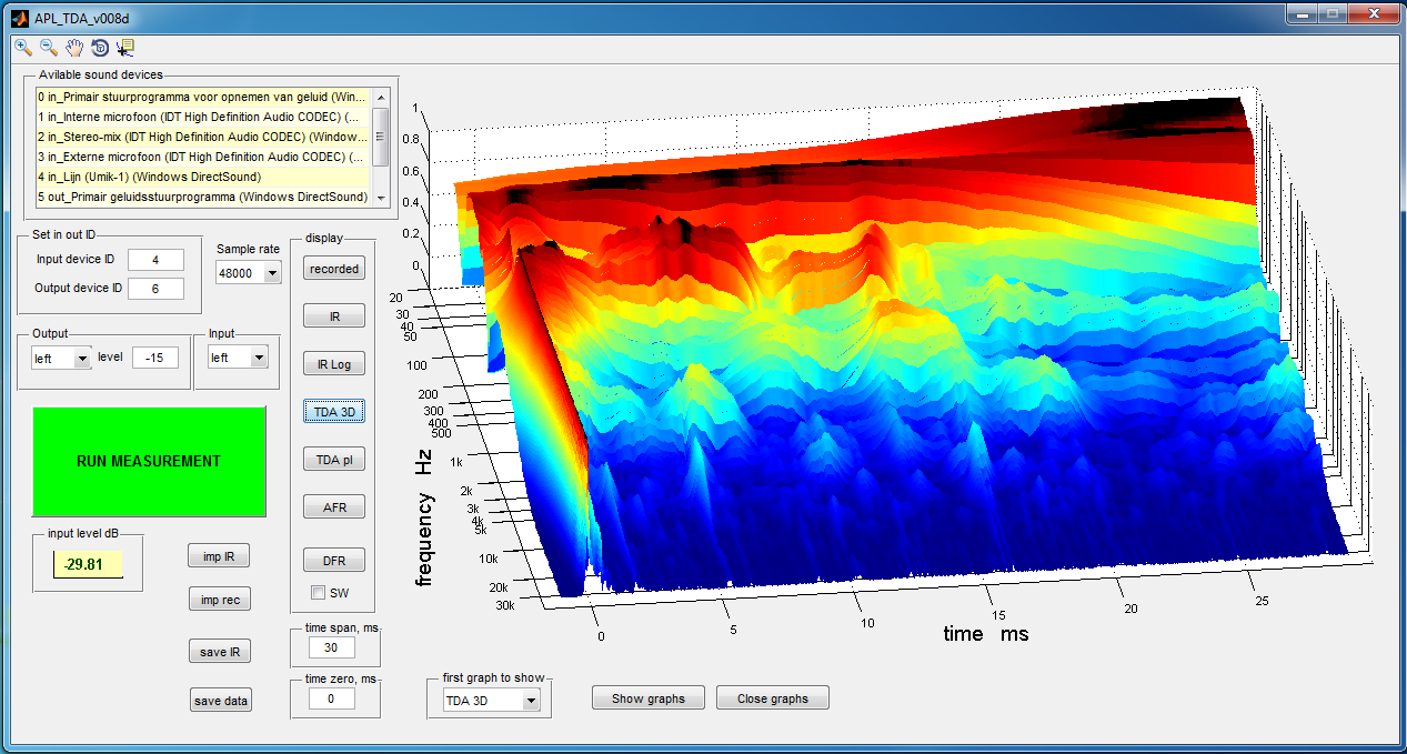

In APL_TDA plots are at listening position think they look relative good, another thing is does APL_TDA show clean response and timing if you hardwire loop your system boxes. Looks like room collapse ala brickwall below about 180Hz so subs will never have a chance to integrate good.
Know you have FIR power but not sure if taps available at all XO points and it makes a difference how plots suppose to look. First below is (targetcurves) perfect IR example of FIR XO points all the ways for IRR pass-band domain 15Hz-22kHz. Second is same but with one IRR 4th order 50Hz subwoofer XO point, and third is IRR 4th order XO points all over 50hz/300Hz/2500Hz.
Well, seeing the response at 300 Hz, where there used to be a dip, it looks pretty controlled there. The question is, is this a trade off from having the bass bin upside down or are we looking at some previous crossover/FIR action not working for this new way of arranging things.
That's hard to know for us, as we don't know what the crossover is exactly. All we do know is the geometry that was corrected at close distance changes when looking at it from a larger distance plus the fact that one driver has moved way further down.
Was the crossover a named one, plus FIR correction? Or was it based on acoustical measurement using whatever needed to follow a named curve. Was it corrected to follow linear phase in RePhase?

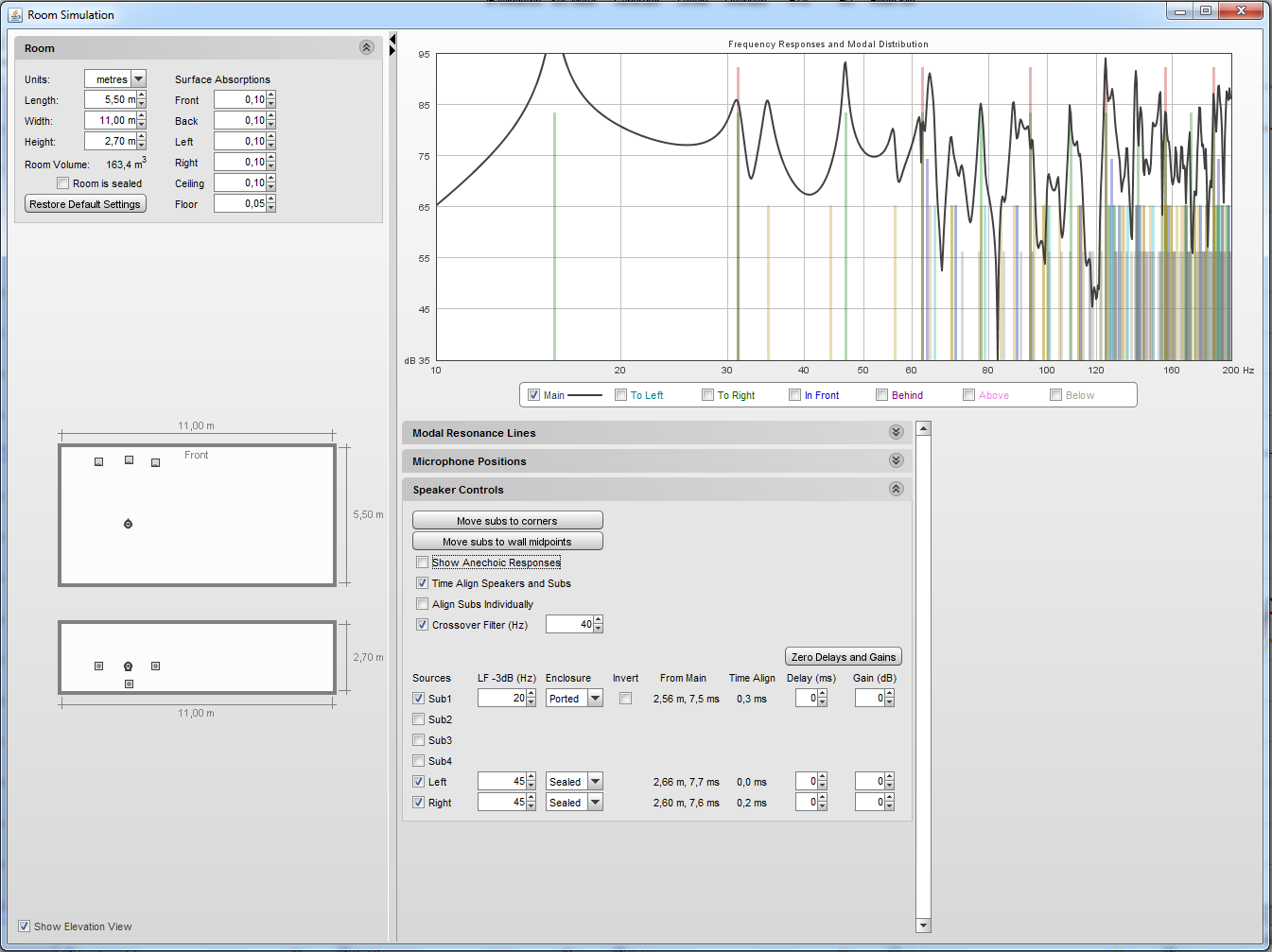

I played around with the REW room mode simulator.
Doesn't seem to be very usefull for what I'm trying to do.
dauumn large room, at least for me!
i would move speakers to short wall

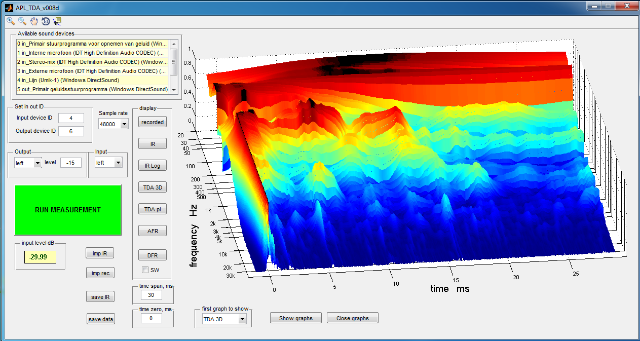

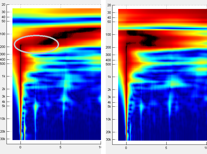

This marked suddenly time change, at right is the one from today with midwoof baffle flipped back to normal position.
.....Measurements with about 20ms delay added to the speakers, 4,2ms less on sub and 15ms added to speakers.....
Have a look first attachment, think it looks better and better now if you bring sub even more forward so it touch the U from midwoof and we should start to see something ala one of the two targets.
Will have a look later onto your Rephase file, thought is real world acoustic slopes and correction for 9,5 inch midwood is not right probably because it so hard to get a good measurement as base for correction in this frq area.
