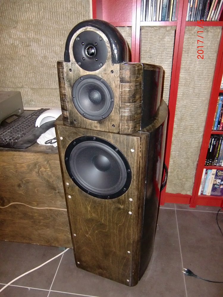

It's been a long time since posting but I finally got my brand new 9.5" satori woofers in a nice new baffle 🙂
The big dip is ceiling bounce, looking pretty sweet.
Distortion measurements and polar measurements coming up.
Subjective impressions:
It definitely sounds cleaner when you turn it up and to my surprise, the integration with the sub is awesome now. I never really got it to sound very good with the 4-way. But for some reason (investigations are underway) it just sounds much better with the sub now. The Denon avr3806 is still doing the crossover with the exact same settings.

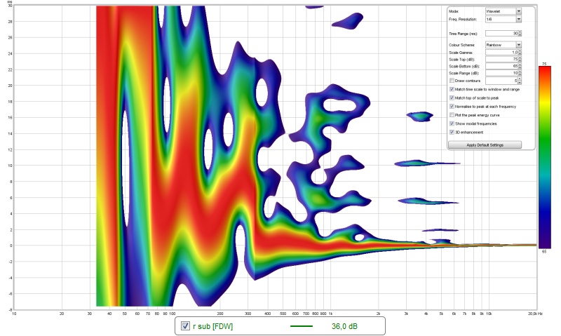

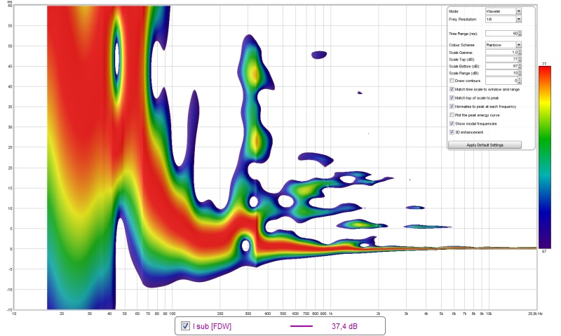

The way I look at it you have two options. One with woofer up like this, the other with the woofer low by the floor.
Would that move where the ceiling dip is? It would help if you don't have that dip right there, as it is right in the middle of the kick on the drum.
If you're worried about quarter wave distance to the mid, figure out the distance to your ears. Below the frequency where the room takes over I'd look at where it does it's job better, while still maintaining phase relationship.
Earlier you posted some wavelets, try and set scale range to a much lower number to really see the room. Set the time range to something just long enough to see output where you want it, go up and down with it to figure out what's happening. Is the complete wave front delayed or are you seeing circular shapes form in the middle of that wavelet to indicate a reflection.
To show what I mean I'll post my wavelet showing both problems:
Do you see the upside down "U" shape at ~130 Hz? That's where the wave is just slow to start. No reflection, just geometry of my particular arrays. The impedance peak is right there and it even coincides with my baffle length. 2 reasons for it to be slow on build up. The one at 70 Hz is a room anomaly. Meaning it isn't there for the start of the wave front. It builds up over time.
After I corrected phase for only the slow building wave front at 130 Hz, I get this:
I still have the room anomaly, but by curing the slow build up at 130 Hz, it's much less severe. There's still a dip there at 70 Hz but I can't fix it without bigger measures. I bring it down some more in the PEQ, and raise the other side slightly (only a few dB each) In a stereo measurement this makes it even, without too much energy stolen. The left side will ring a bit longer, as I didn't really fix it. That makes it not show up in 500 ms windows, only in the early frequency dependent window of about 6 cycles. Before the fix, there was no hole at 130 HZ, just a weird phase bump.
The wavelet is set to (only) 10 dB scale range. This is so I can see it grow when flipping trough the Time range. (works on the Spectogram type of plot as well, maybe even clearer to see) I have it set to "Normalise peak at each frequency" as I want to see the wave front build up.
Hope this helps.
This is how I try and learn what my wave front is doing, and what is caused by the room.

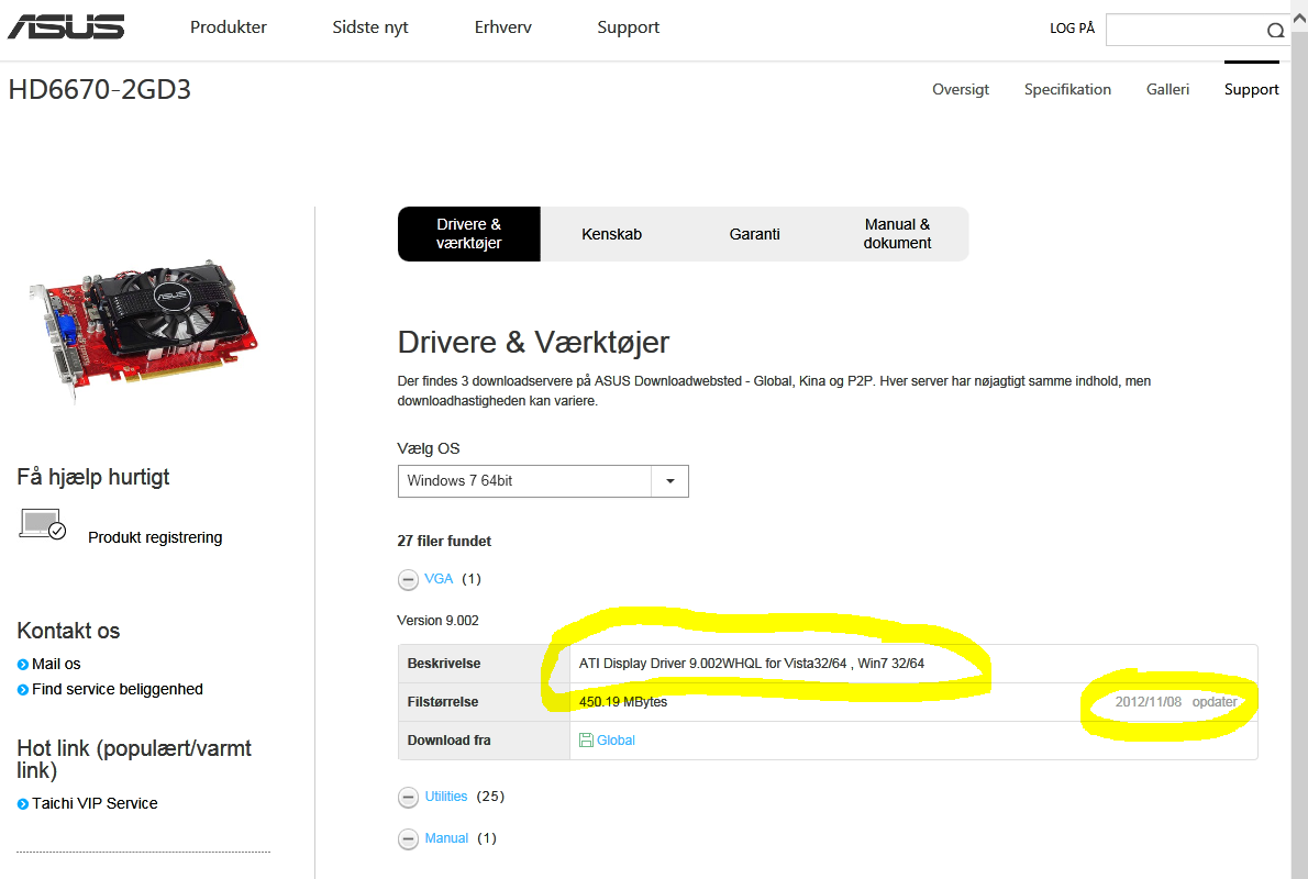

Had a SAPPHIRE HD6870 back in 2011 but then went Nvidia way but if you want i can look in old backups to find AMD drivers for Win7 64bit.
Did some small research and see below if you go to ASUS support you can find year 2012 v9.002 and year 2013 v12.101.2 and v13.152, but there's much more if you try the different models.

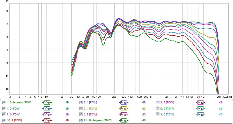

And the polars
These were taken by moving the mic (and 50cm high pile of blankets) around the speaker in the room, no values for measurements between 0 and 90 degrees because I just eyeballed the position of the mic (but height and distance were always measured to be exactly the same 98cm high 1m distance.)
I did get rid of the echo via hdmi but bumped into the same problem I've always had. Huge dips and peaks in the respons. I'll do some more stuff tomorrow, now I'm pretty beat.
Looks vey nice! Those peaks and dips are just reflections from boundaries, don't worry. If you change measuring distance they will move (not below 100Hz which are room modes). If you meassure at 0.5m they minimize but bass response is not real then.

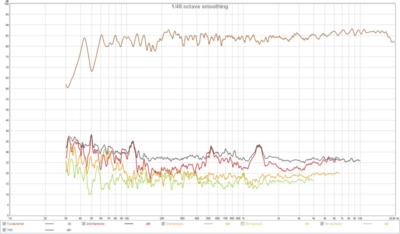

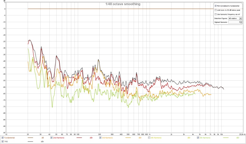

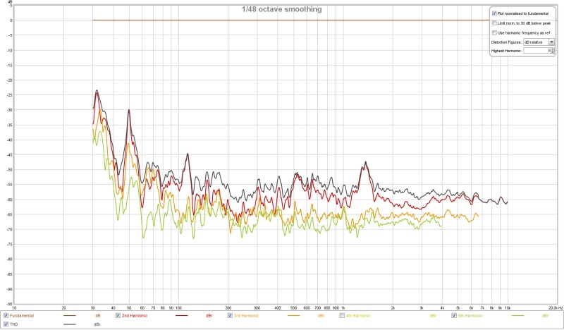

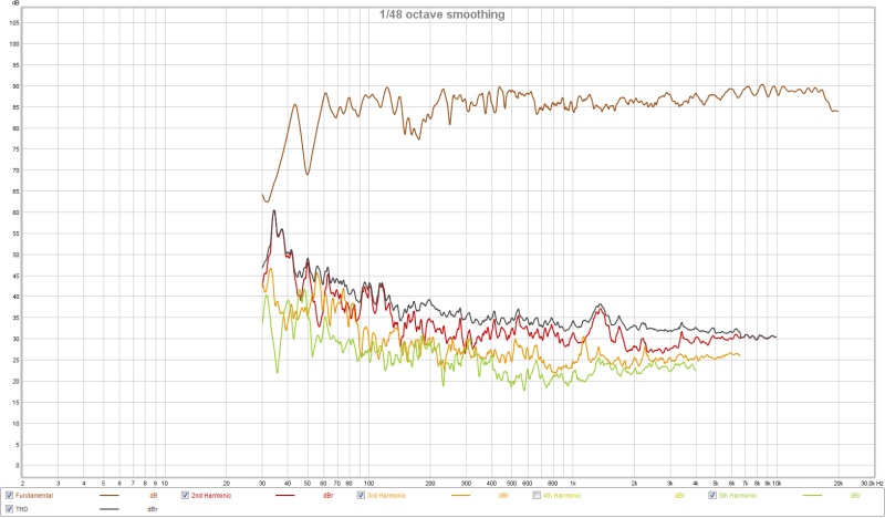

First, a decent distortion comparison. I reran the measurements for the new 3-way properly, made sure the room is quiet, take multiple sweeps, etc.
Satori 3-way
SS 4-way

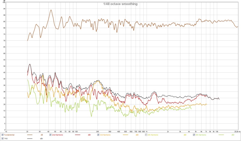

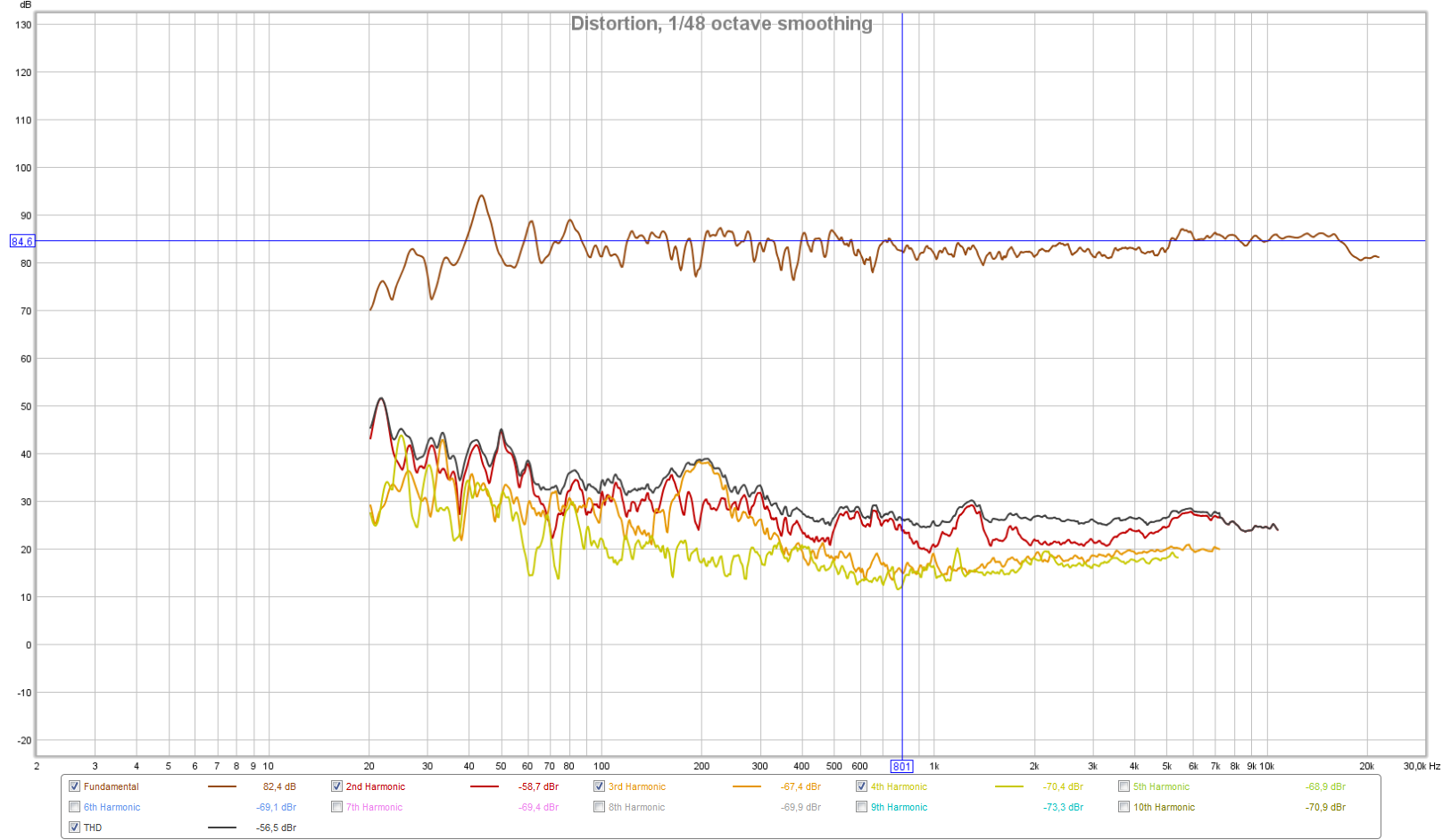

Normalized to fundamental shows the improvement better:
Satori 3-way
Better then -50dB over almost it's entire bandwidth (especially since I cross to the sub at 40Hz)
SS 4-way
Satori 3-way

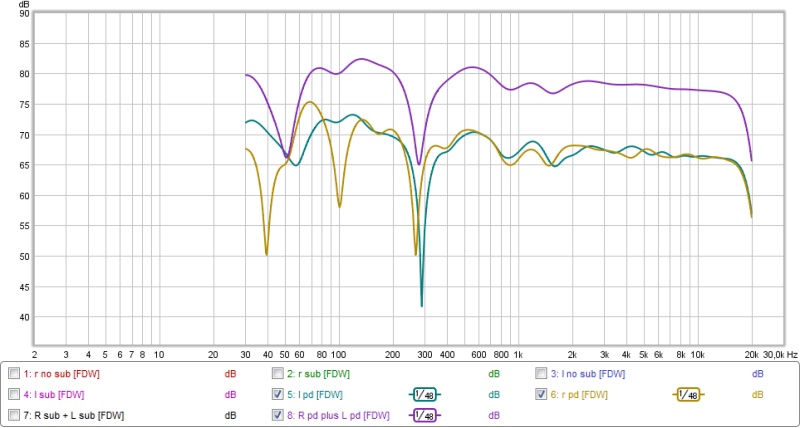

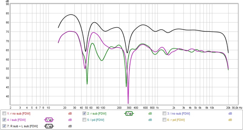

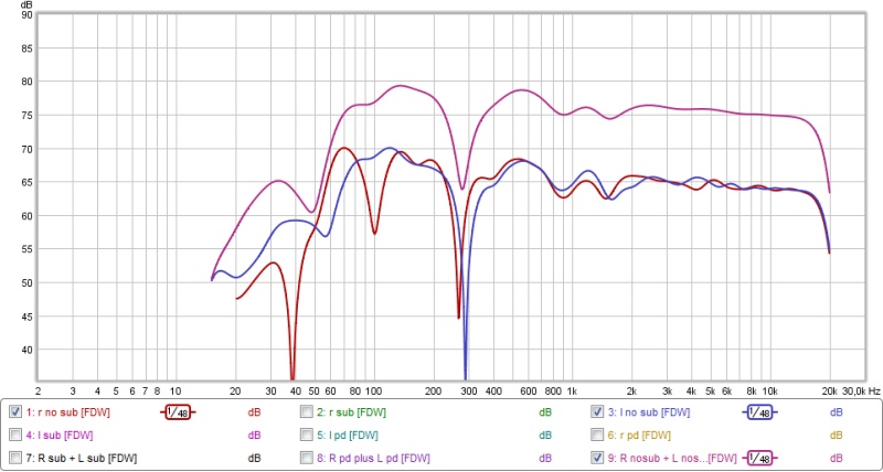

Some listening position measurements, I added +5dB to the sum to make it easier to see.
With sub
So big dip at 50Hz and 300Hz, small dip at 110Hz
Crossover @ 40Hz no sub
Speakers run full range

With sub

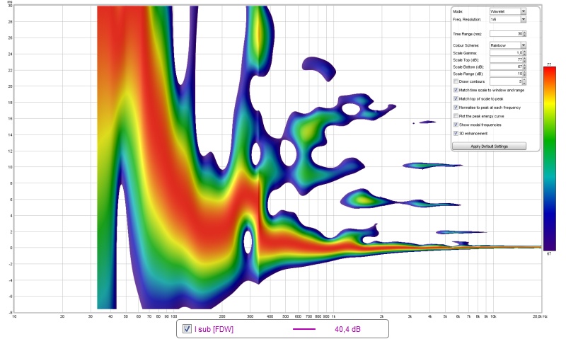

And some wavelets for the measurements with sub.
For the first ones I tried to mimic Wesayso's wavelet settings:
left
right
And expanded to 60ms in order to lower the frequency.
left
right
Both the 50Hz and 300Hz dip return in the wavelets as an upside down U. The 300Hz I could fix in Najda I think but I don't have the taps available to mess with 50Hz. 100Hz dip is only present in the right speaker I'd have to play around with rephase to see if that is fixable within 1023 taps.

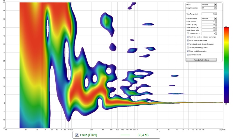

left
right

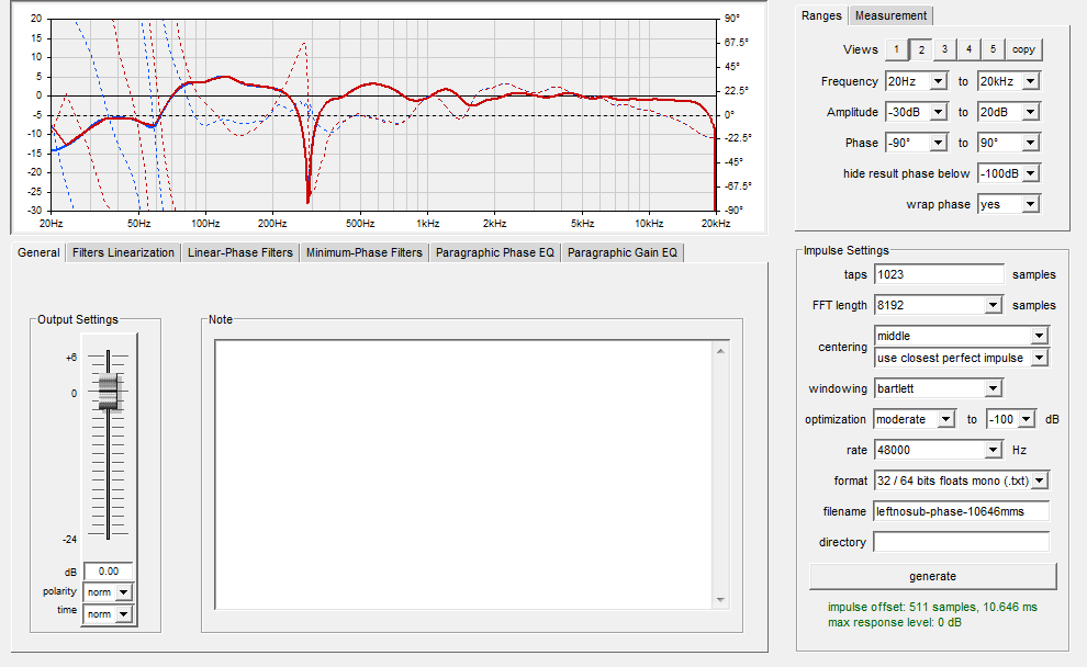

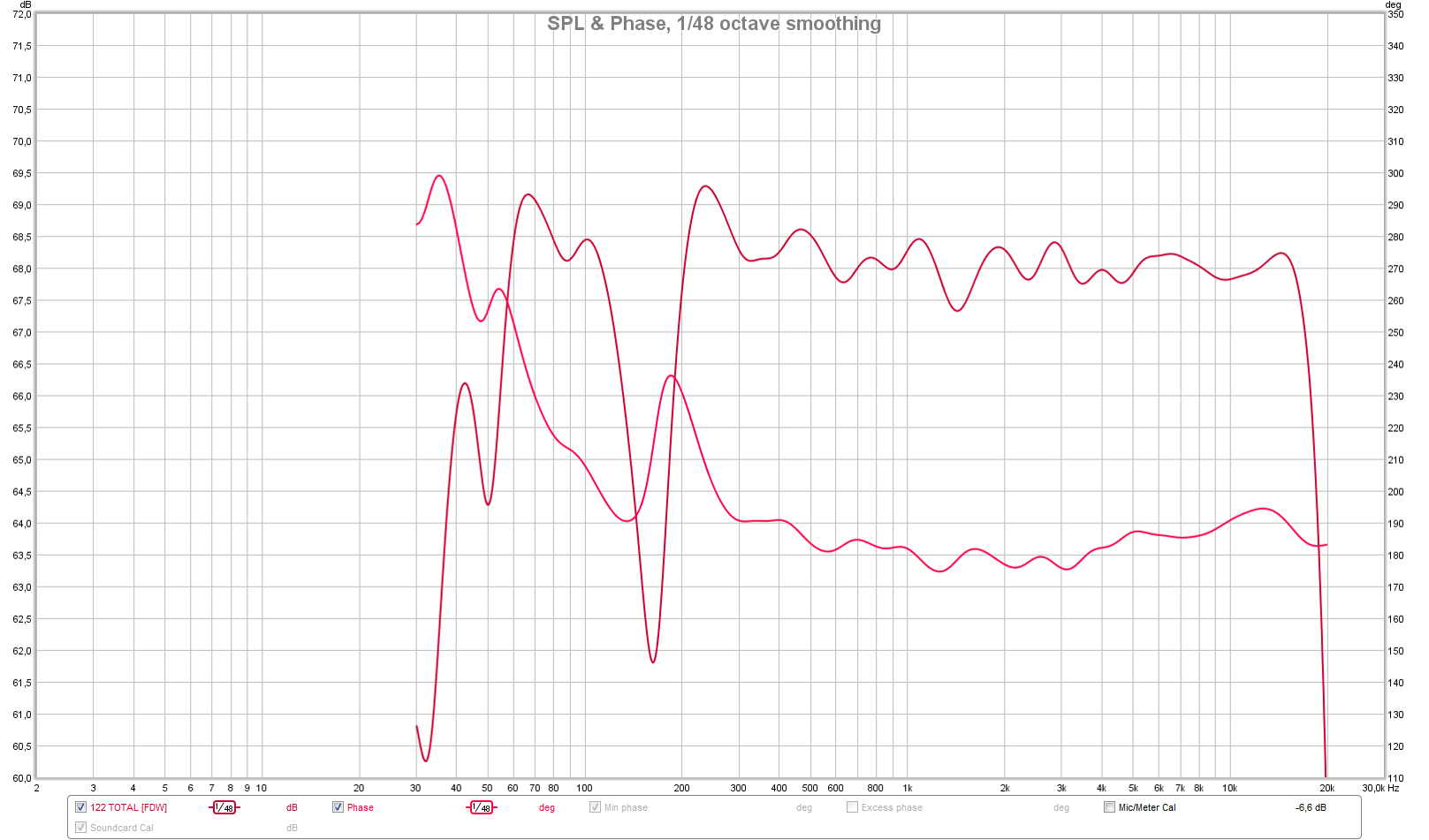

So I've been playing with rephase in order to fix the phase issue at the listening position at 300Hz and this is the best I can do. I tried all the different windowing modes. Bartlett gives best results, similar to rectangular windowing but smoother.
Still a 140° difference and I'm not sure it's going to sound good with the spike going down to -70°.
I just went and ordered some wood to build acoustic treatment 🙂 and I allready did some acoustic treatment experiments further back in the thread.
I also measured with the speakers further out. Pulled out furthest that I want them it only made the dip wider.
I'll try playing with the crossover a bit. They are crossed at 300Hz and 2500Hz right now.
