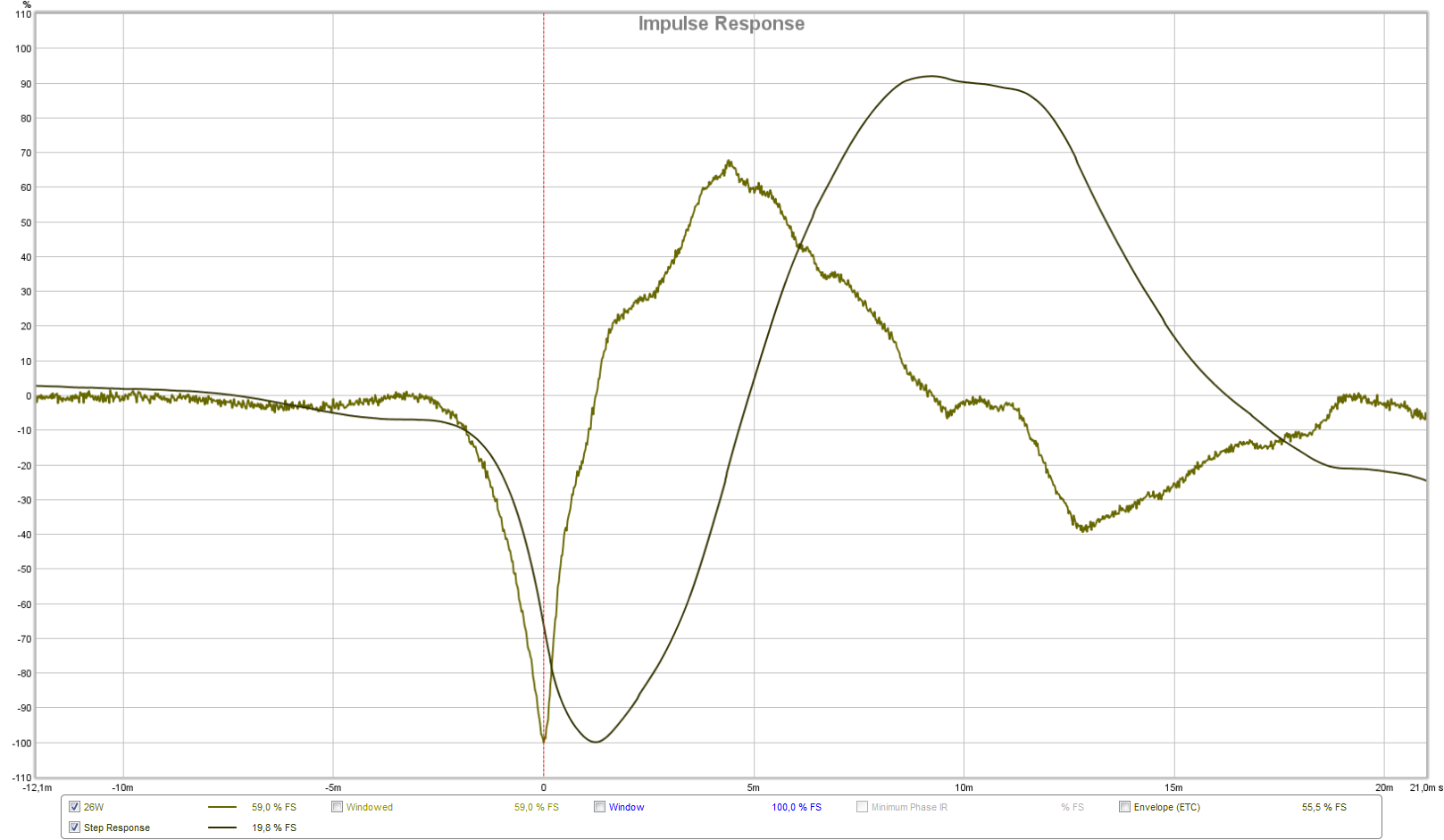

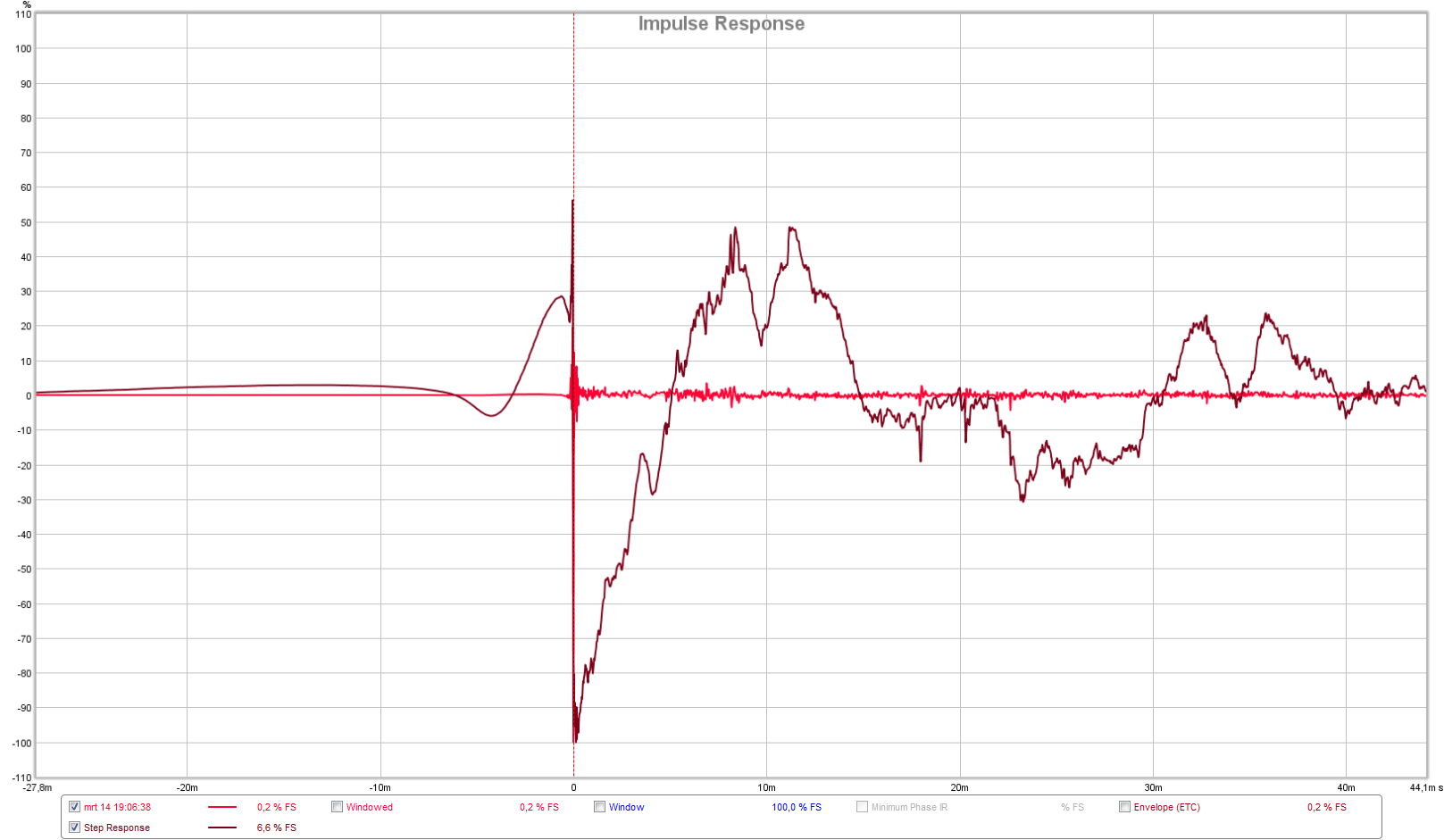

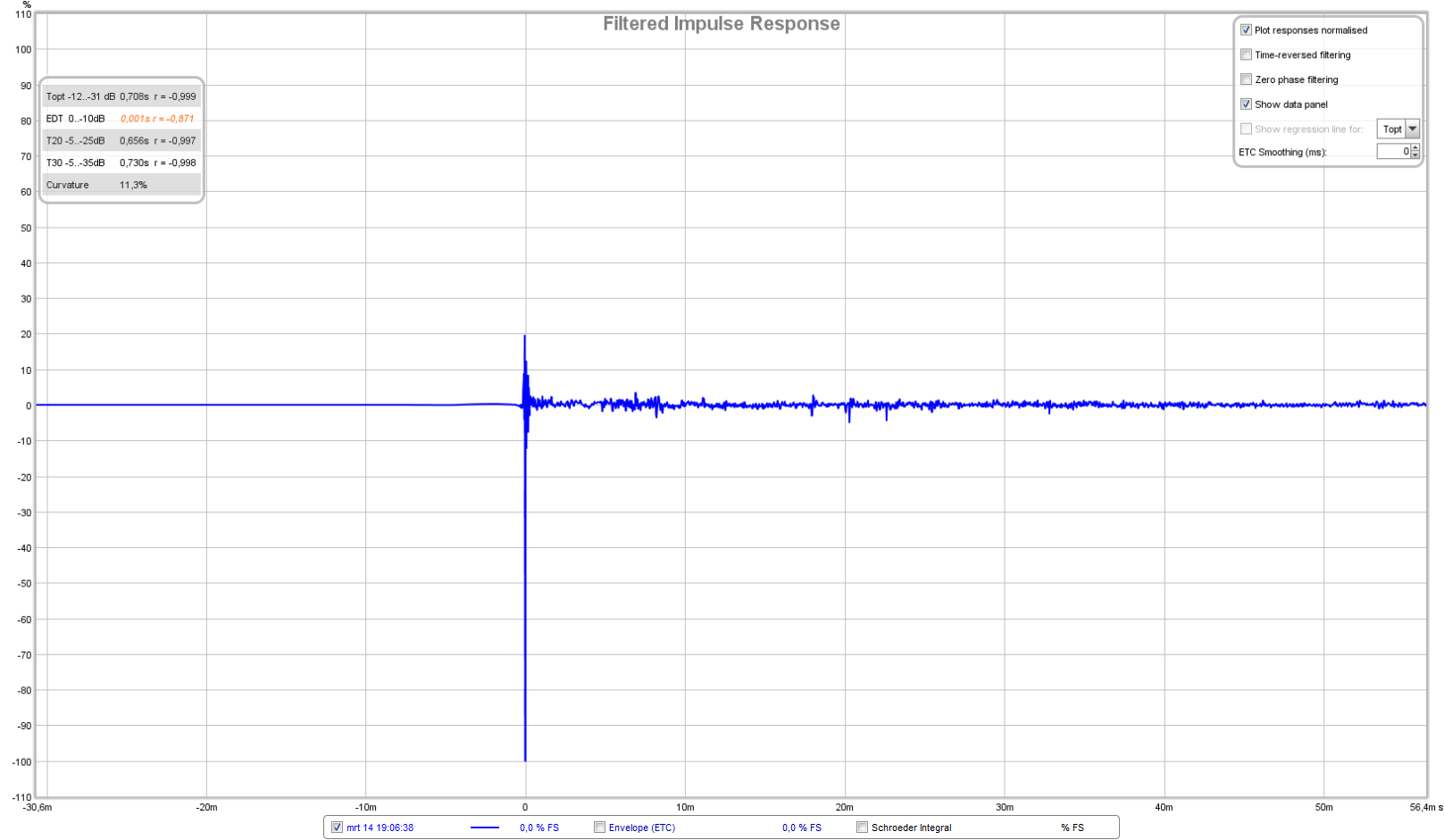

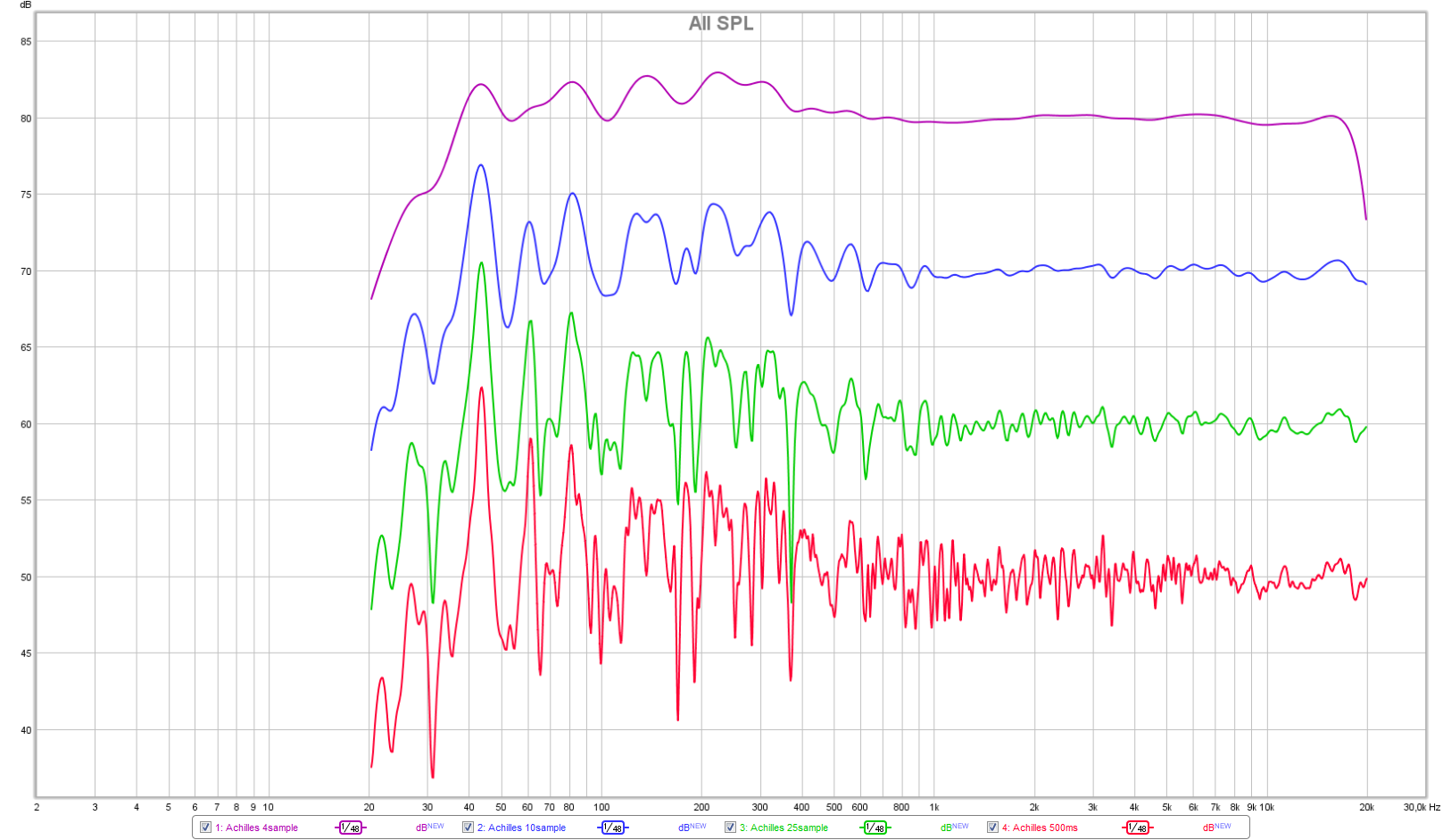

Did you ever check/measure at the listening position?
I can recommend trying the free APL_TDA demo suite, both at the "design distance" and at the (final) listening position.
Be aware that REW's current frequency dependent window is giving a smoothed result. I'd also check with unsmoothed plots and gating to really know what's happening.

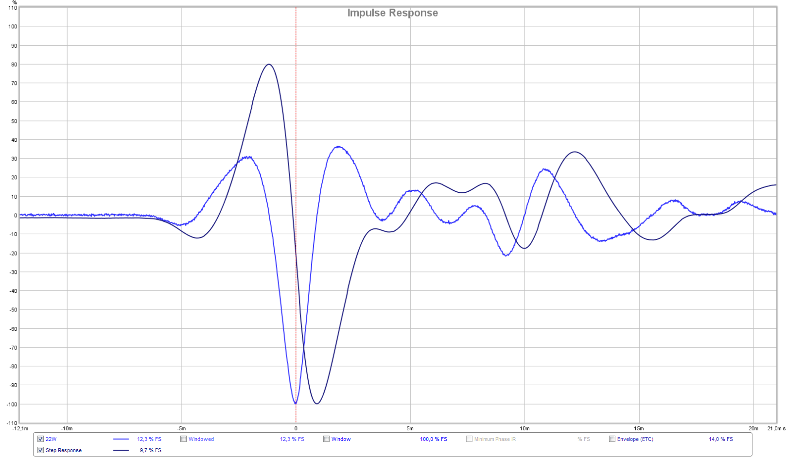

The IR is looking good though. Can't help but wonder about the little disturbance at ~10 ms. What does a filtered IR tab ETC plot look like?

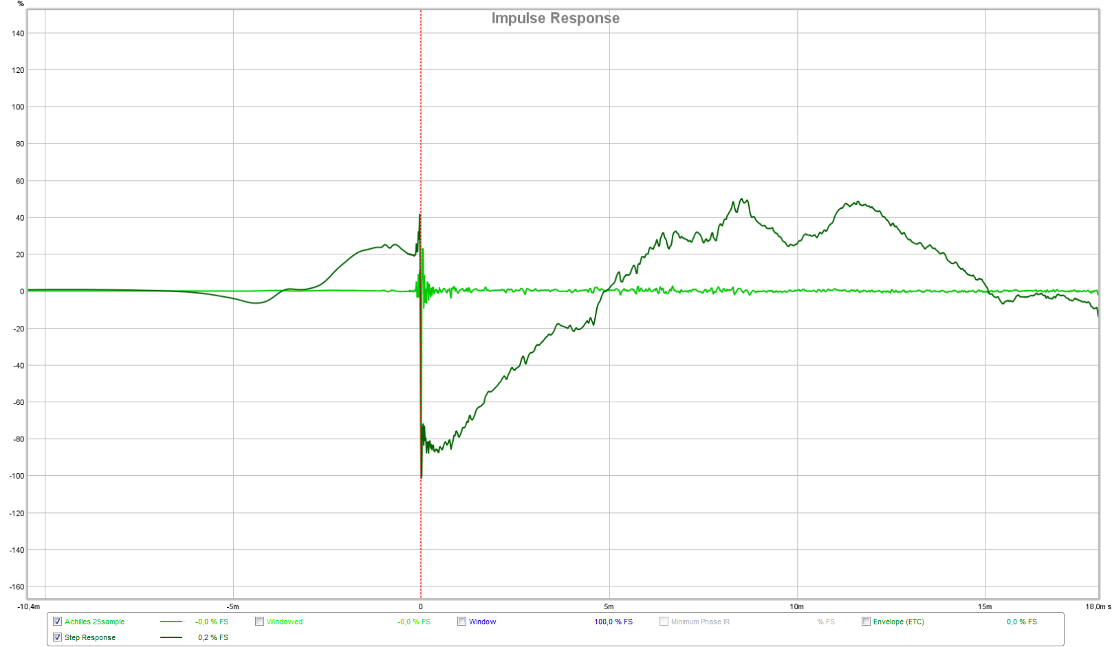

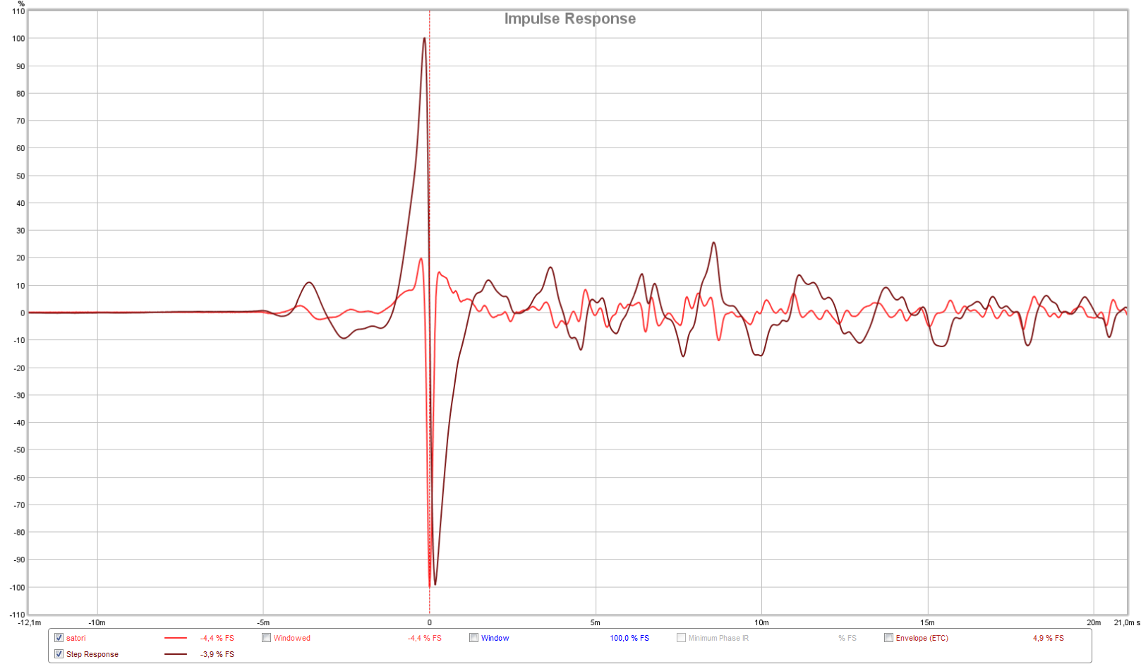

Zonneschimmel, is there a reason why the FIR corrected plot is inverted? (IR peak is negative)
Chiming in, related to this Q: Acourate FIR correction (via MiniDSP Open DRC-DI) also inverts.
Unless comparing head to head I listen in stereo. In any case inverting the drivers in Najda takes only 3 button presses to load the inverted FIR config.

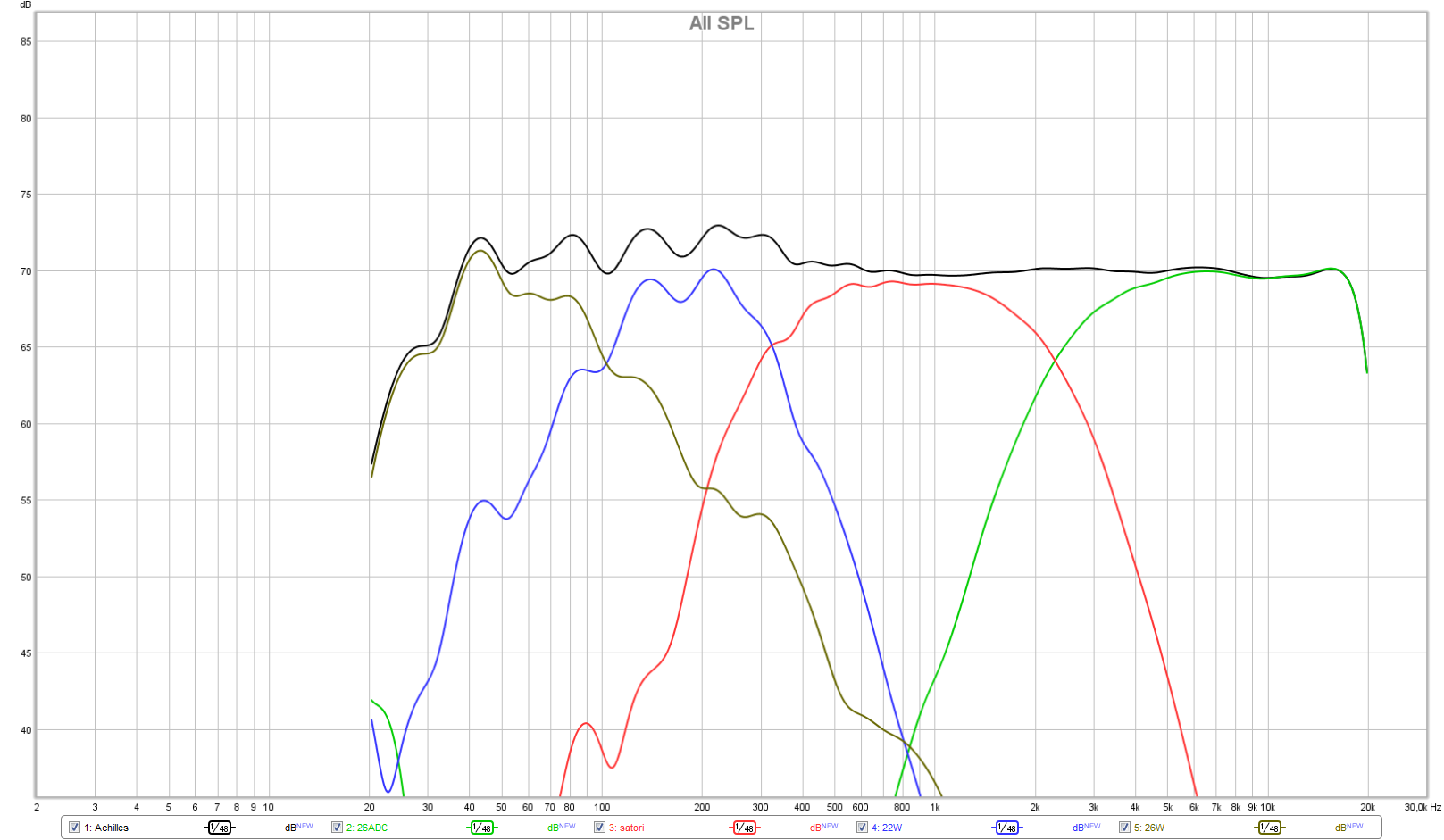

@ Draki: I'm using rephase to build the crossover. I also looked at openDRC and intend to try it in the future but prefer to have my hands on all the buttons for now so I get a better understanding of what's going on.

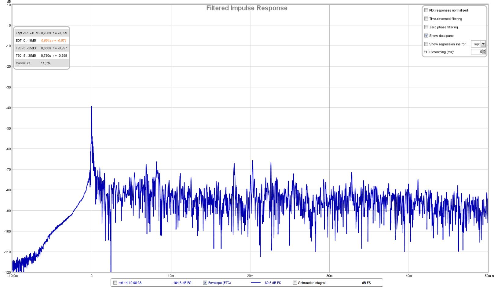

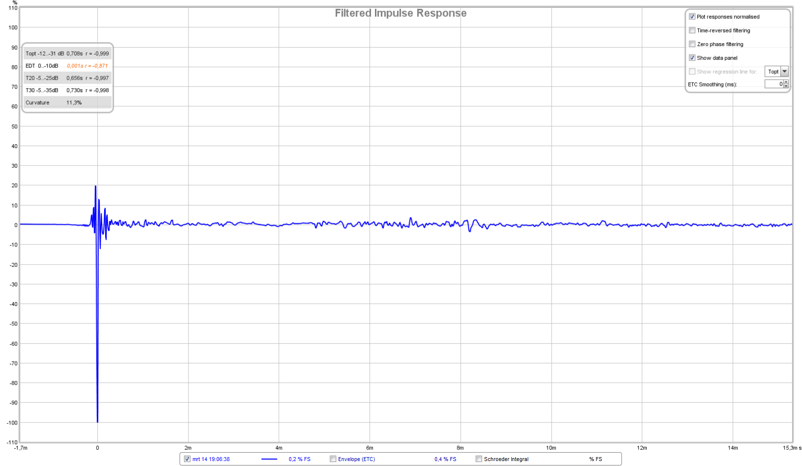

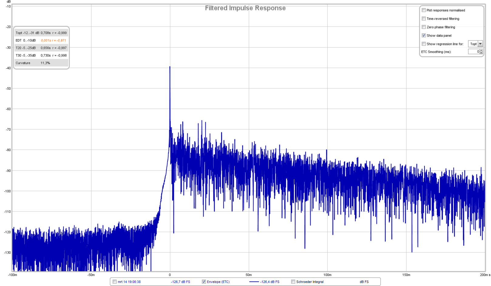

Use the ETC view: [v] and change to dB FS (not % FS) on the left top in the graph...
It will show you the reflections more clear. You can use the filters on the left bottom to view a specific frequency range.
I'm not sure what you mean, I use Najda a standalone DSP/pre-amp unit as a crossover and generate the FIR correction file using Rephase.
Yes, like that, it shows the reflections compared to the peak signal.
As you measure up close it is down by a large amount, which is good.
So that dip at 10 ms in the STEP probably isn't a reflection acting up.
I thought about using a pc as crossover but decided not to go that way (yet). Driver settings, audio stacks and general software troubleshooting gives me a big headache but I'm very interested to learn how you did it 🙂. What drivers are you using?
Loudspeaker units are:
SUB: Dayton Titanic 12" MKIII
Power Handling (RMS)500 Watts
Power Handling (max)1000 Watts
Impedance 4 ohms
Sensitivity86 dB 1W/1m
LOW VOICE: Wavecor SW215WA01
Nominal impedance 4 Ohm
Sensitivity, 2.83V/1m 89 dB
Power handling, long term, IEC 268-5, no additional filtering 400W
Power handling, continuous, IEC 268-5, no additional filtering 150 W
MID VOICE: Bohlender Graebener Neo10 Planar Transducer
Imp - 8 ohm
SPL - 92 dB
PH - long term 100W
High Voice SEAS 27TDFC
Nominal Impedance 6 Ohms
Short Term Power Handling * 220 W
Long Term Power Handling * 90 W
Sensitivity (2.83V, 1m) 90 dB

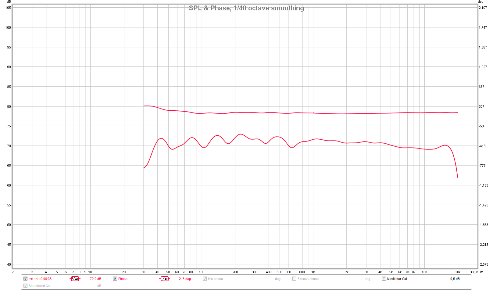

I also agree with WeSaySo about the need for take unsmoothed measurements at listening position. Probably you will experience some issue in taking a good measurement for apl-tda due to the latency introduced by FIR convolution.

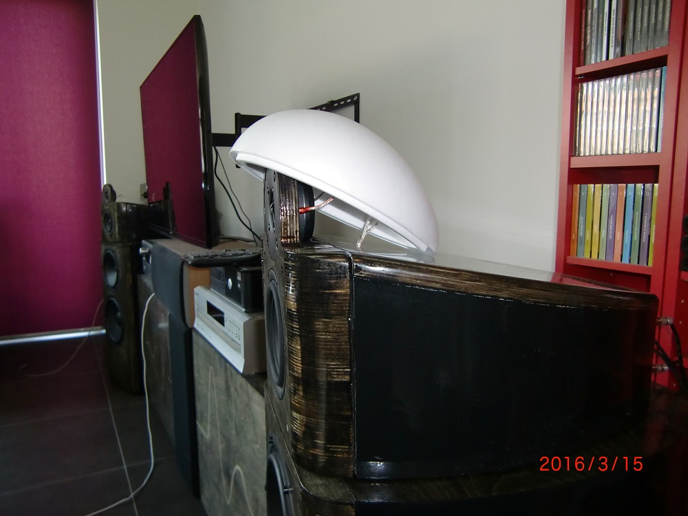

I made the bases for the tweeter heads and tried coating the egg with polyester. I checked first on a test piece whether the bit of solvent in the polyester would eat the styrofoam egg and nothing happened for the first 3 minutes. Thinking it was safe I coated the egg and this is how it looked after the polyester had set completely:
All in all a neat look but I was going for something a bit smoother.
For the next try I'll paint the egg first with water based paint and add a layer of watered down PVA glue on top of it. This should hopefully protect the styrofoam long enough from the solvents in the polyester.
