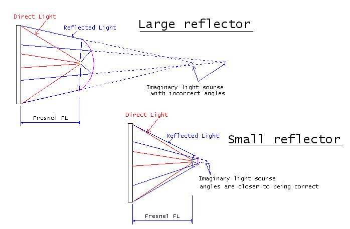

Hello ace
glad to see you back. Is this what you mean by large reflector causeing hotspots?
(See attached picture)
but having light in a parabolic manner through a frensel thats not designed to have parabolic light through it ( focal angle vs ring pitch) will actually show us all of our frensel rings and actually damage the frensel.

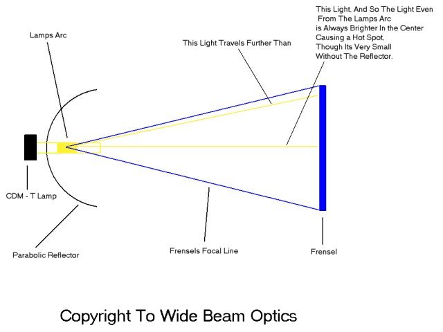

How about i do you a pic with a parabolic type of reflector, ill elaborate in it why we always get the hot spot.
Btw, There is no cure for a hot spot, but we have ways we can rid the hot spot so it can be enough for the eye not to reconise. That takes a light pipe.
Lets Firstly take a look on how things work, the pic should explain enough for you to understand it.
Trev

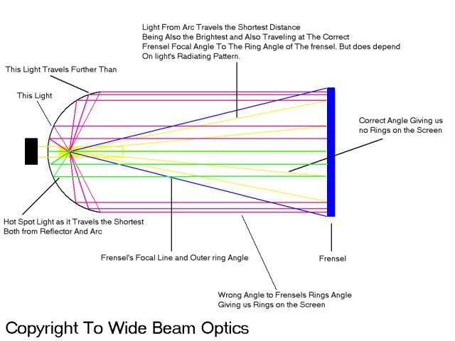

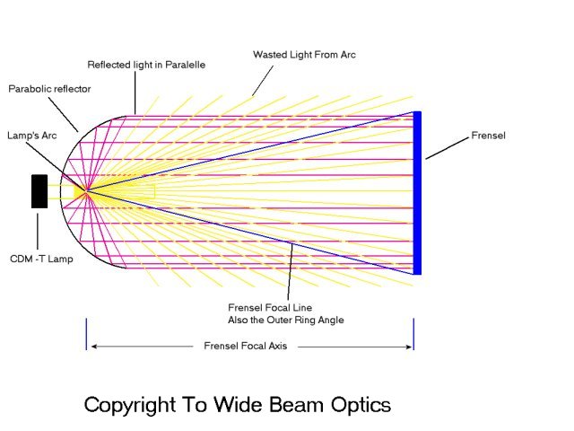

Now take a look at this, even our arc on its own can cause a hot spot, depending on our panel size this can be quite bad, on a small 7 inch its aceptible, on a big 17inch it gets quite bad.
After veiwing these pics i hope now you guys can see why we always get hot spots from parabolic reflectors, spherical reflectors dont have this problem as all of the light is directed back to the source, and with a spherical type system the only hot spot is actually from the bulbs arc as explained in pic 3.
Trev
