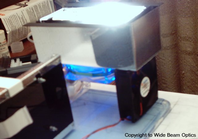

ok and here it is just sitting together in place, there will be a top cover made that seals the outer gap so that only air comes through the honeycombe, but in a test with smoke the only air that seems to get sucked in is through the honeycombe, the vents actually draw the air in through the holes because of the shape of the vent and the way they are facing and the airflow direction so its not realy that important although ill still fabricate one in the mounting stage, also talking about mounting the angle u see on the top and bottom of the box is the mounting bracket that will butt upto the end of the lcd unit and to part B. (the pyramid and condenser).

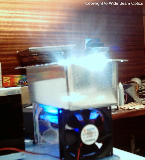

ok testing time, in the next series of pic's u will see the inital testing but before we get to that i have coverd the outer of the light box with the holographic silver covering, although a pain in the *** it beats the hell out of painting this time of year as it takes for ever to dry in the winter lol pluss it is also matched to the lcd units angles as planned, the light box runs that cool there is probally the same risk as getting hit by a meteorite then for this stuff to catch fire, the unit is still not riveted in the next shots getting rivets today, now for the results, in this pic the light is on, its 14000lm, im half blind and as u can see no light at all out of the fan.

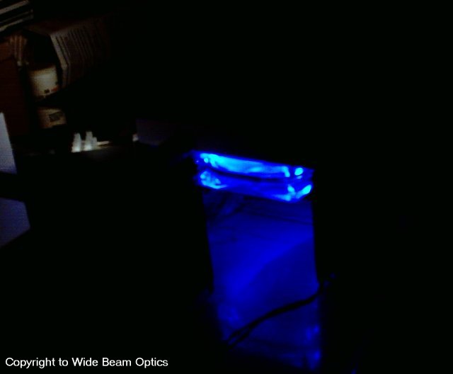

ok in this pic i have blanked out the top with a thick peice of cardboard to make sure no light is coming out of the blue led fan, if u look to the far left u can see a small line of light that escaped from the top from a small gap inbetween the cardboard and the top on the light box, as u can see no white light out of that fan, only the blue leds light!
ok time for the airflow test, look at that smoke get suck in! the 2 fans u see holding the unit up are just to do that, they arent on and are there just to be used as a test bench, also in this pic what u cant see is 2 bits of alloy i used the block the outer vents off so that all air is going through the honeycombe as designed even though all air goes through it with them there or not as earlier stated, also that smoke is cigarete smoke that i blew into the air above it and it sucked it down, its not a fire! lol, hope u enjoyed the pics more to follow soon.let me know what u think.

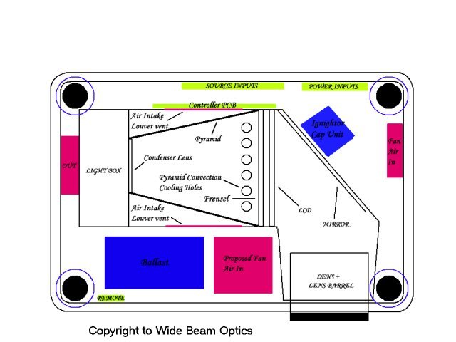

is that the direction of the airflow of the 3 fans?

hehehe nope i dont understand the pic, ill draw one up with the overal airflow and another scematic of the new layout.

ok well here is the new design that im going to use, as u can see its starting to get quite technical, this pic basically shows the changes from the initional design and also the part B of the light engine that will be fabricated in a couple of days, also in the pic i havnt put in 2 power suplies because im abit iffy about the proposed fan and if i realy need it, i could put a psu there, or if i choose to use that fan then the psu's will go near the ignightor and cap unit, there will be a box made for the ballast for colour and cooling and also for the ignightor and cap unit although that stays cold, the controller pcb is now up the back where the inputs have very short cable runs thus eliminating any interference from anything, and the card is out of heat, the pyramid has also holes designed up the far end for any heat to escape in the natural convectional manner, air for the light box will be brought in through the side vents, they are louvers to block any light from going out, im also considering ditching the louvers and putting a fan there to push air in but i doubt ill have room for that, time will tell, ill have more schematics latter on with one for the cable runs, and air flow.
