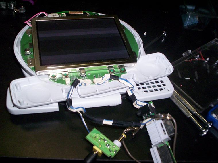

i got a pic to the screen.....half decent too.....
but there's rolling horizontal lines going up the screen....you can see the pic through the lines but it's distorted.....
any thoughts?
the lines are about 1/4 to 1/2 inch thick
two video sources so far have been a karaoke machine and a vcr
the voltage is right but i'm not sure about the amperes......could the wrong amperes cause an off refresh rate on the screen?

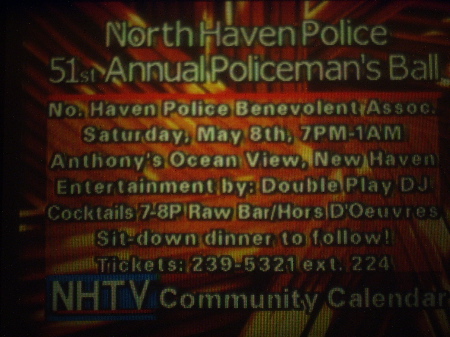

Ok, no flash did the trick - So without the nightflash, but still on nite mode, pics came out even better. The colors are inherently too colory? and I have no way to adjust them at this point, but still pretty good. Here is a still of local access tv, the others will be added to the link I posted to the psx folder shortly
This is with composite - I used a standard 1/8 inch stereo plug to 2 rca output cable, just plugged the red rca into old vcr.
I tried my universal rad shack adapter 7.5v 300mA, and got power on, but just one line in center of screen, no pic at all. Sony adapter (7.5v 2A) gave me perfect picture. The adapters go for $10-15 on ebay.

Well the other day i split open an rca lead, soldered the red wire to the pin on the front right, then the wire with no insulation to the pin above (the GND). I assume what i did was right but i cant get a signal. The other thing i have found is that the mini jack lead is the same as a sony camcorder lead, you just need to change the gender on the video plug lead. If i can't solder it i might buy one of these for 4 pounds.
Well, i got it working, stupid me thinking COM was common ground

used my sister-in-laws ps one power supply and all the screens worked perfect......
so i know it's just the wrong amperes (sp)
