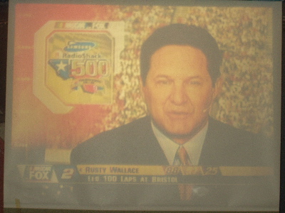

I have finished today with my psone projector.
For the final result see here
For pictures of the stripping and building look here
Projections (40")
Cartoons look nice:
Text:
From a distance very nice:
Projections (40")
Cartoons look nice:
Text:
