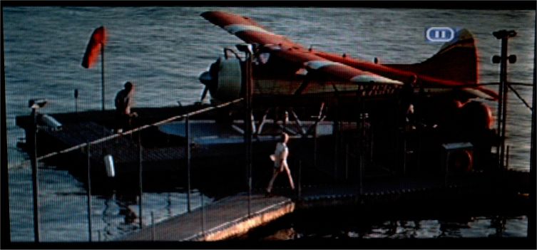

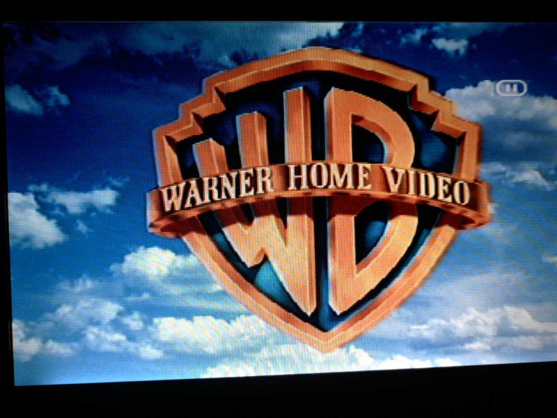

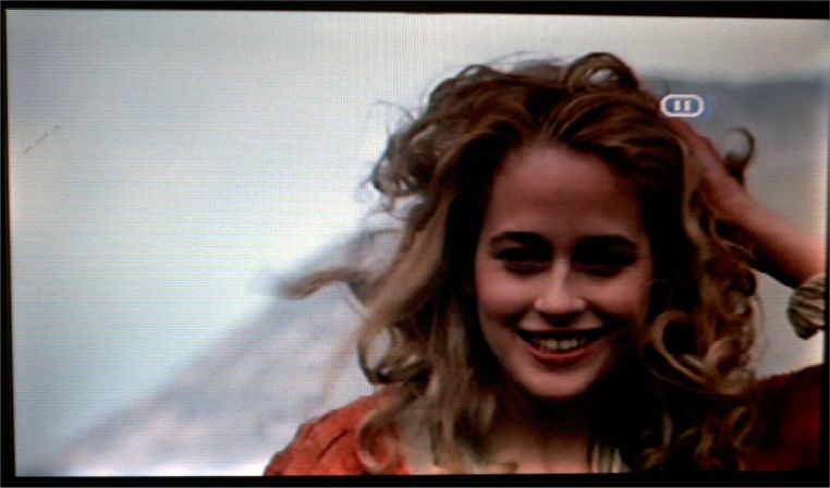

I just bought a portable dvd-player with a 7" widescreen tft monitor, the unit has video-input connection. I´m not planning to use this with diy-projectors but I just want to show the picture quality and how a low-resolution monitor handle video. I think the resolution is 480*234, but I´m not sure. The moore pattern you can see is not there in the reality.

if i can get results near that good i'll be more than happy.....
i realize that things are not going to be perfectly crisp and clear...perhaps a little blocky or some blurred images during movies but if it's even half decent it'll do for now.....
and perhaps with a good bit of tuning and work i'll get an image good enough for everything i want to do.......who knows
