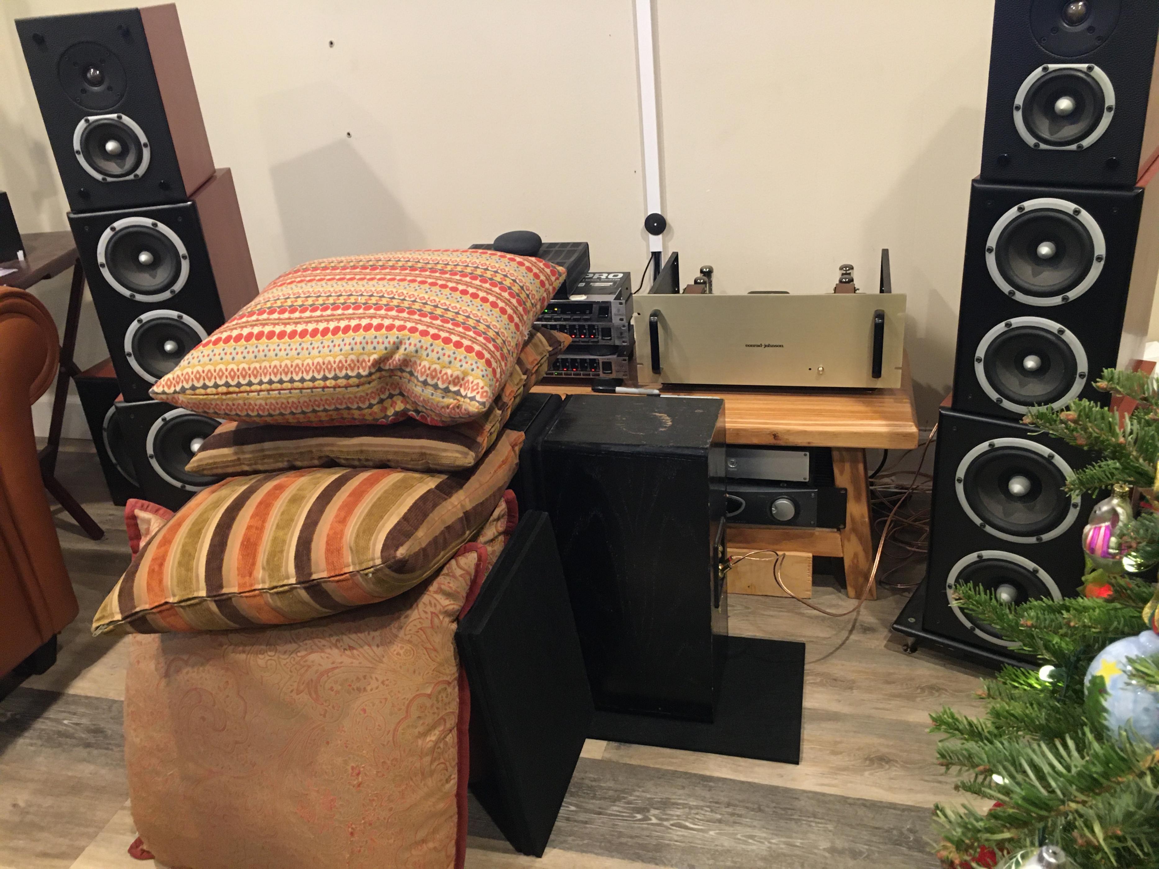

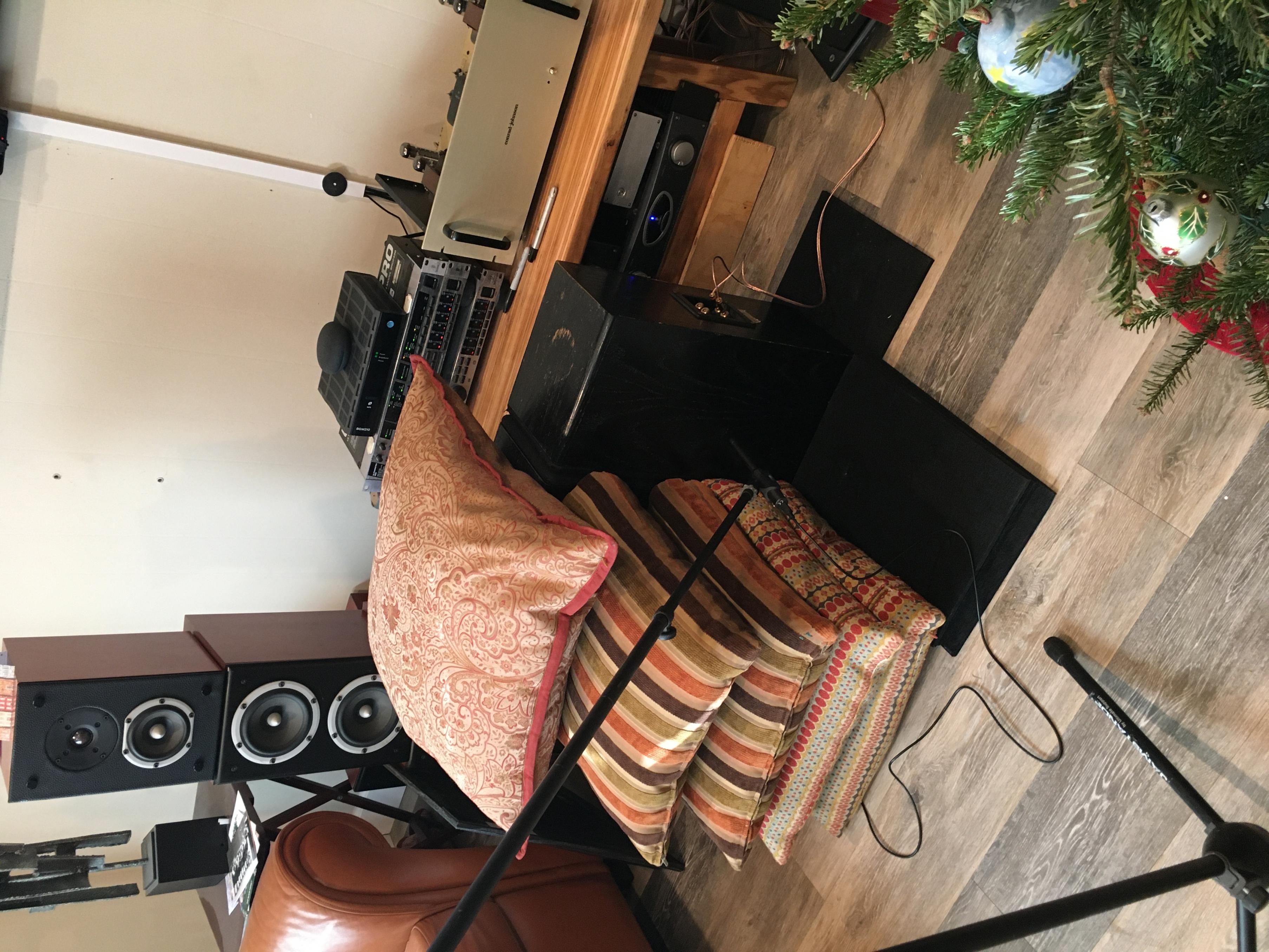

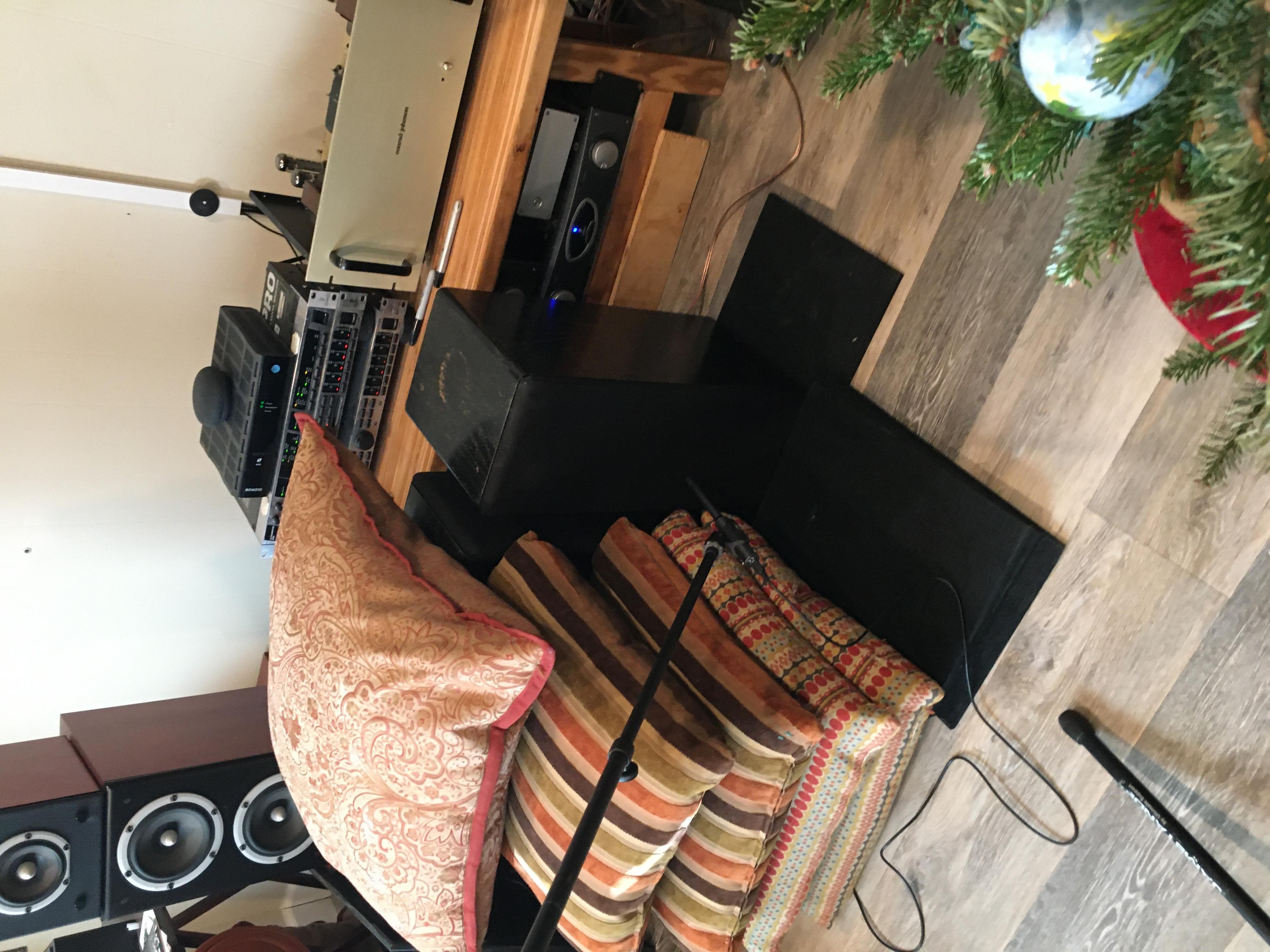

Okay, so that was easy. I placed the Dunlavy’s together, hooked one up out of phase, played some correlated pink noise, and wow! It’s so loud! I put my ear up to where the speakers meet, and there’s very little noise. It’s all coming from the panels. As you can see, I covered one up with thick pillows to hopefully keep the lower panel frequencies from canceling out the other side. My wife is using the kitchen(bull in a China shop) so no useful measurements today, but it should be a piece of cake when I eventually run some sweeps.

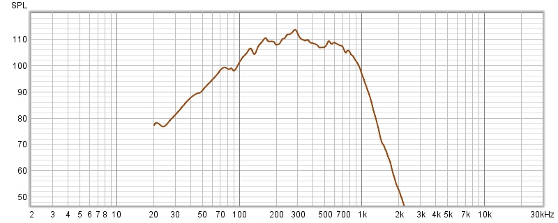

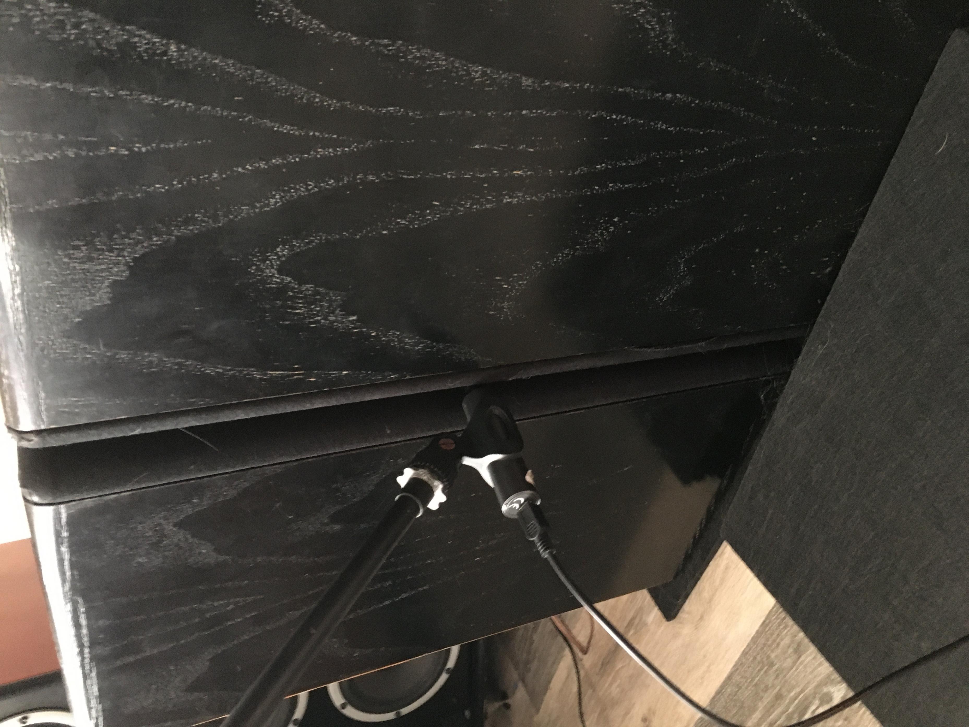

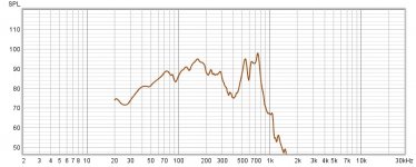

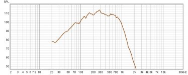

Okay, finally a few measurements..
The first image is on axis at 10 cm

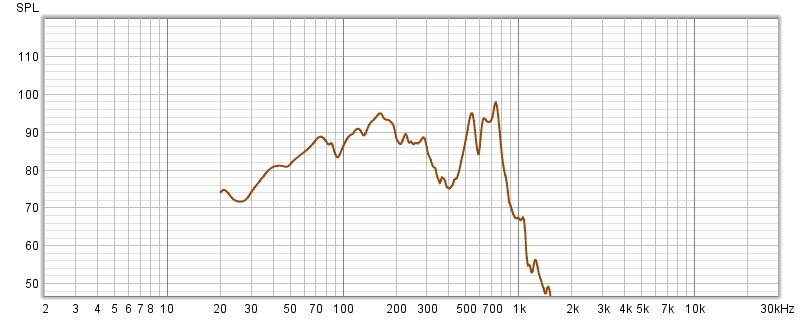

The second image is the side panel at 10cm
The relative amplitude is much closer than I could have imagined. Yikes!

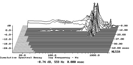

Compare to John Atkinson's accelerometer measurements..
https://www.stereophile.com/images/archivesart/1294SCIfig12.jpg
The lower side panel frequencies are very surprising. These speakers are stuffed all the way with acoustic foam, but I'll try to see if they have any bracing at all.

Thanks for the measurements and the photos. I just worry that much of that is still the drivers. But how to know? That's the question.
The side panel resonance measurements by John Atkinson line up perfectly with my acoustic measurements in the 500 to 750hz range, so the comparison there can be confirmed as pretty much valid. In that area, it's only about 10db down from the reference.
I'm confused. Those are mic plots? Uncalibrted (unless the vibration really was 110dB)? Uncalibrated wouldn't matter if you plotted the sound from the driver on the same chart - which gives S/N. Which is a good start on assessing audibility.
B.
B.
Yes, the mic is calibrated(Umik-1), but this is a relative comparison at 10cm. I wanted the signal to noise ratio to be as high as possible without clipping the mic. The vibration peak is only at 98db. The loudspeaker on axis is 108db.

The Umik-1 usb mic is automatically calibrated for spl readings when used with REW, so FR readings are also of the correct absolute spl. I will also do the measurement again, putting them both on the same graph. Hopefully that answered your question🙂

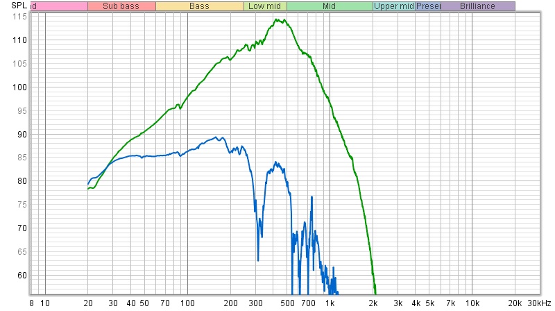

what I was expecting is that the best cancellation (between the two out-of-phase drivers) would be at low frequency, and the cancellation would become less effective at higher frequencies.
You are getting about 10 dB of cancellation at 100 Hz, and closer to 20 dB at 200 Hz. By 400 - 700 Hz you are getting 30 to 40 dB of cancellation.
