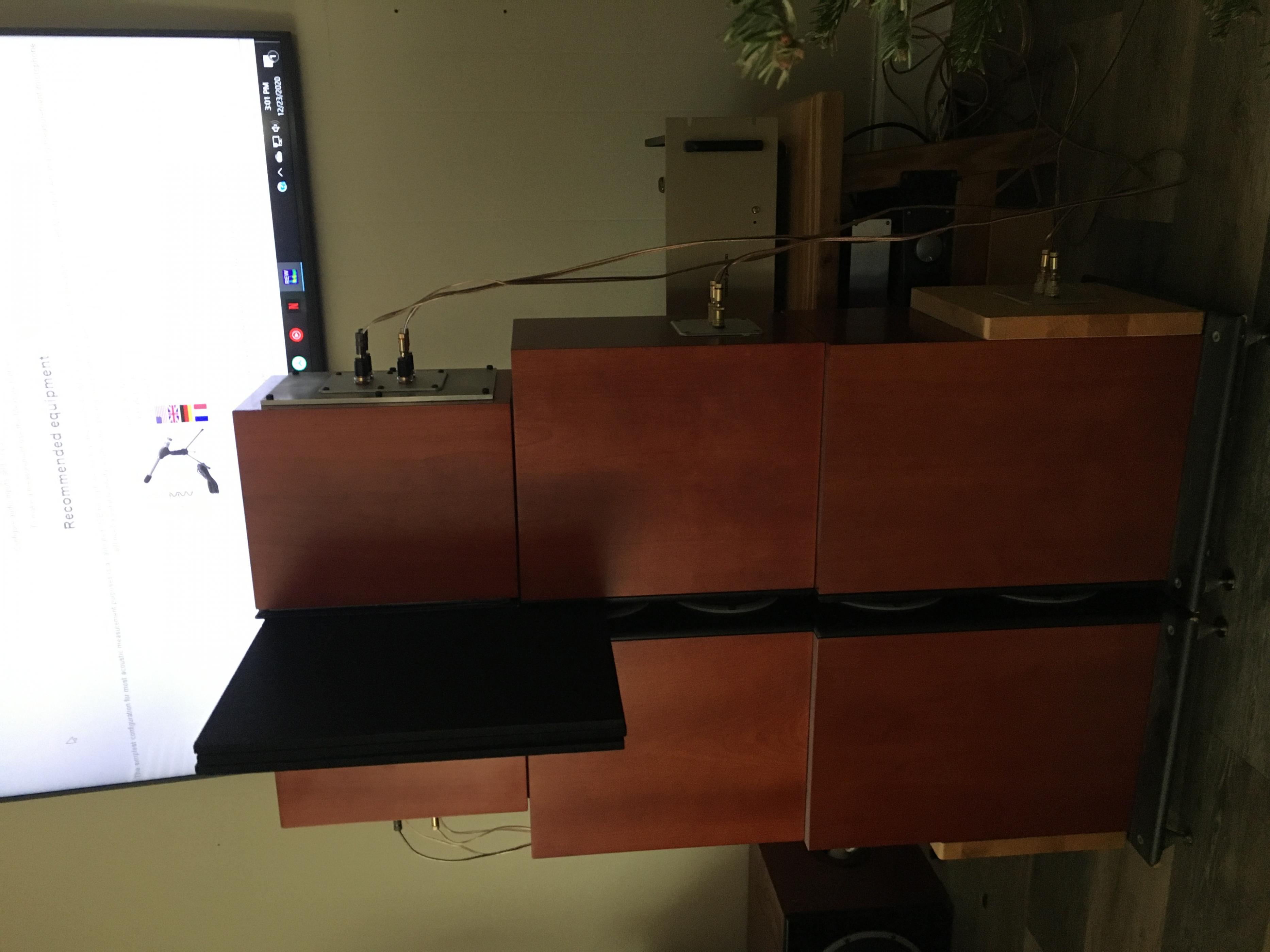

I remember this from back in '94 when I actually owned these loudspeakers(Dunlavy SC-1's) John Atkinson did something with them during the review that I never forgot. I don't recall him doing it since, at least as a way to hear the cabinet.

I've done the face to face thing for woofer run in several times. It does work and does cancel a large amount of the sound, but not all. Maybe enough to hear what's coming from the cabinet.
Maybe the "Not all" you were hearing was actually the cabinet and not the drivers. Placing the mic near where the midbass drivers meet and then near the center of the cabinet sidewall would be a way to differentiate between the two and tell for sure(with out of phase correlated pink noise. uncorrelated would not work)
No, no real way for me to tell what was driver and what was not, except probe by ear. I do think it's a good idea, just want to be cautious that it's not simple to cancel out the higher frequencies. Longer wavelengths do seem to null. As I'm sure you can imagine.
Yes, but a 1khz wavelength(The highest you probably need to go) is 13.5"which is pretty easy to manage if the drivers are millimeters apart. Not perfect, but manageable
I’ll see if I can do anything with it. Nothing at all out of the side panels on the top modules between 100hz and 2khz, but that’s kind of expected after what I did to them. The lower modules are more conventional, with a vertical brace in each. Easy to try with a digital active system. Sorry about the sideways shot
I still own the Dunlavy's, and I obviously know Atkinson's side panel resonance measurements(Pretty severe between 500 and 700hz, but that's relative to a true 91db sensitivity which needs to be taken into account), so I'll see if I can get the panels to sing into the mic while running the 4ohm Nulled(Out of Phase) speakers with 2.83v. I know exactly where to look which will help a lot.
If I can't get it to sing with 2.83v, I'll double it or even triple it. The cool thing is that that the drivers will(should) cancel out no matter how high I take the voltage(Within reason🙂)
