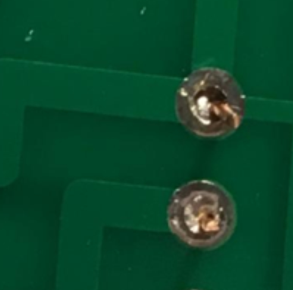

Read your voltages at Q1 pin 1,2,3 and Q2 pin 1,2,3
Compare left to right
The light coming on means the LED works, nothing more. We already know the PSU works because the other channel is good. 🙂
Q1 pin 1 is zero.
All others are jumping around....about 2 or 3 volts.

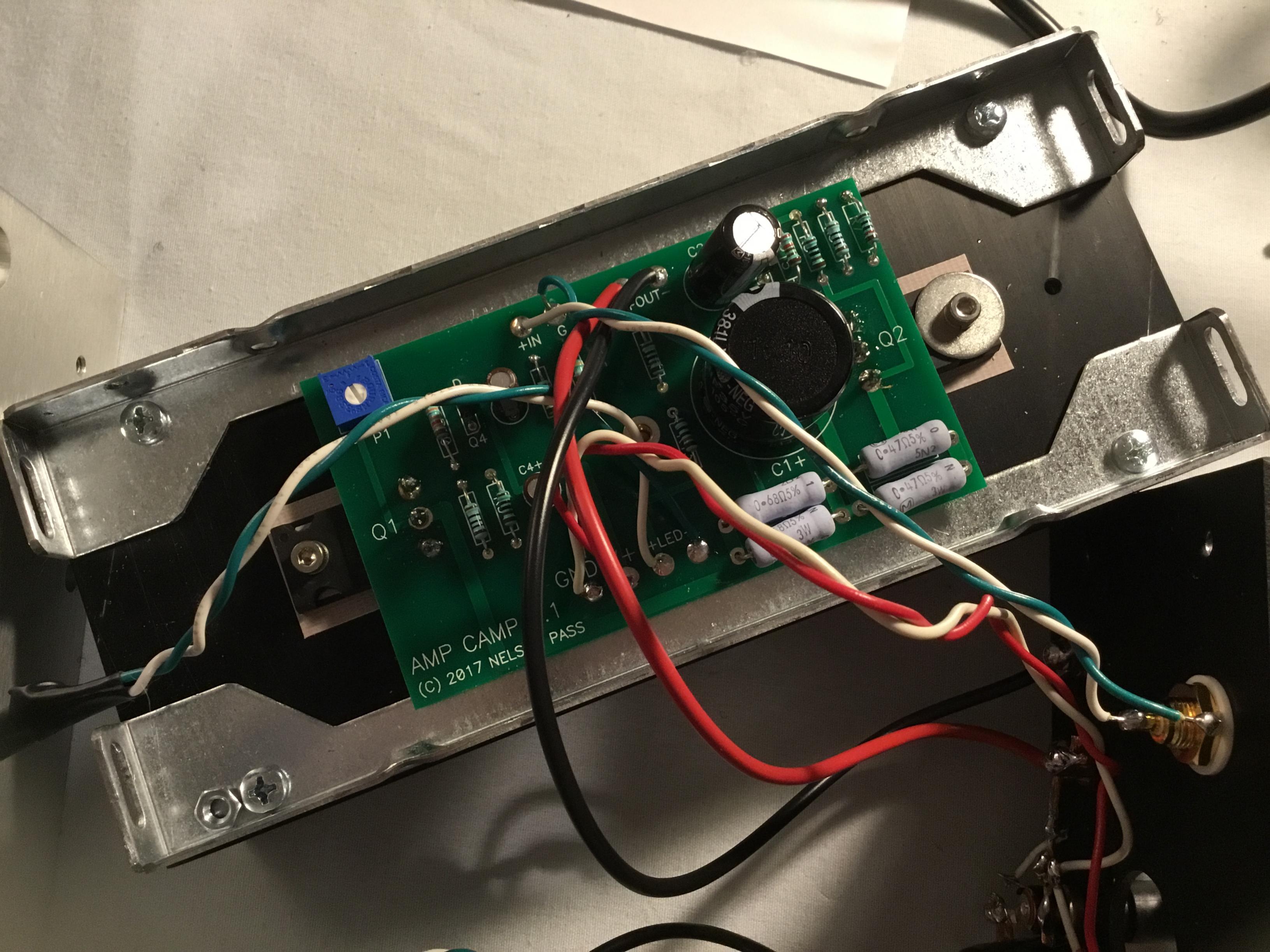

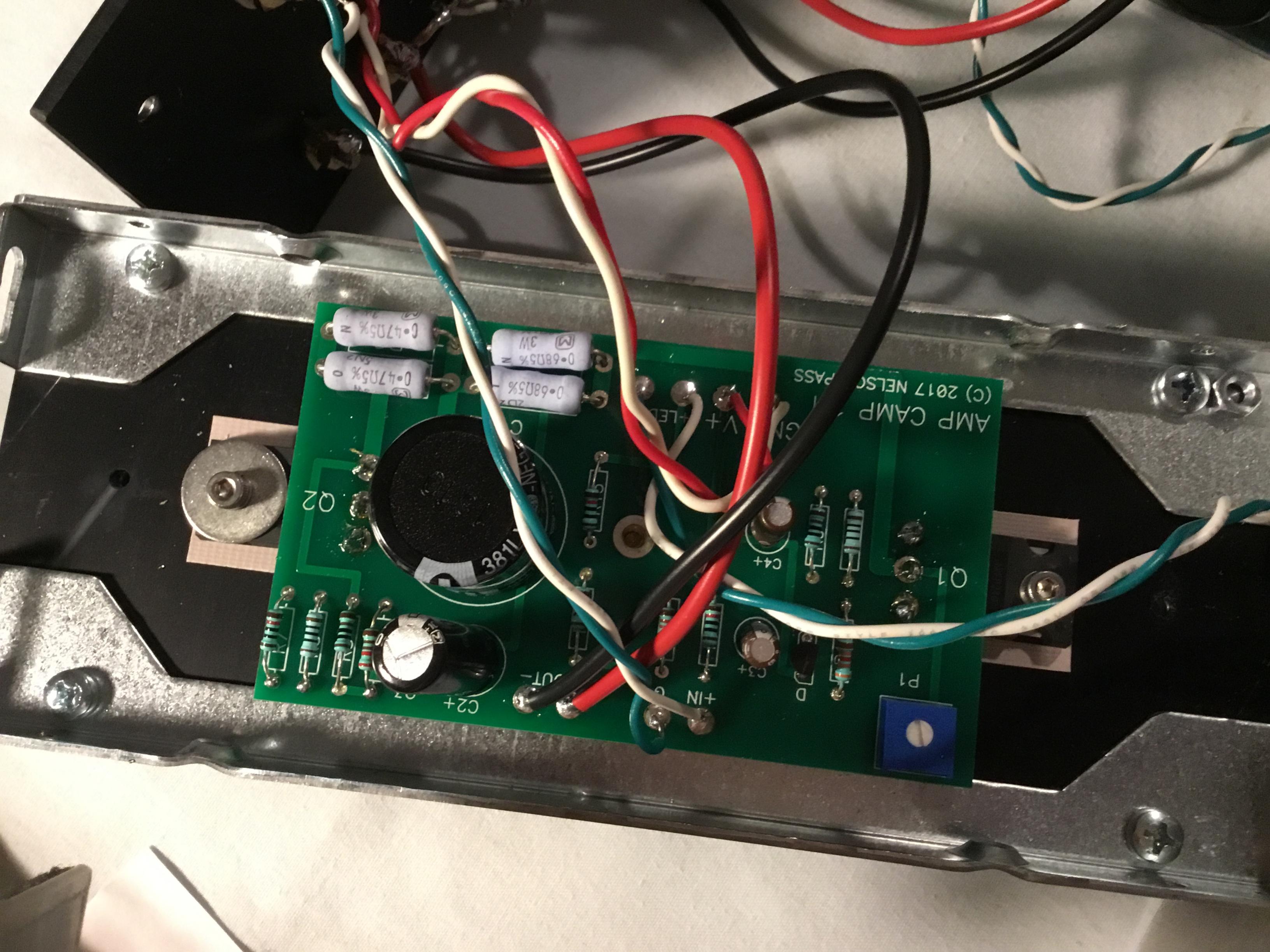

Could You show on the photo(s) what the PCB's looks now ?
Do You reflowed all mosfets as well ?
I reflowed everything.
I just mounted the PCBs back to heatsinks to test Q1 and Q2. Let me get iPad charged a bit and I'll take some more pics.

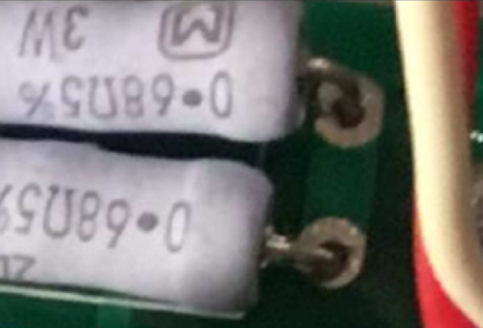

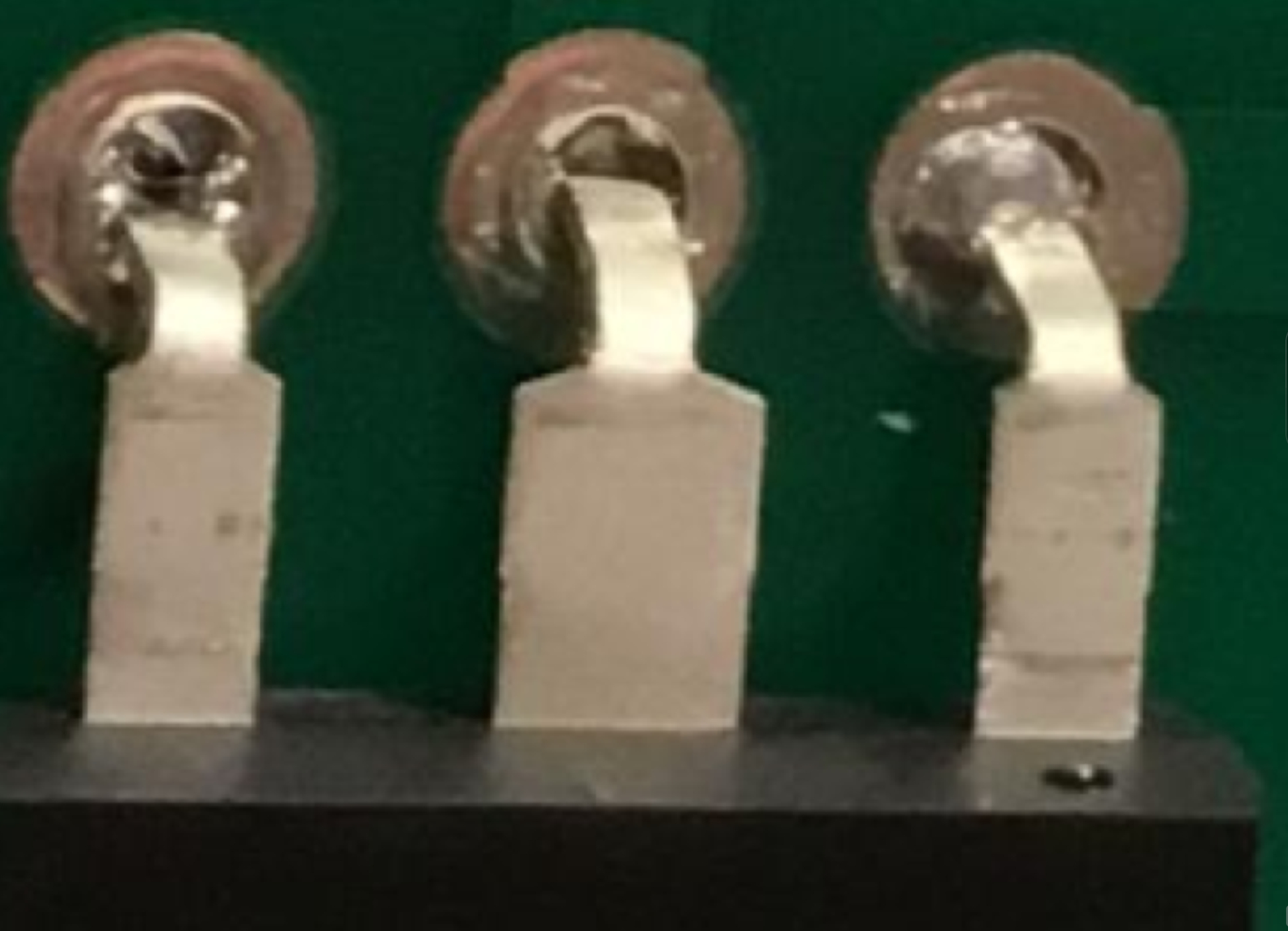

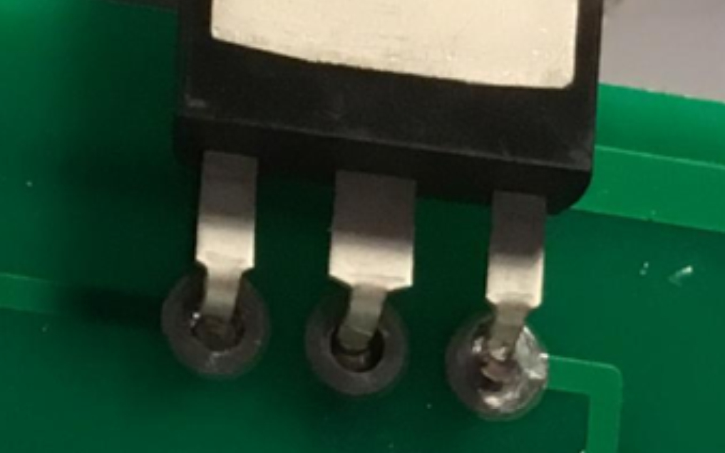

What I see Mosfets and 3W the power resistor soldering joints are not optimal.
Bigger mass, so need heat little more time, or increase the tip temperature.
In this short tutorial You can find instructive, good examples
"Component Soldering"

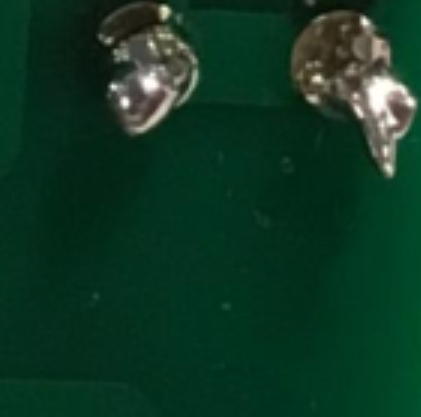

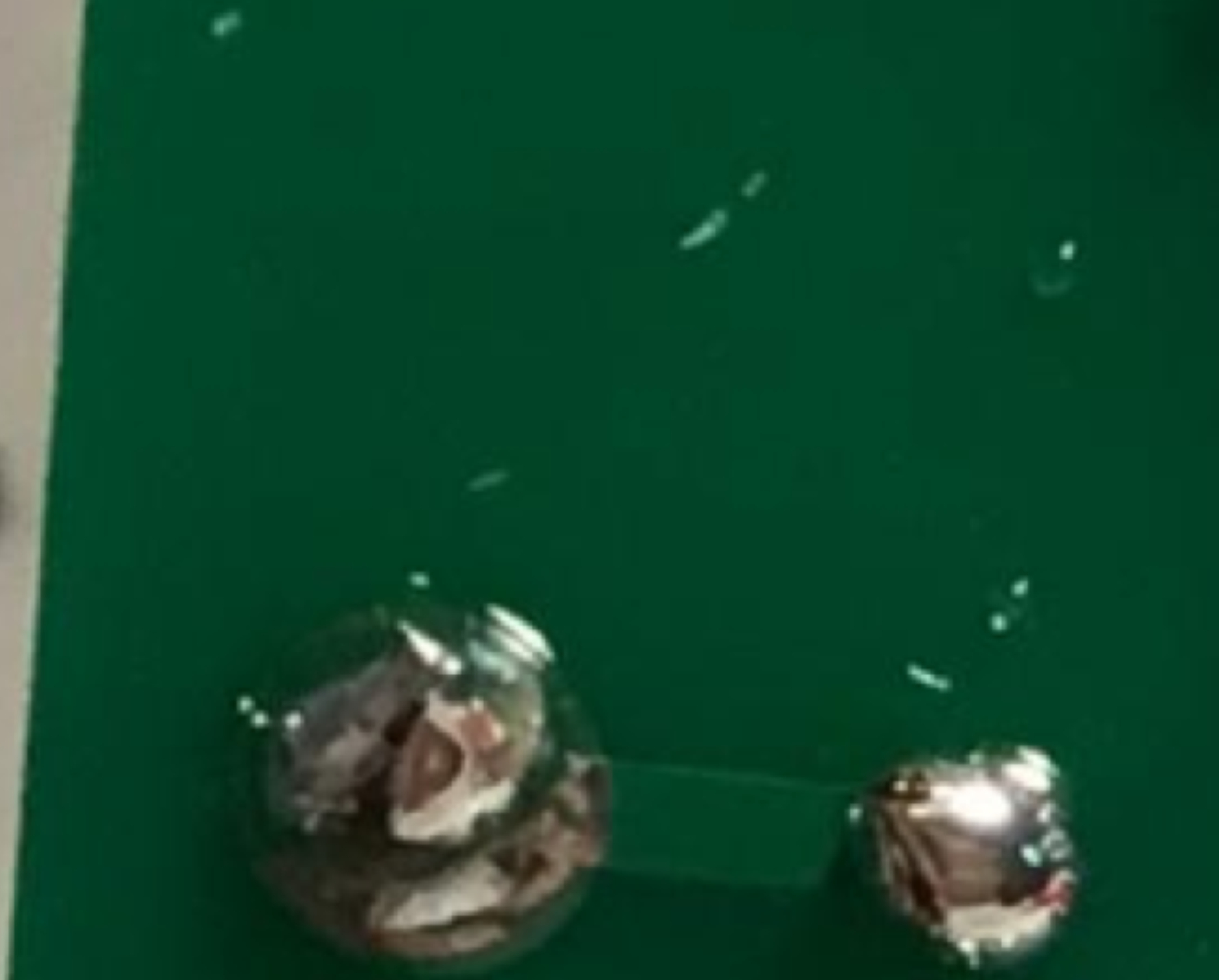

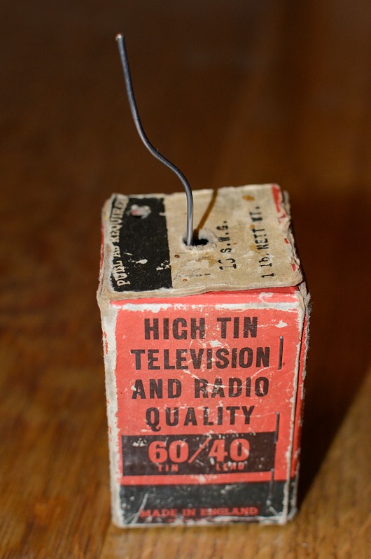

Also use the old fashioned solder with 60% tin and 40% lead. It flows much better then the newer Rohs types with no Lead in it. The melting point is lower for 60/40 solder.
Looking at your solder joints it looks like your solder has high melting point.

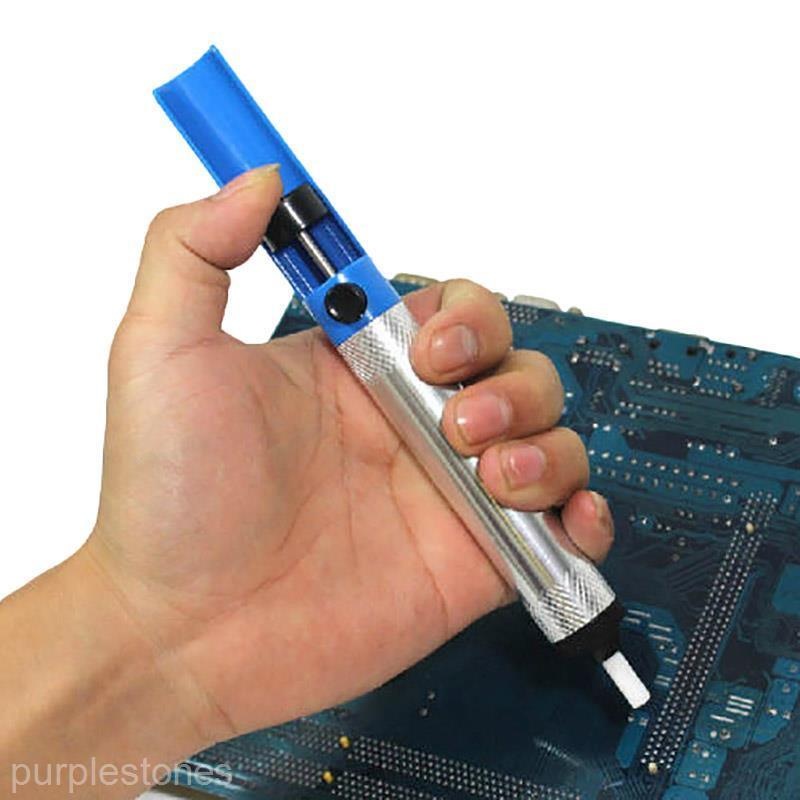

As one mentioned a solder pump is good to remove old solder and start from fresh with joints that has got too much solder. Get a pump with a soft tip.
The solder has to flow nicely also to the front side for this kind of PCB (e.g. for the pins of the mosfet).
Ordered a desoldering pump. Hoping I can get it fixed. Although at this point, I don’t think it is a soldering issue. I’ll resolder in next few days. Hoping it isn’t a lost cause.

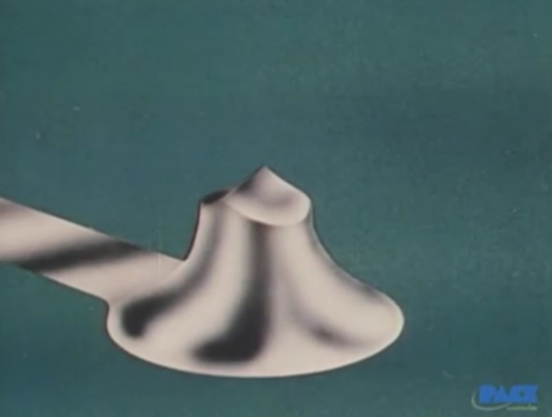

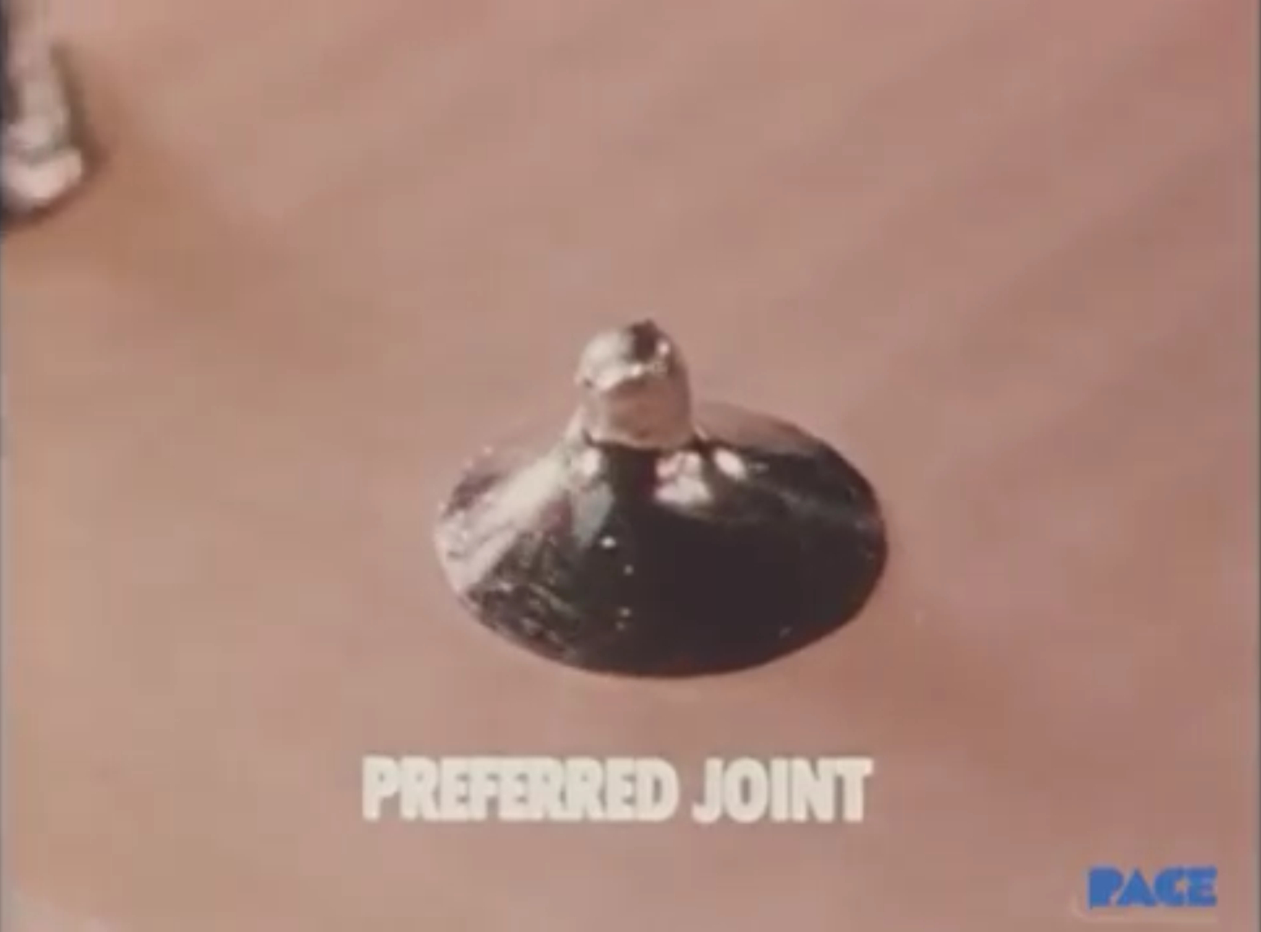

Just compare Your solder joints with the good PACE joint example picture 😉

I must be a soldering issue. If not if makes no sense that you have 16V on one side of R4 and 10V at the other side of R4. R4 is a 0.68 ohm resistor. If you look at the schematic the one side of R4 is same joint where you measure bias voltage at Q1.

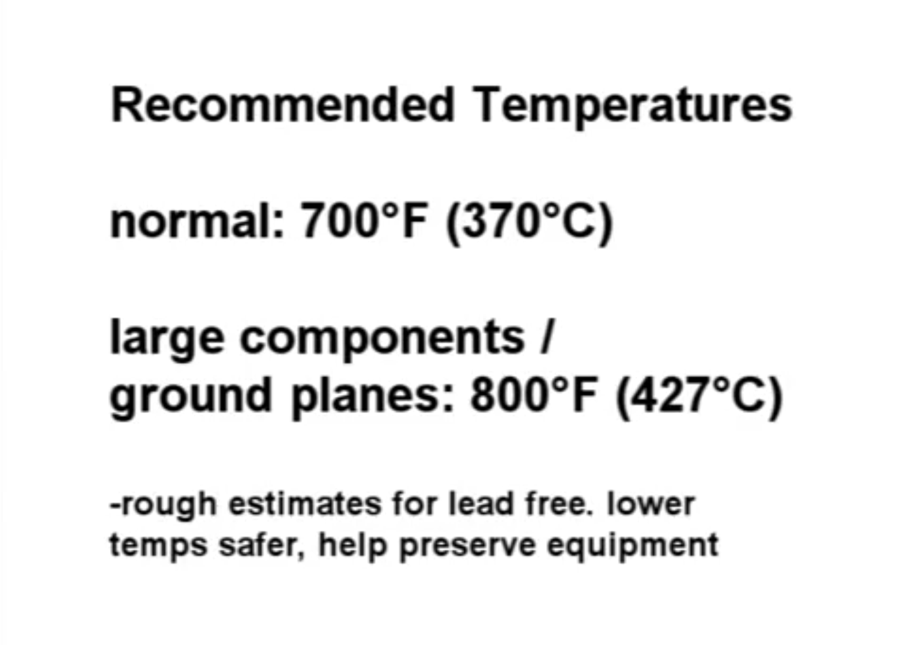

The soldering looks very bad. The temperatur has been too low. Get solder that has approx 180 degree C as melting point and set your iron to 360 - 400 degree C. Then each solder only takes 2 sec. This causes that not much heat will reach the component. Maybe your soldering tip is too thin so it will be cooled down when you hit the joint. For the large joints like mosfets and power resistors you may need a larger tip for your iron that can transfer more heat energy to the joint.
When you solder you also need a wet sponge so you can clean the tip and just apply a tiny bit of solder to the tip so it is just "wet" before each solder. Then it will make good thermal contact to the joint. Then apply solder to finish the soldering. When enough solder is applied and it flows nicely then just keep iron 0.5 sec. at the joint before lifting away fast. It should only take 2 sec. if done right.....maybe 3 sec for the large joints. When you remove the iron and it "pulls" some solder that sticks out from the jont the temperatur is too low. You shall be able to remove the iron from the joint and the joint should still look as the picture above......
