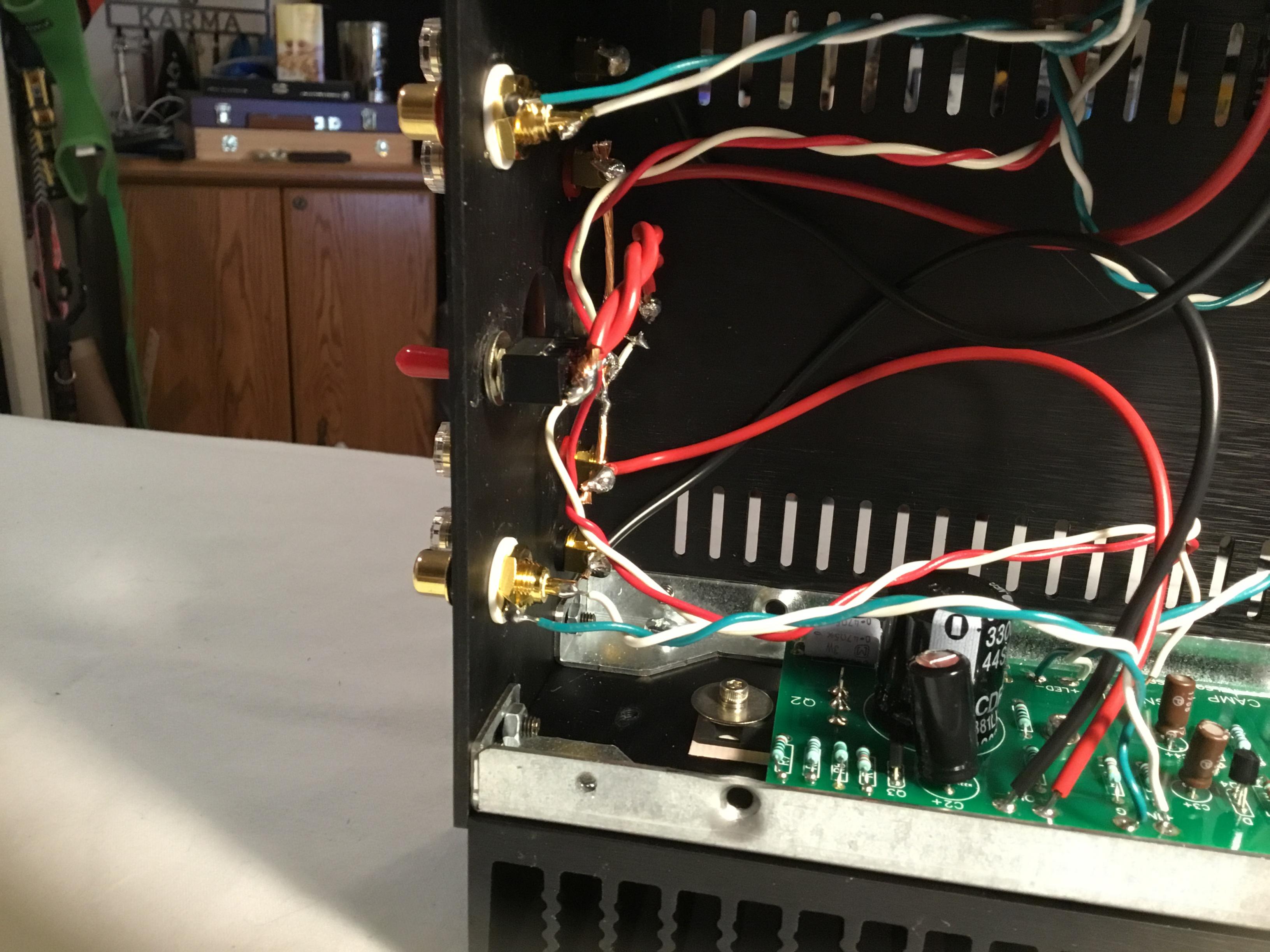

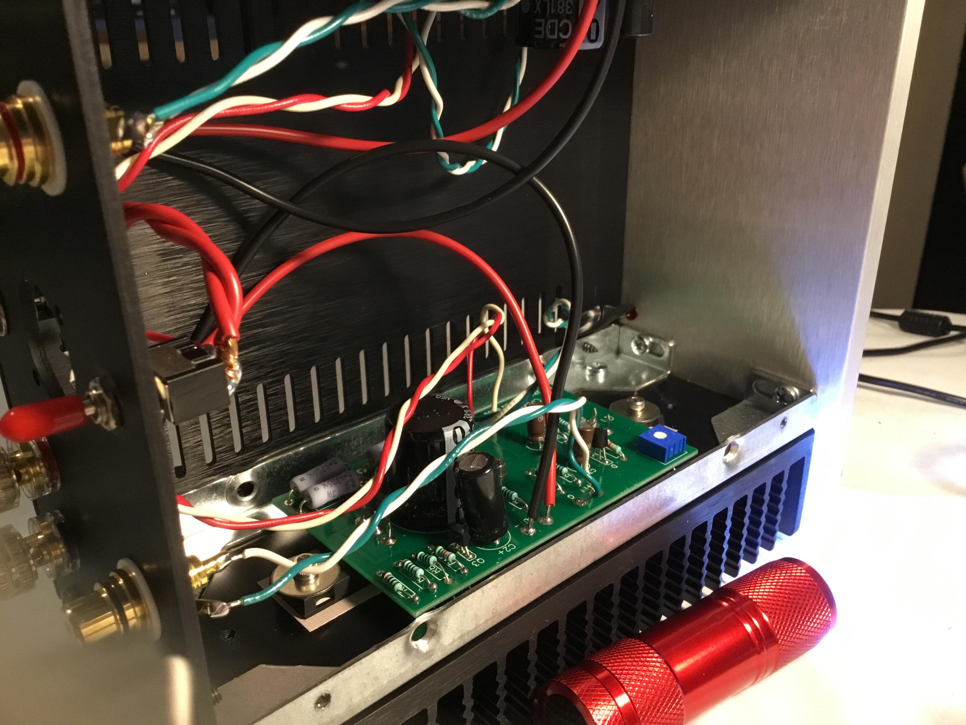

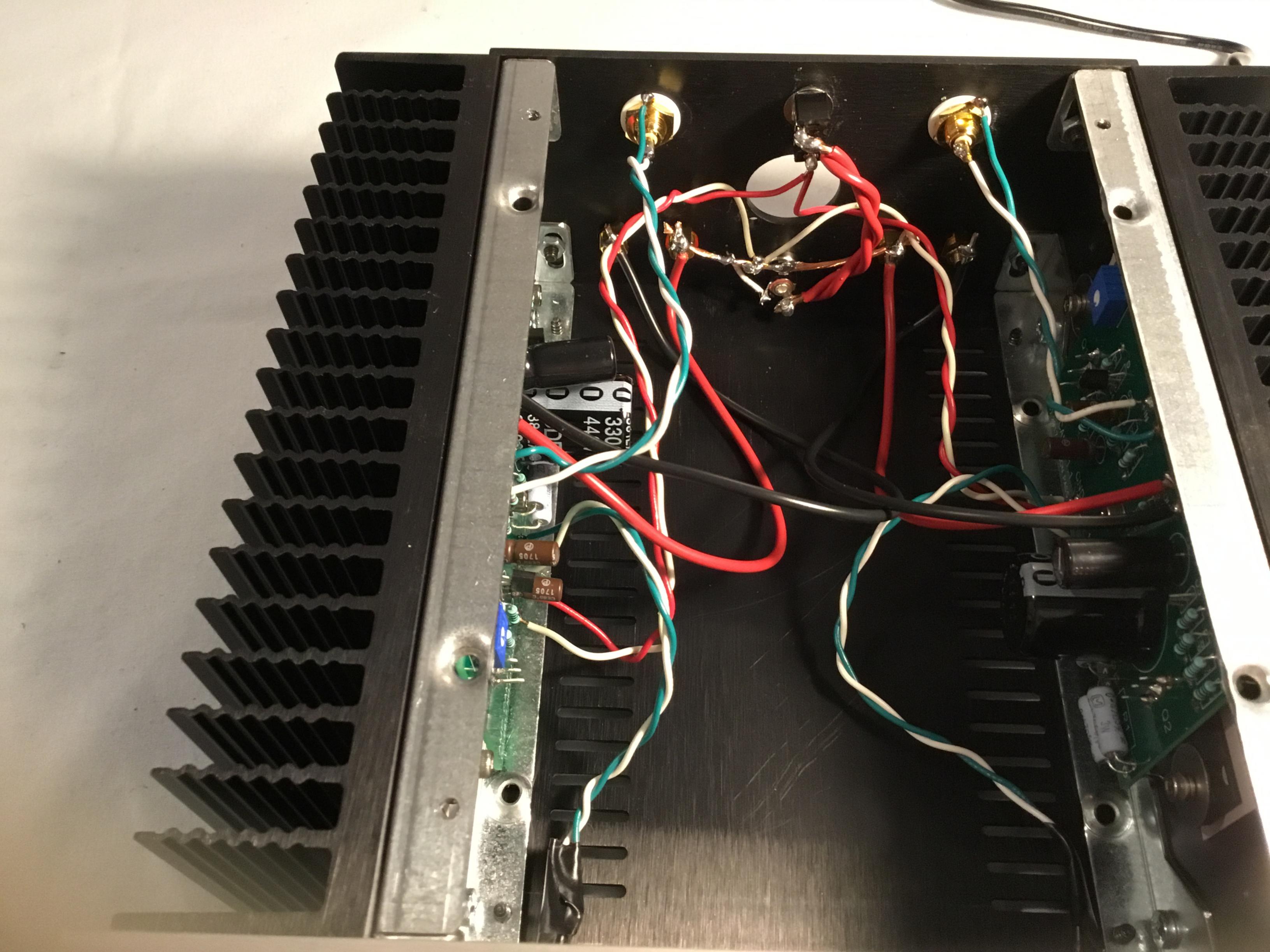

Having an issue with my build. Finished up. Set the bias (one side gave me a bit of trouble reading any volts, but I finally got a connection). Both lights lit up. I’m only getting sound out of the right channel though. Looked over some questionable solder joints and touched up. Not sure what to do now.

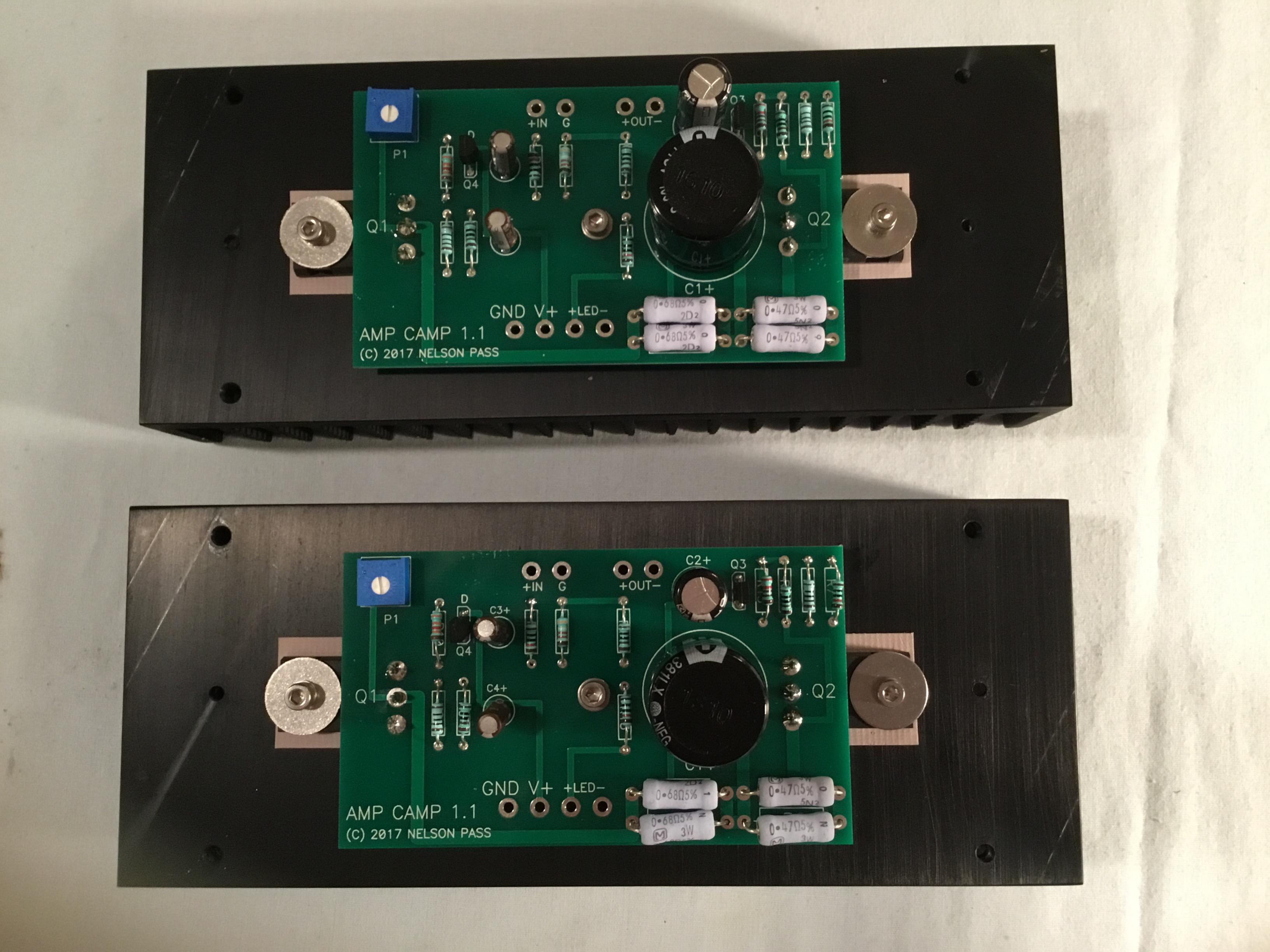

Here’s a shot of the stuffed PCBs from last night.
There were 2 resistors included that weren’t on schematic or build sheet. They were 68.1k.

R13 and R9 seem to be same. The voltage at the resistors on the left channel (one that isn’t working) seem higher than the right channel.
Right channel - resistors R1 through R4 are about 9v
Left channel - resistors R1 through R4 are about 16v
Taken at corresponding places
Remove the suspect PCB off the heatsink and re-flow the solder joints around C2, Q3, and that general area. Also the big resistors.
The 16v is probably the problem. Then you have bias on left channel set to 16v?
Maybe voltages on the Q2 and Q3 pins could tell something. Q2 seems to be driven to hard......but someone with more knowledge on the amp may comment here......
