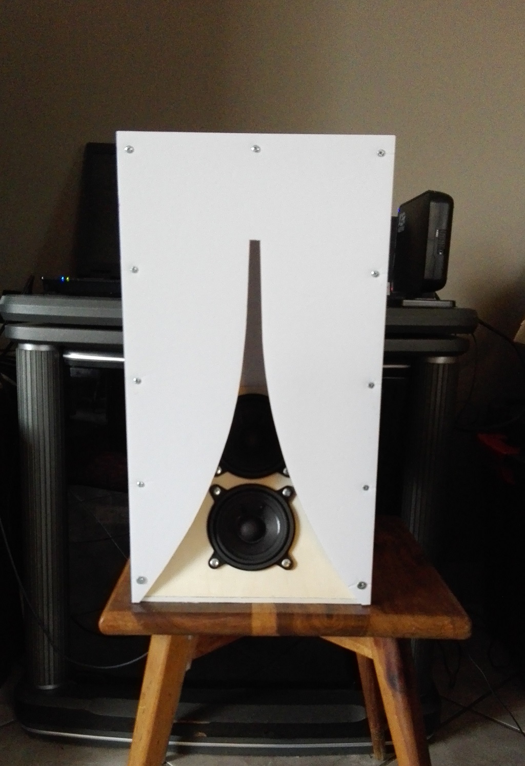

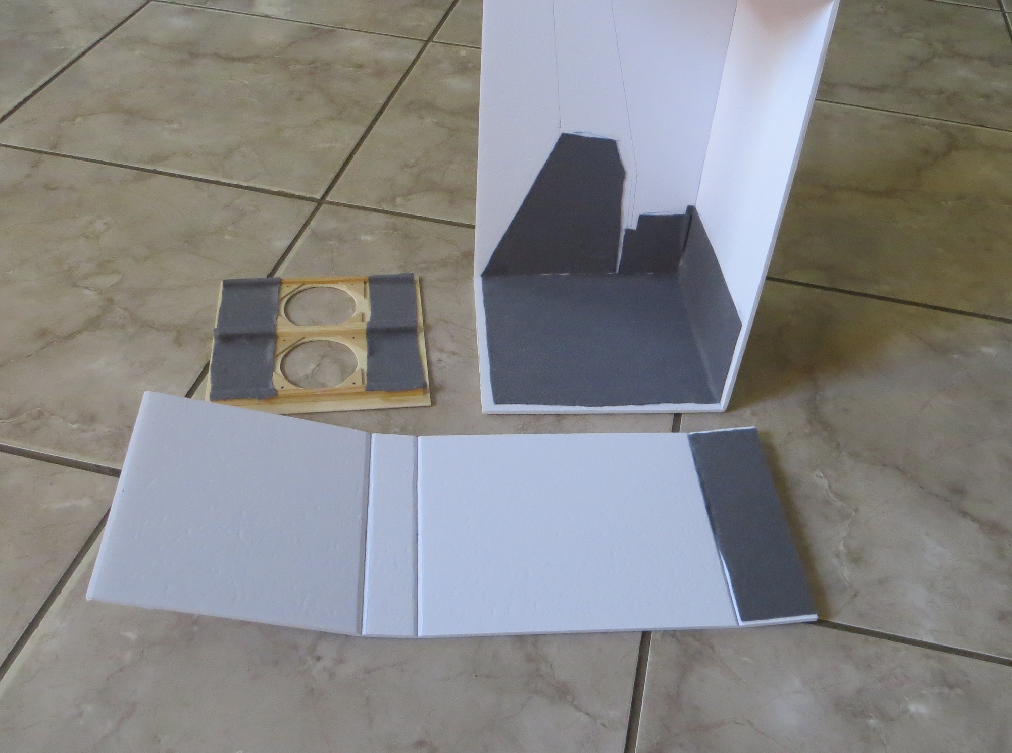

Btw, I have built one foamie 0.53x K with dual Failtals (2 x 16ohm) and it sounds great! And I haven't even installed the K aperture yet. Ran out of time last night and was too curious.

That's a tough one as I have never built a Karlsonator for the 2143. Glad the dual 3FE25-16's are sounding great. Does it get pretty loud - noticeable sensitivity increase, right?
Yes, it gets quite a bit louder than my other speakers at the same volume setting. Running it off a TDA7297 amp and B1. This bodes well for the planned ACA's.

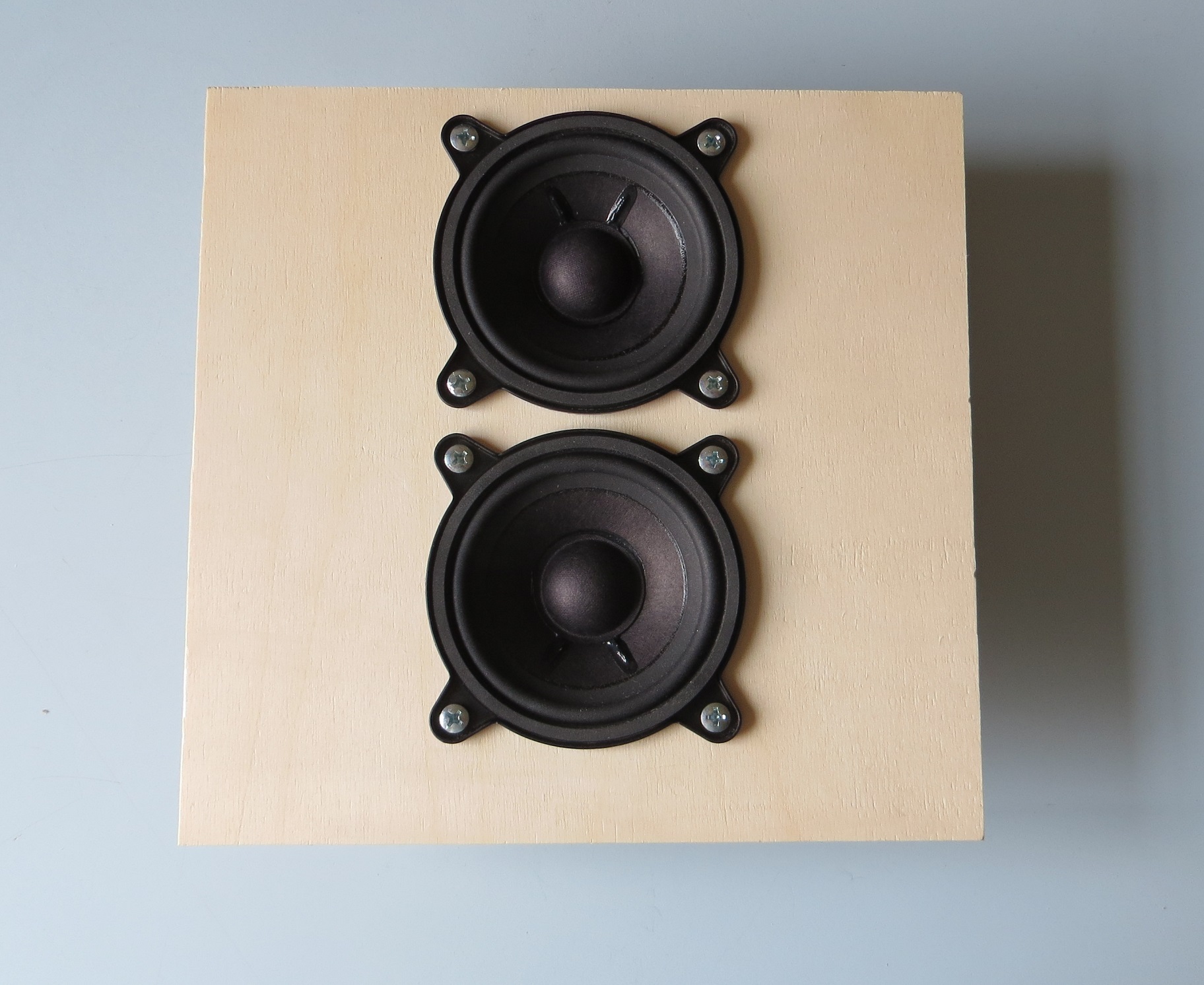

The second speaker of the pair was completed last Friday. I've listened to them for most of the weekend and I'm very happy with the sound. There is decent bass and super mids and highs. It sounds wonderful for such small boxes and when I close my eyes, I can imagine listening to much bigger speakers.

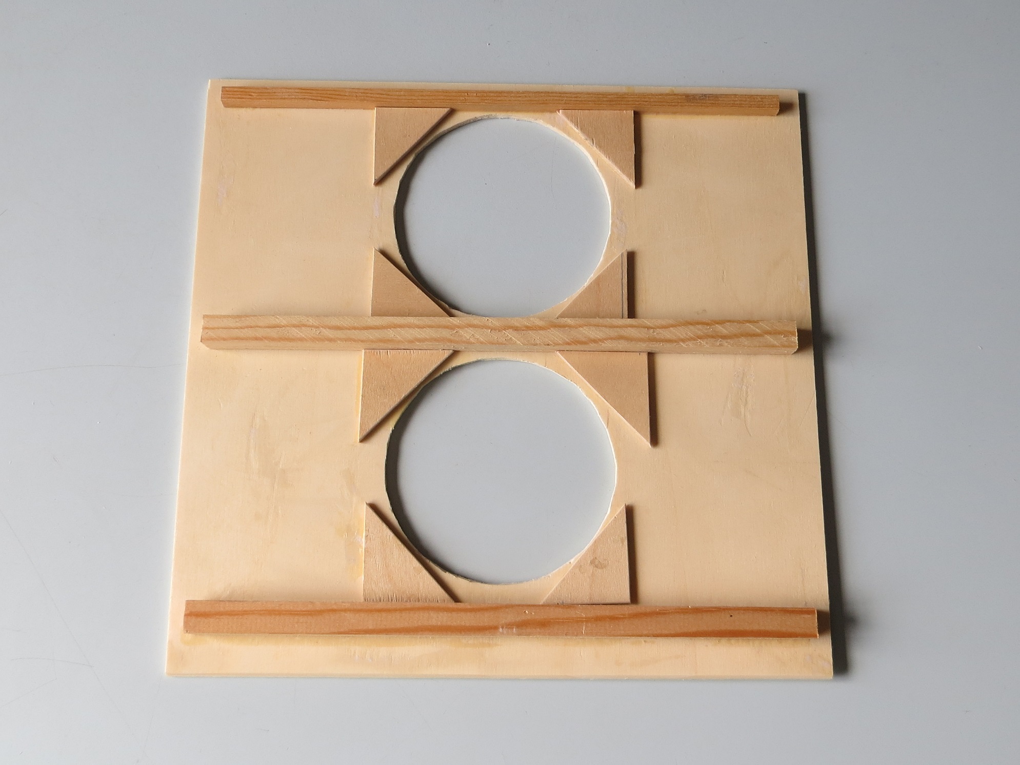

The driver plate has a yellowish color because it is made of 3mm Liteply to carry the weight of the two ferrite drivers. It's much stronger than coam core.
Beautiful implementation Skylar! That liteply looks like the wood they use for small airplane models and 3D jigsaw puzzles. Good idea to use it! Glad the sound is living up to expectations. The TDA7297 is an excellent amp - I believe internally it is a quasi complimentary topology, which probably contributes to the nice sound signature.

You're right. Liteply is used extensively in aeromodeling. That's one of my hobbies and also the reason that I had some on hand. Same with the square spruce that I used to stiffen the driver plate.
