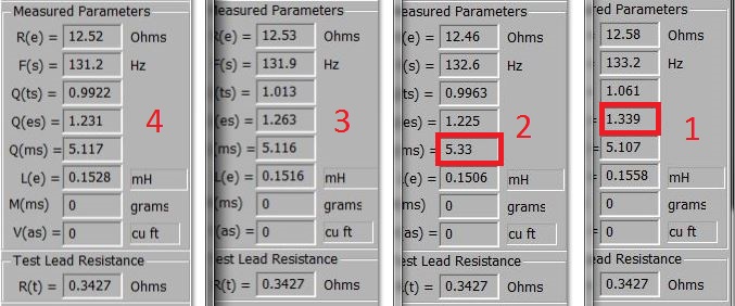

I have the speakers and can provide some data from DATS v2 software, if that helps.
advertised - param - measured
110 . . . . . . . Fs . . . . 133
12.3 . . . . . . Re . . . . 12.5
0.82 . . . . . . Qts . . . 1.093
1.0 . . . . . . . Qes . . . 1.393
4.85 . . . . . . Qms . . . 5.074
0.1 . . . . . . . Le . . . . 0.1547
The numbers have very small differences between speakers, and even smaller differences between runs. These are new-from-box, and not yet run in in any way.

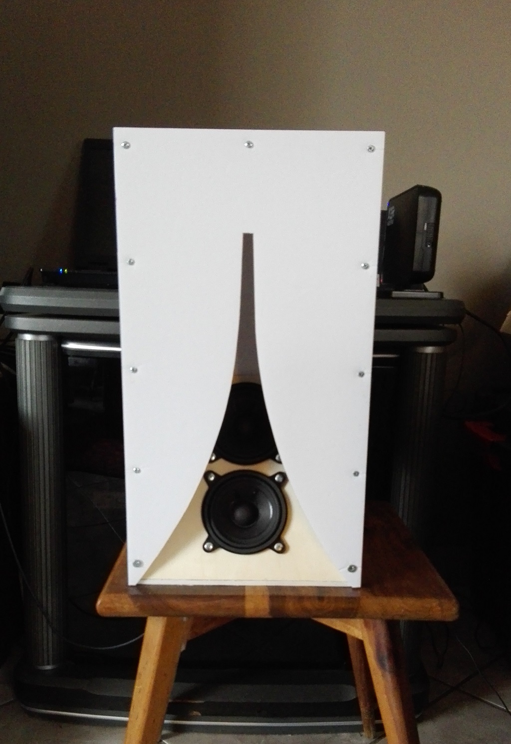

Yes, there is stuffing in the vertical cavity formed by the internal baffle shape above the drivers, and thin felt (probably too thin) in the places indicated in the plans. Since this was my first speaker build, I have no idea if the stuffing is enough or if more stuffing will tame the high frequencies. If it does help with the highs, it will be a better solution than using a baffle step, because the BSC definitely causes SPL loss.
I'll probably use thicker felt when I build LitePly boxes. Already bought 4mm LitePly.

I'm in the process of finishing my test box, and it's looking good. hope to finish it by this weekend, and then get more foam board for the run-for-score!

Ok, after 2 days of playing static at a fairly quiet volume, the final values are in. The question is that two of the drivers have slightly different values (see red boxes in the last two (#2 & #1)), but I'm not sure if I'm being anal, or if there is something here to worry about (order a spare driver or two and return these, or...)
Is there a 'right way' to group these in pairs for the Karlsonator foamcore boxes?
I wouldn't fuss too much over these small discrepancies... Re, Fs and Qts pretty much match.
Just start building. 🙂
+1 they look good and since design is quite forgiving, don’t worry about it. Matching Vas and Qts so that left and right channels have same average values are probably the ones to look for if you insist on some reason to do so. Start building!
Thanks perceval & xrk971, just wanted to make sure things were not too wonky. I'm not particularly familiar with this territory, so I though I'd seek a guide. Moving onward, in my copious spare time...
