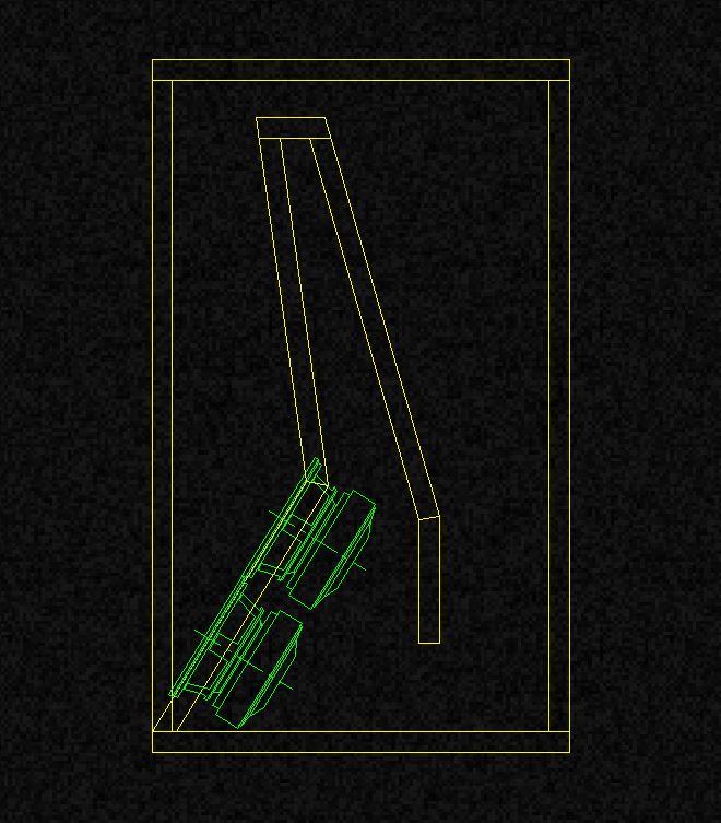

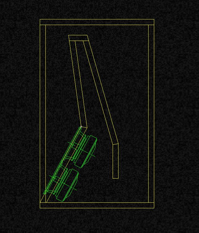

X, how did you fit dual 3FE25's in the 0.53x cabinet?
I've drawn it in CAD and they don't fit. The cabinet height inside is 381mm according to the Karlsonator 0.53x for dual TC9FD drawing. Is it ok to increase the height or should I make the driver panel higher? Btw, I'm going to use 12mm MFD. If a cabinet from foam board sounds good, I suppose it's ok to use MFD?

I haven't actually tried just assumed it fits because I know TC9FD fits. Thanks for drawing cad picture. Just extend panel that drivers mount to accommodate. That will change the angle of that board a bit but it is of no consequence.
Ok, great. I will do that. Thanks for the prompt answer. If the magnets on the 3FE25 weren't so big, we could've moved them down even more.

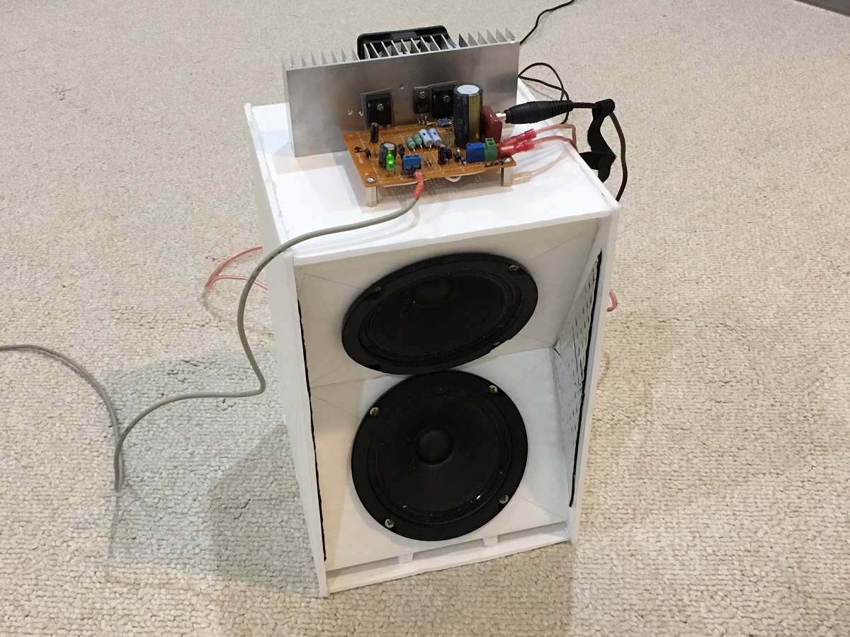

I just tested my ACA with an XKi fitted with dual PA130-8's in parallel (4 ohm nominal load). It sounds great - gets quite loud and the single speaker fills the room nicely. I am thinking that this might just be the next combination for my shop speaker. Driven with a Focusrite DAC, it plays very nicely. With an iPhone - can't get as loud but still enough to be very listenable for a 14dB gain amp. Here is a quick sound clip on this special XKi designed as a midrange/top tuned for 80Hz and not much bass (although you can hear it, it was not designed for it). I don't hear any distortion artifacts or clipping, so I think you are good to go. Check out this mp3 sound clip of the ACA driving a 4ohm XKi. Change the .asc extension to .mp3 to listen.
For those of you wondering what the third device mounted on the heatsink is, that is a 7812 with some resistors to slow down a small CPU cooler fan on the backside of that tiny heatsink to allow this amp to work quietly and cool while not needing a big expensive heatsink.

Still listening to XKi with dual PA130-8's on ACA. Running strong and I have never heard the ACA play this loud and cleanly ever. A 95dB sensitivity speaker really helps.

I may need to do the same since the heatsinks that I've ordered look about the same size as yours.For those of you wondering what the third device mounted on the heatsink is, that is a 7812 with some resistors to slow down a small CPU cooler fan on the backside of that tiny heatsink to allow this amp to work quietly and cool while not needing a big expensive heatsink.
