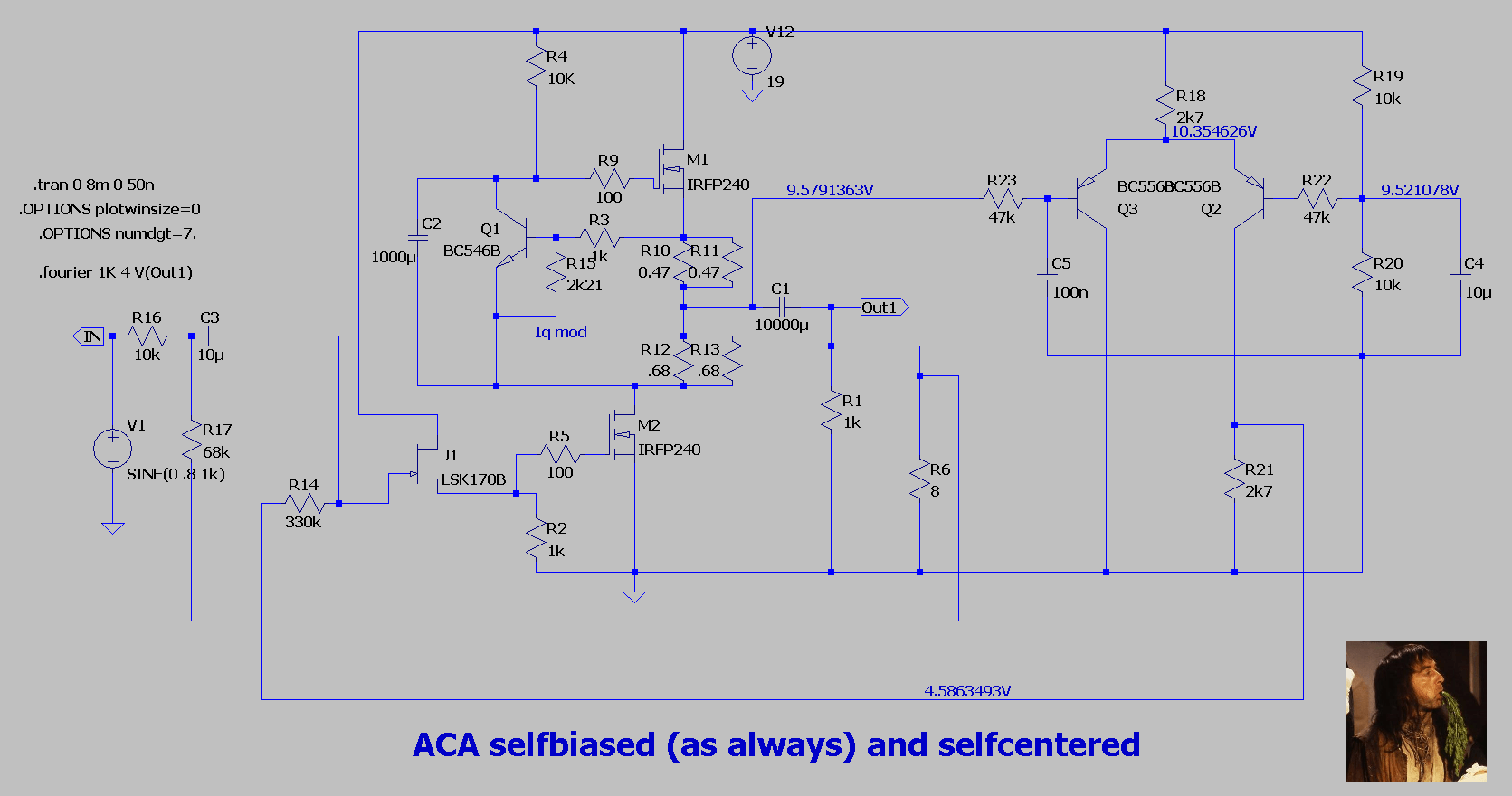

try this on your own responsibility
:rofl:
use ZTX if you have them, instead of weakling EU types shown
it'll have same start-up behavior** as original ACA, if not even better
**farting affinity

ZM circuit in #101 only adds ten new components. Or eight, if you implement a noninverting integrator as your DC servo. Such as Cordell, 2nd edition, Figure 10.6.
Which do you prefer: manual adjustment, or ten more parts on the PCB layout for noobs to stuff and solder?

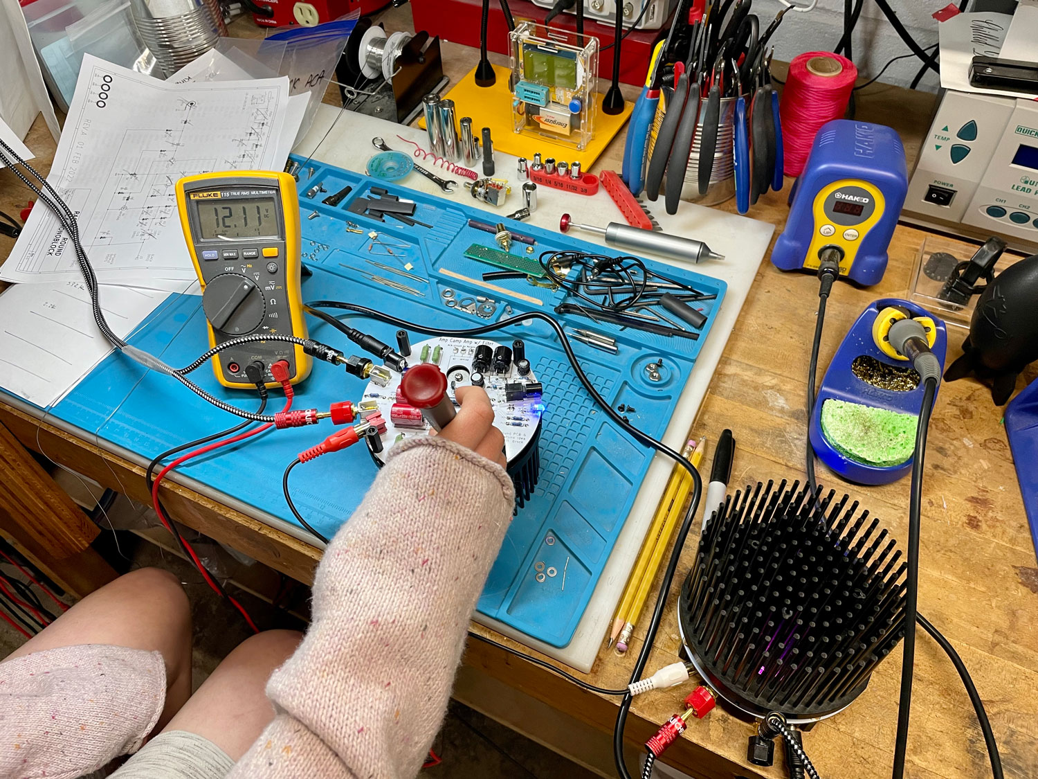

Manually setting the voltage with DMM is required in my humble opinion—if my 11 year old can handle it—and she's totally interested in that part of the process to be sure (loved using the DMM and little clip leads to check resistors)—I see no reason to change it personally. If a new builder has to go out and buy an inexpensive DMM—some places practically give them away with an order—I see that as a good thing personally. Also, they didn't spend most of the $$ for the build on the chassis.... (I do love the OG ACA, and I have 2, so no dig there.)—BUT, this "hedgehog" project is special! (IMO) (Now if I could just get the kid to build the second one...LOL. It will happen—she's got a busy schedule.)

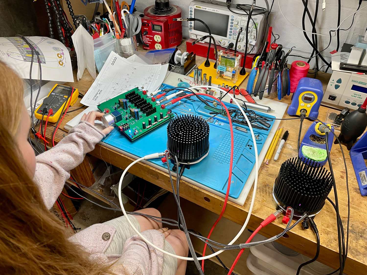

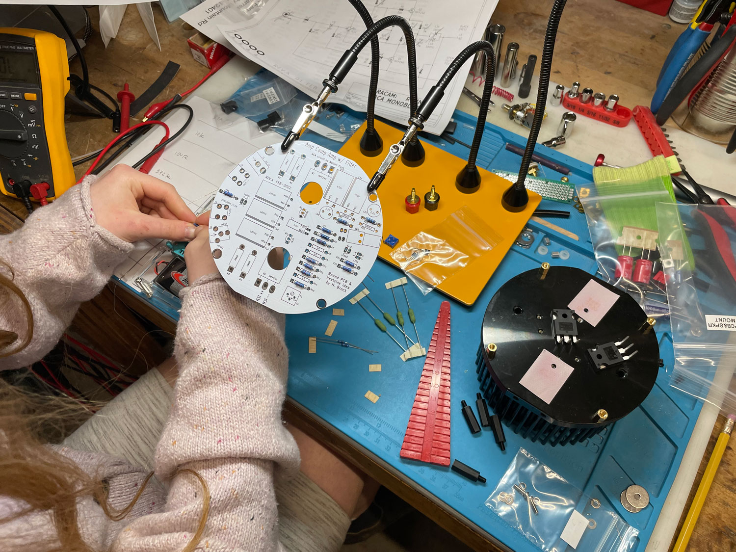

Okay.... Finally got the kiddo to do that last 10 welds on the first monoblock... fired right up with no drama and she set the voltage. Definitely wanders pretty crazily until things get warm and then it all stabilizes. Then she built the second monoblock while we listened to the first (Taylor Swift)... took half the time! Start to finish maybe an hour and a quarter...I really didn't do much, she just got about measuring resistors and stuffing... She was pretty enthusiastic after hearing music from the first one—I'm pretty sure she wasn't 100% understanding what she was making until the tunes flowed, LOL. We did a little taste test from the iPod direct... then with ACP+ (her first project). What a difference! They sound fantastic. Good learning all around.

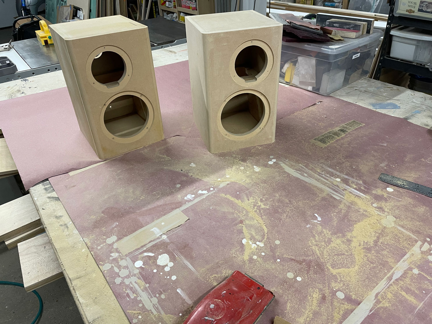

Ha! Thanks. Weather is warming—paint is possible... should be able to finish these up—see pic—unexpected gift from a friend! way too long ago—My daughter (Poet) will do the soldering for the Xovers. She's building these next: OSMC.
(Just kidding—we already built those, well, I did...)
