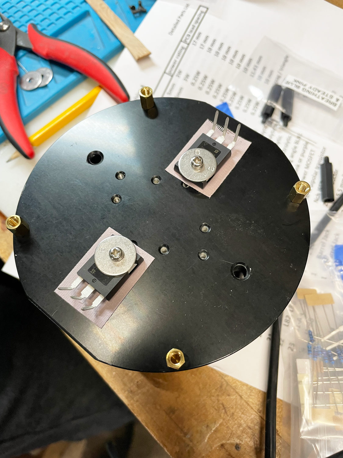

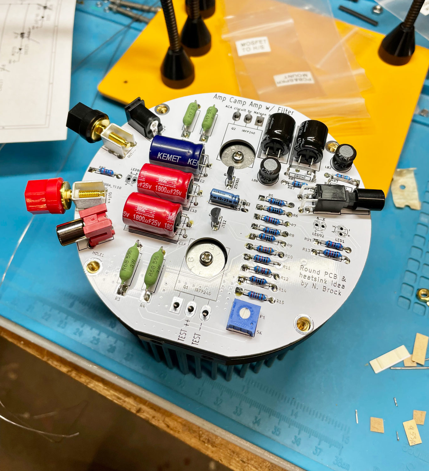

All I did was buy a similar looking heatsink (sales link in post #34 of this thread), and wait for it to arrive from China. When it was delivered, I simply measured its dimensions and drill-hole pattern with a cheap digital caliper. Then I laid out my custom PCB to match that heatsink. A typical and standard DIY approach. I included plenty of slack & slop in my mounting holes, just in case the super low cost heatsink wasn't machined with the same precision we've grown accustomed to from high quality suppliers like ModuShop / HiFi2000.
The PCB fab house calculates their price, based on the size of the rectangular bounding box they extract from my Gerber files. Their software says my Gerbers (circular board) are enclosed by a 120mm x 115 mm rectangle. Which seems correct to me.
ACA with J112 and a SMPS filter built-in? AND a place to put a couple of nifty LEDs to make the heatsink glow a little? This is awesome! :yes:
Seriously, I love the way this looks!

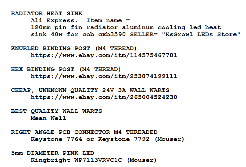

No idea. I bought stuff with wild abandon and in a big hurry. A large amount of it (e.g. M5 threaded speaker posts) turned out not to be usable. Bought from Ali Express, eBay, Amazon, Mouser, DigiKey. "Bought" from my own storeroom of components. Maybe some day it'll become important to calculate a total cost figure, but there are a few hurdles to clear first.

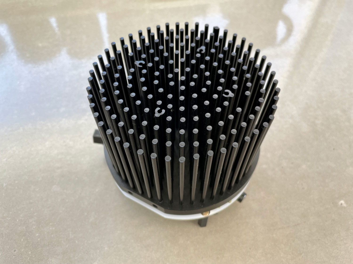

Same diameter for the pin heatsink ?
I can confirm, Mark's heatsink is the same as mine.

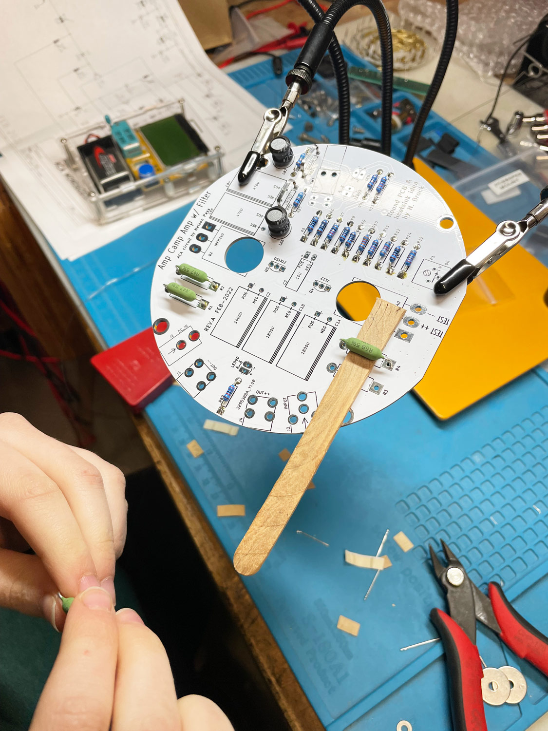

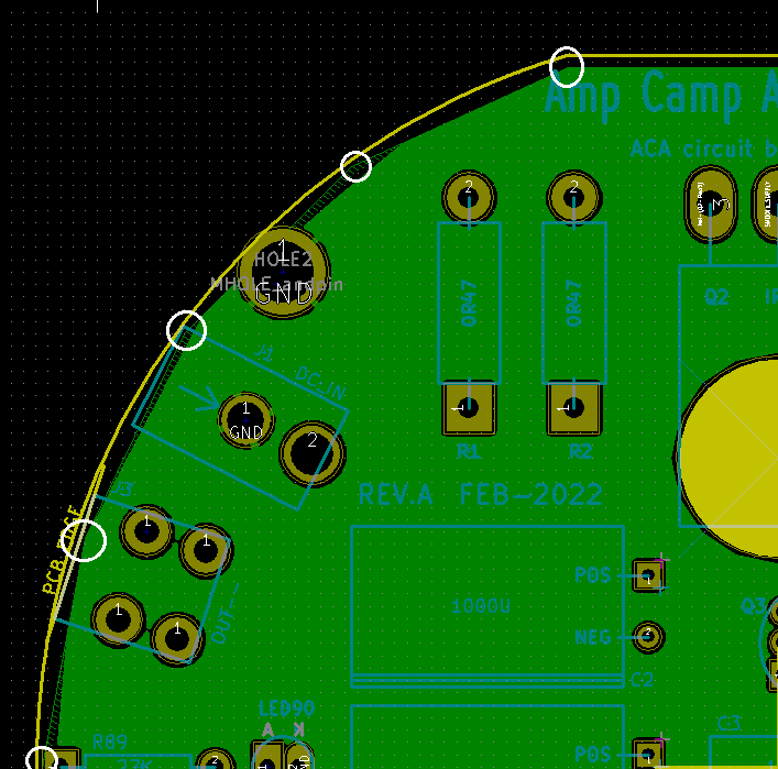

1. I couldn't figure out how to make my PCB CAD package do a circular "zone fill". So instead I inscribed a 20-sided polygon, within the circular boundary of the board, and told the software to pour copper (connected to node GND) in that polygon. A picture of the top left quadrant is shown above; the vertices of the polygon are circled in white. This is kind of a filthy bodge but it actually worked.
2. Some of the components were slightly unusual, and were sourced from unusual vendors. The ones that come to mind at the moment, are shown below.

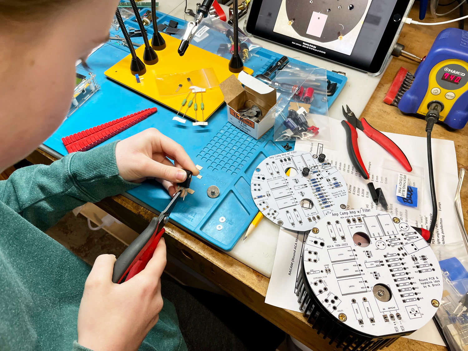

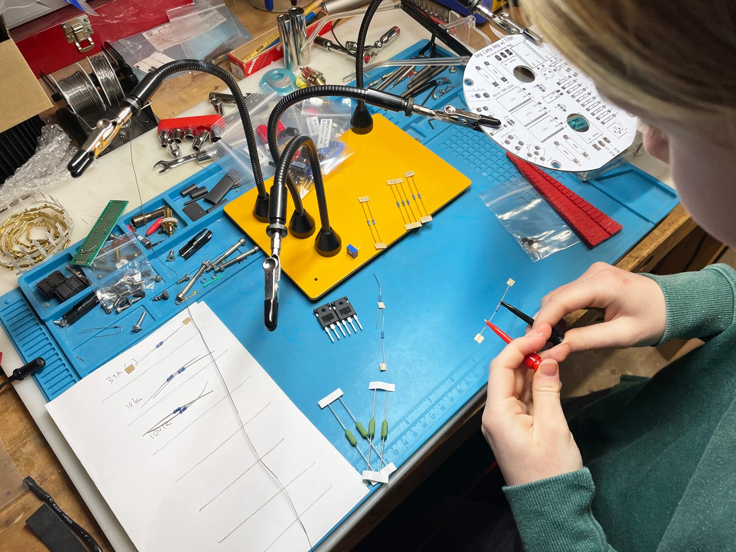

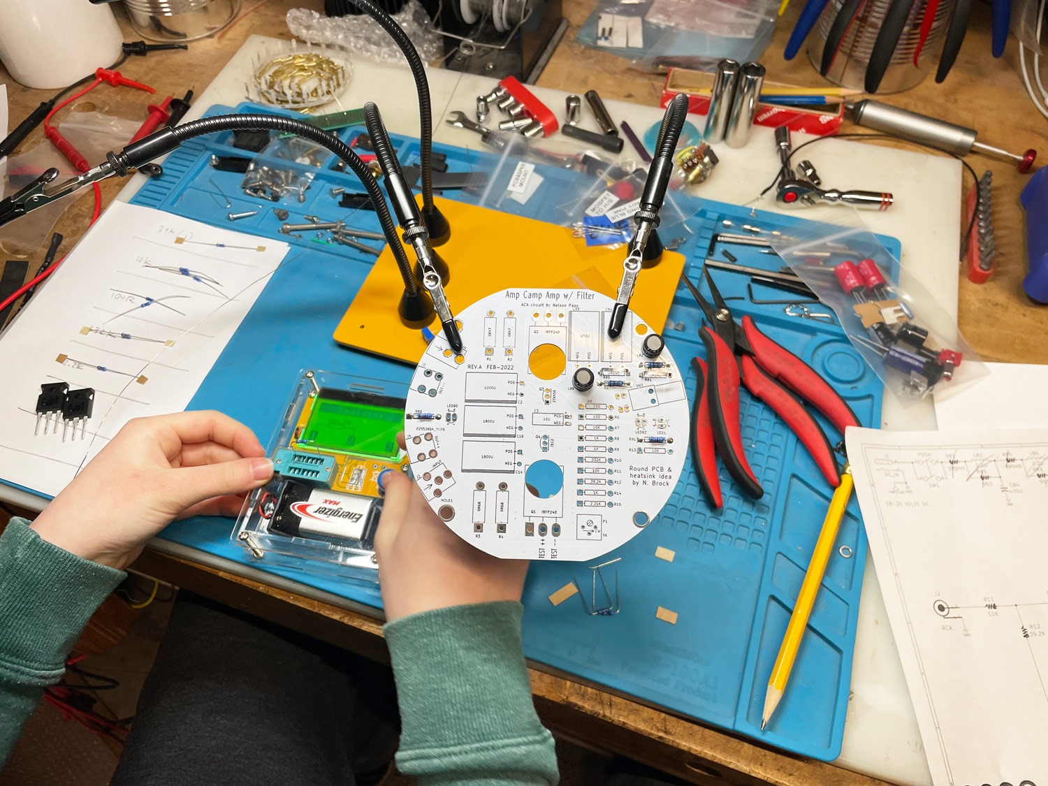

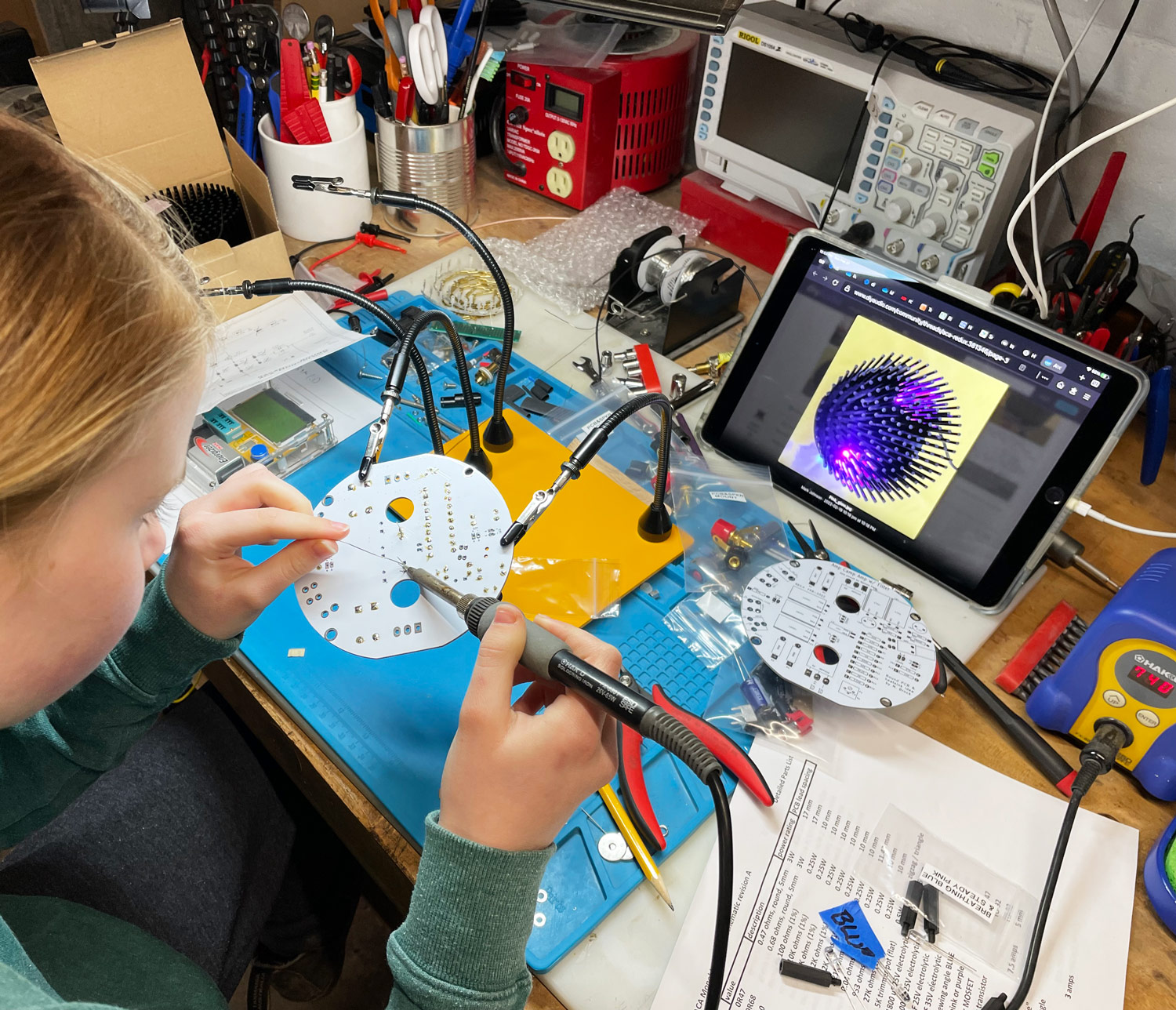

Here's my 11-yr-old daughter starting and almost finishing (Lunch then playdate) one channel (Still have to solder LEDs and mosfets). I had zero involvement in this other than critique on soldering skills and lead bending and general process to build good habits. It's not her first project but it's been a while....
Hopefully some listening later—Will report back with more. The "plan" was that I would build one of them and she the other... apparently that has changed, as I'm not allowed to build the other channel now! I will take that as good sign. She's very proud of her work.
Might be a week before we can complete the full build... school etc.
