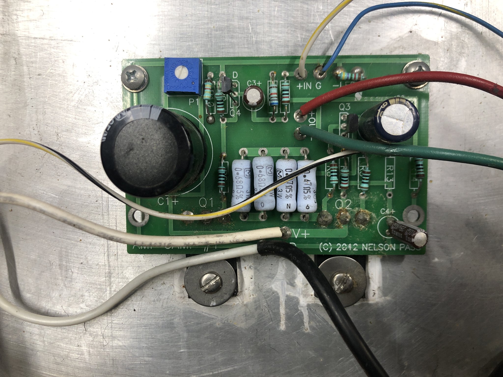

Post some well lit and focused pictures of the amplifier showing all wiring and connections and pictures of the board.

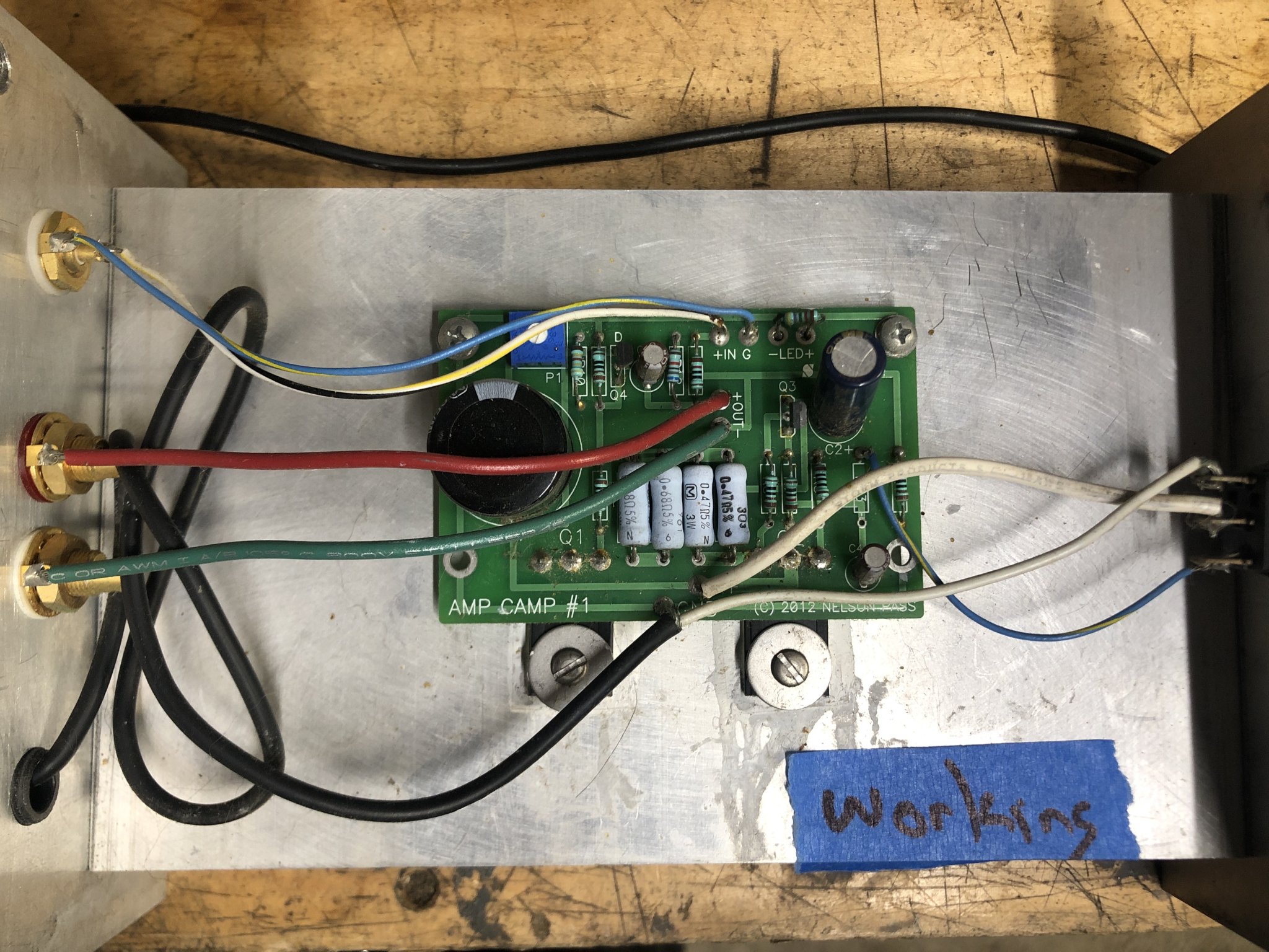

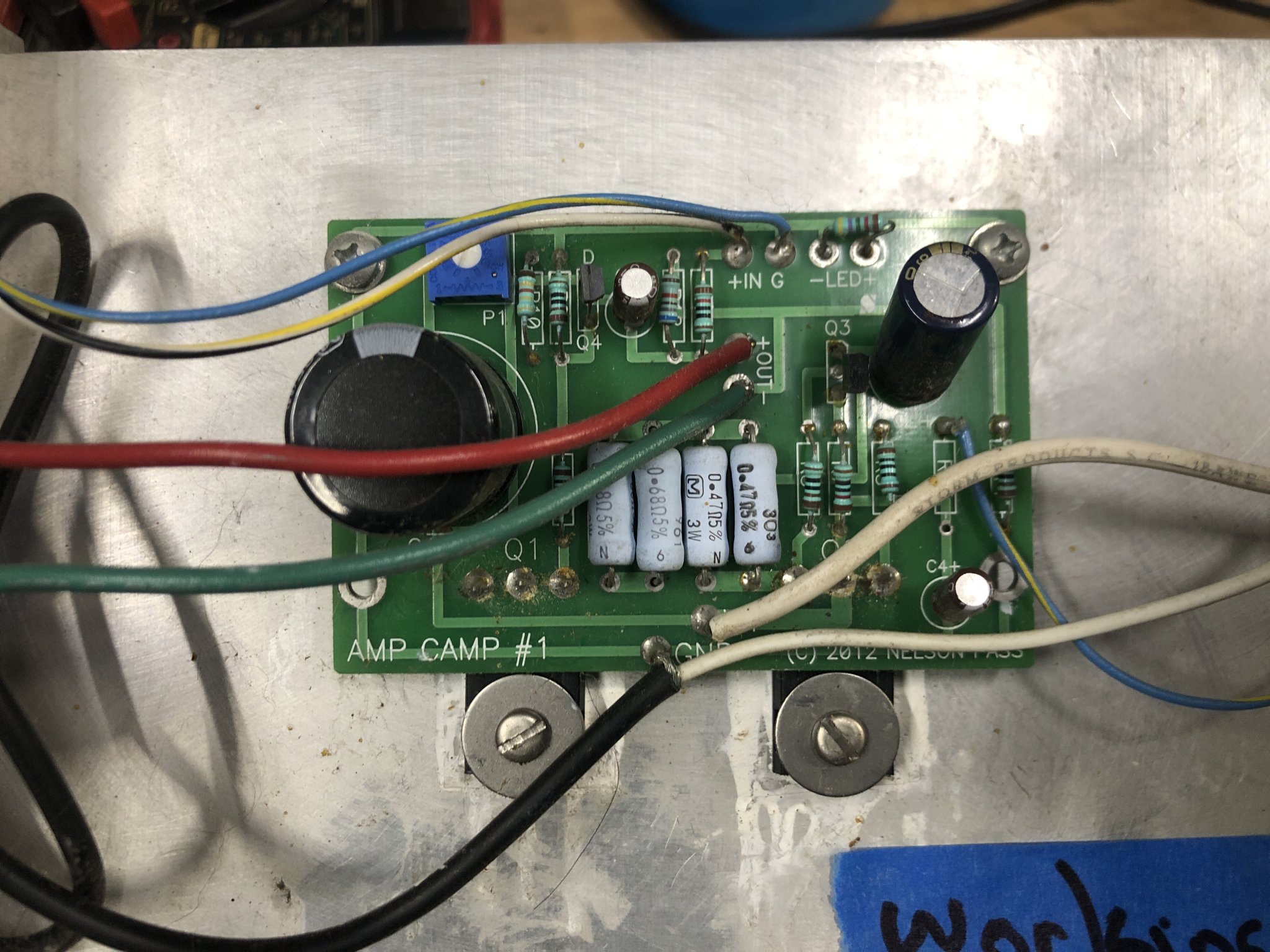

Here are pics of the two boards.

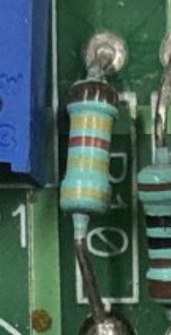

The wire is not broken. If I set the multi meter at 2000k it reads around 275. This amp was working for the past 10 years and just stopped. It is built into a cabinet that does not move. So it should be safe from physical damage. I think something must have burned out.
You can't measure the resistance of R10 when measuring across the resistor while it's in the circuit.
