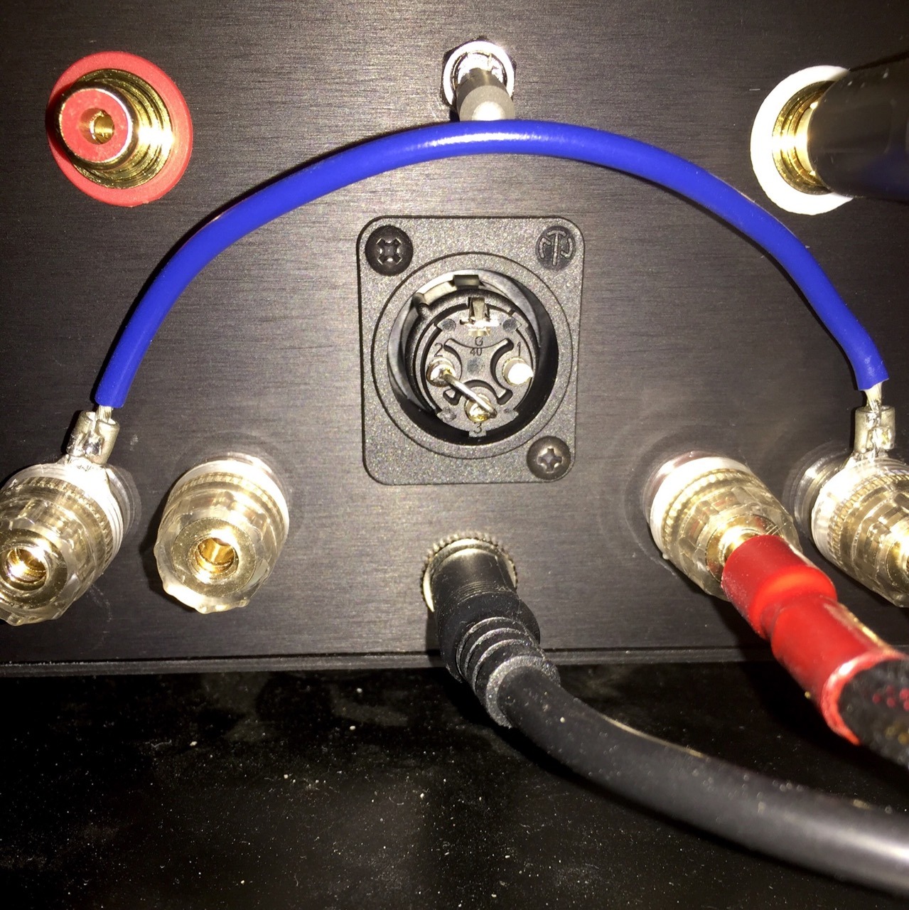

At last the stars alined. I had time, parts, supplies and equipment to complete the repair. The ACA's are back doing their job entertaining me upgraded with the added resister. I'm planning to listen for a while then upgrade the power supplies. For now they are currently set up in my shop and sounding great.
It's been a fantastic experience to fix something that was broken. In someways this was more satisfying than the original build.
Thanks to Mark (Variac) for supplying the components and everyone else for their keen eyes and sage advice.

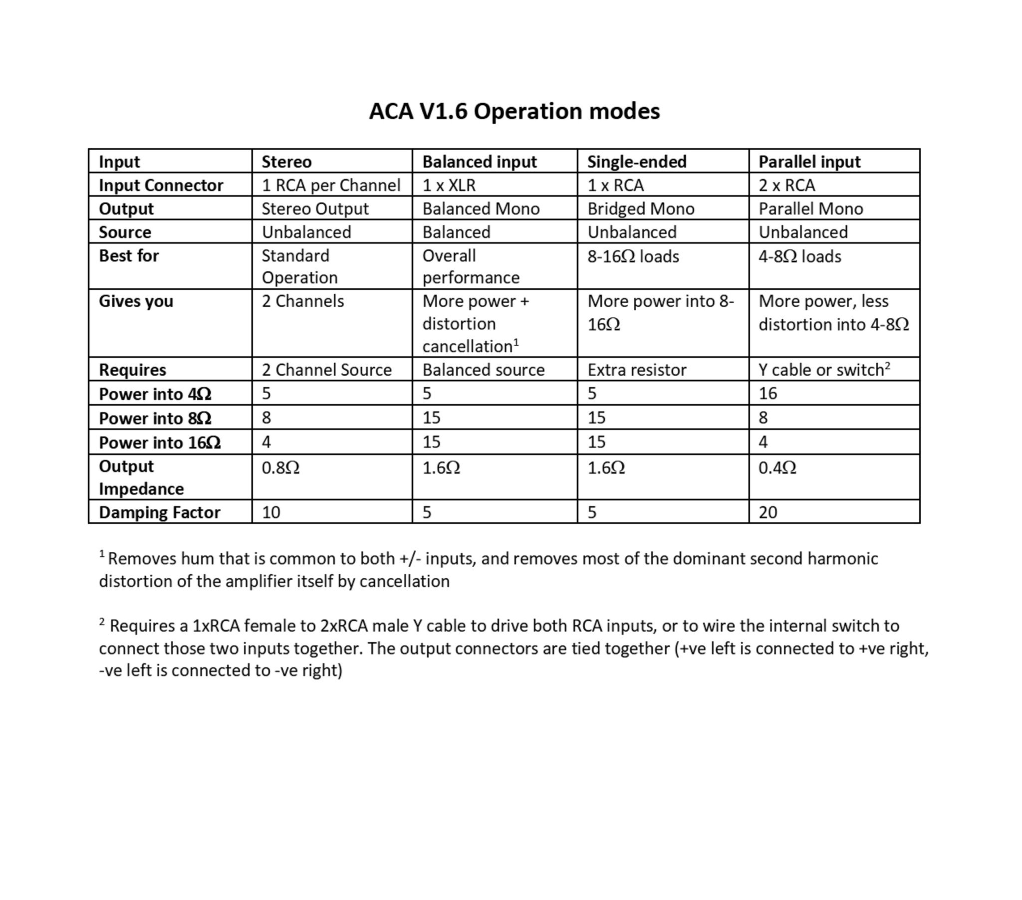

Either a balanced or a parallel connection will do that.
It mostly depends on the impedance of the speaker you are going to connect.
For 4ohm - parallel
For 8ohm - balanced.
But it also depends on how sensitive the speaker is. 92 and above dB will be ok in both cases.

Perhaps it's a difference in reading, but ...
The configurations in the build guide and as described above don't apply (or at least not directly). The situations in the build guide account for running one amp to power one speaker or one amp to power two speakers. I am confident that you could use two amps to power one mono speaker, but I'd gather more information.

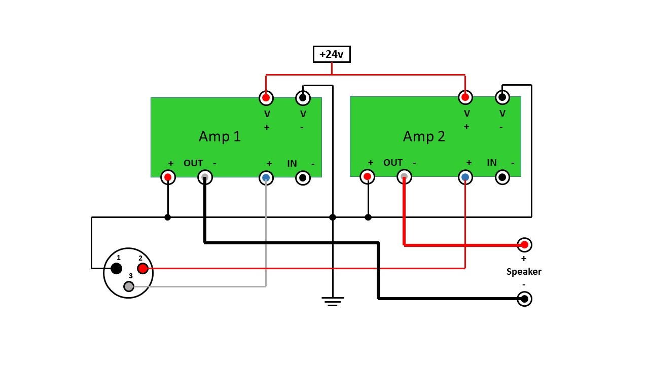

Two amps to power a single speaker... is biamping ... and in what I'd personally consider a fairly unusual way.I'm interesting in using these two amp to power a single speaker in mono.

Either parallel mono or balanced / bridged mono will drive a single speaker, being that FR or multi way.
For that you need 2 x ACA connected together for the right mode.
You'll find all the answers in the above files and links.
Bi-amping OTOH needs an additional external xover, usually active, to drive a multi way speaker.
I'm sure other people will chime in and provide extra clarity.
Hope this helps.
