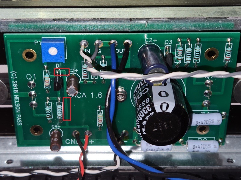

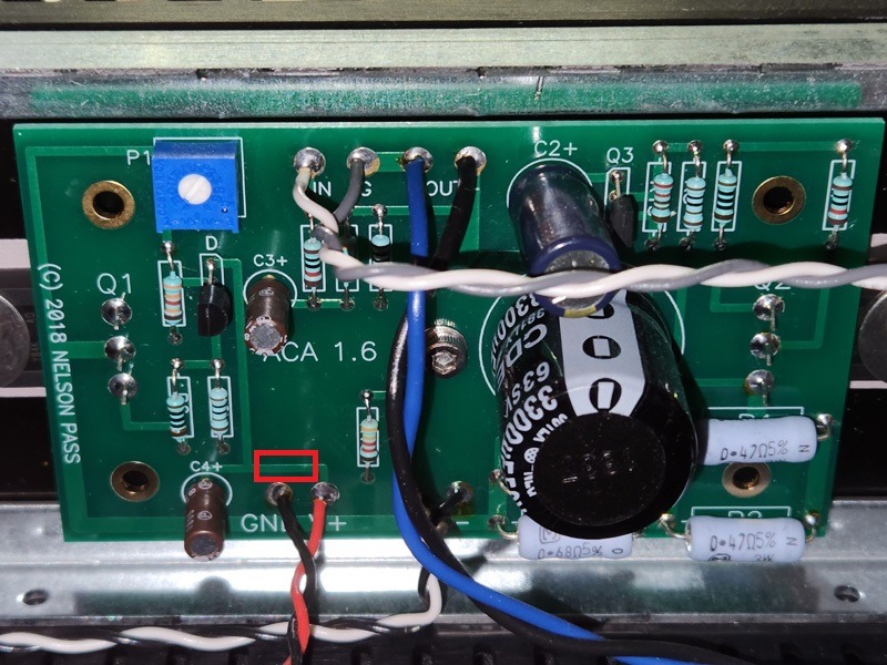

This trace cut, I've read about it but am still not clear. Would it be at either of the two red boxes below? I think the lower one would be easier to work with considering the actual size of the parts. If it's somewhere else, let me know. Thank you!
Someone had better second this?
yellow line is a break in the track
R between red boxes
see attach image
R between red boxes
see attach image
No... that's not where I'd cut.
Post @1212 doesn't have an attachment, so I'm not sure if their advice is correct or not.
Mainly... If I were to cut, I'd cut cut between the rail and C4...
Neither of the red boxes are correct.
The new component R16 must be added between V+ and the positive lead of C4. The trace cut should be made close to the V+ wire mount. R16 effectively bridges the cut.
As a clarification, the new C101 is a small 10 pF cap added in parallel with R12.
Okay, I am definitely getting these mixed up.
For the record, as near as I can tell:
R12: the values changes from 39.2k to 90.9k and gains a parallel C101 which is a 10pf silver mica cap.
R16 is new and is added between V+ and the positive lead of C4.
Other notes in this thread mention that R16 can benefit from a parallel 100uf 50V cap.
Finally, I believe R16 will have an effect on the drain of Q4 since there is now resistance on that line.
This makes sense to me now after reading post #928 where Tungsten said, "...I would probably cut the trace rather than trying to lift one leg of Q4."
So the cut goes somewhere along the new red box area and R16 bridges the connection. (Picture...thousand words...etc.)
If not, the comedy show will continue!
Thanks to all of you for your help. The answers and references really made a difference.

This one looks good.
Check the other side of the board and see how V+ is routed to the other components where it is needed. Just for your understanding.
When cutting the trace on the top side, be careful not to use too much force. Inspect your work with a magnifier to confirm that the connection has been severed.

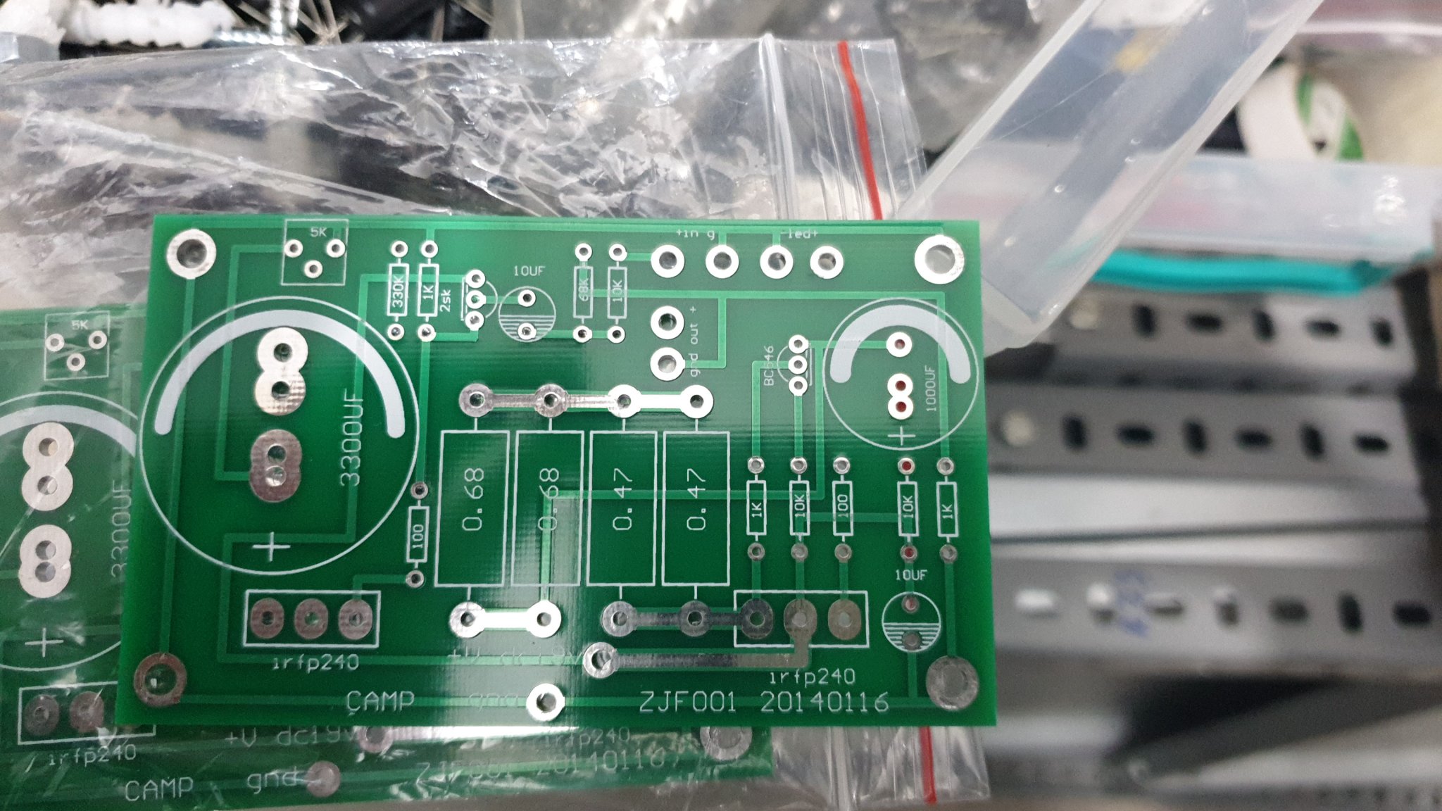

That is a different PCB, likely sourced from China. With no acknowledgement of Nelson as the designer.
You are on your own with that one.
