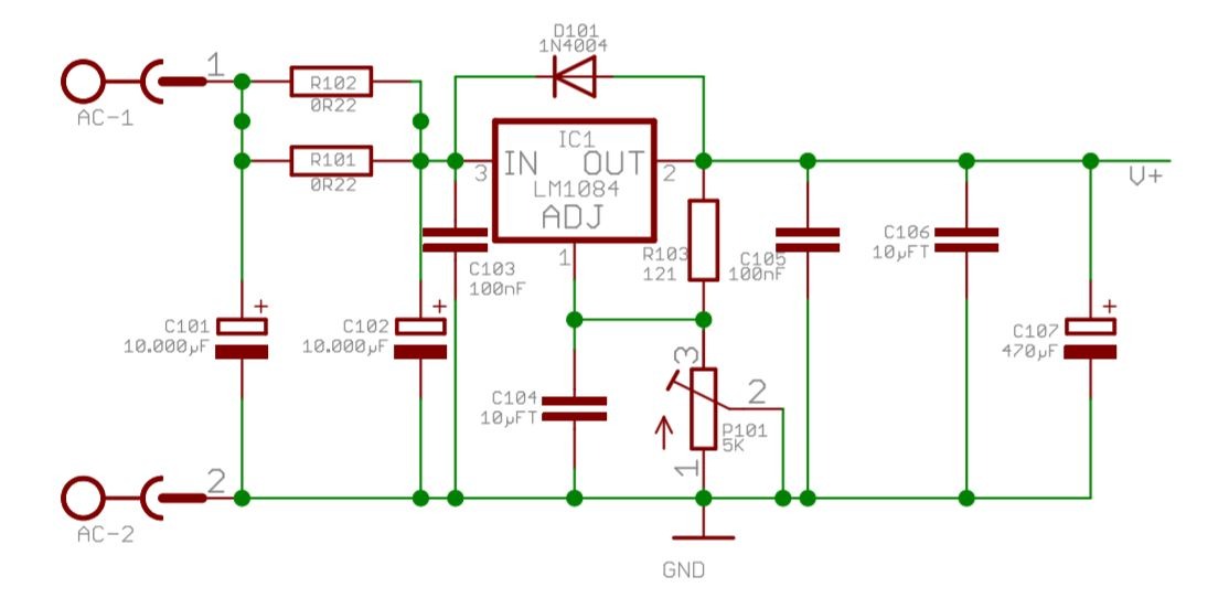

It is my considered opinion that the ACA sounds much better with a linear CLC or CRCRC supply. (Without an LM1084 or other such regulator.)
I have tried the regulator approach and found it lacking in bass extension and definition. I have used the set of PCBs from Rudi with the the regulator eliminated, and bypassed with a thick copper wire between pin2 and pin3. The regulator support components are also omitted. In this case the 0R22 resistors were 3W metal oxide (film) power resistors. Wirewound power resistors would also work in those locations.
I have tried a sufficiently sized Meanwell chassis mount SMPS set to provide 27V to the amplifier channels. It also sounded inferior to the linear supply when compared side-by-side.
A 300VA transformer with dual 20V or 22V secondaries makes a good choice for the ACA. Each secondary provides the raw AC voltage to each channel. Sounds like a good dual-mono implementation.

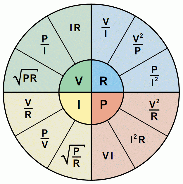

Using Ohm's law we know that P = V x IHello, I have a question. What wattage of resistors are needed for the 0.22 ohm? R101/R102 in this Lm1084 regulator circuit?
therefore P = I x I x R
assuming that I = 1.5A calculates as
1.5 x 1.5 x 0.22 = 0.495W
for piece of mind a 3W resistor will be just fine
