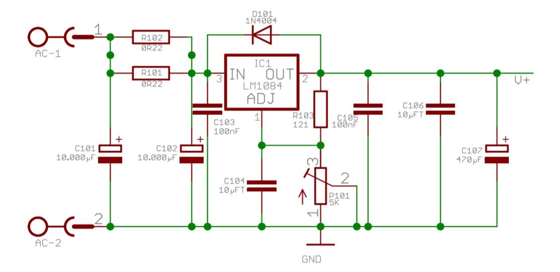

Gentlemen, I have a pair of the "Premium Parts ACA" - PCBs, the PCBs that TungstenAudio is evaluating, left (image 1) and will offer it to you.
I will include a pair of MUR8x0 full-bridge rectifiers as well (the PCB on the right side of image 1, which can be easily broken apart).
I have included images of the used schematics (images 3 - 5).
The assembled ACA-PCB will finally look a lot like on image 2 (showing the phase of adjusting the quiescent / bias current).
In my opinion Mr. Nelson Pass' ACA is an amplifier that "begs" for a regulated PSU (needing 1.4A - 1.8A of current).
This is the reason why I have inserted a LT1084 voltage regulator (adjusted to 24VDC) on these PCBs.
If you are interested to have these 2 PCB-pairs (2 x ACA + 2 x full-bridge rectifier: I offer them for 15€, worldwide shipping included): give me a PM.
Best regards - Rudi_Ratlos
Hello, I have a question. What wattage of resistors are needed for the 0.22 ohm? R101/R102 in this Lm1084 regulator circuit?
