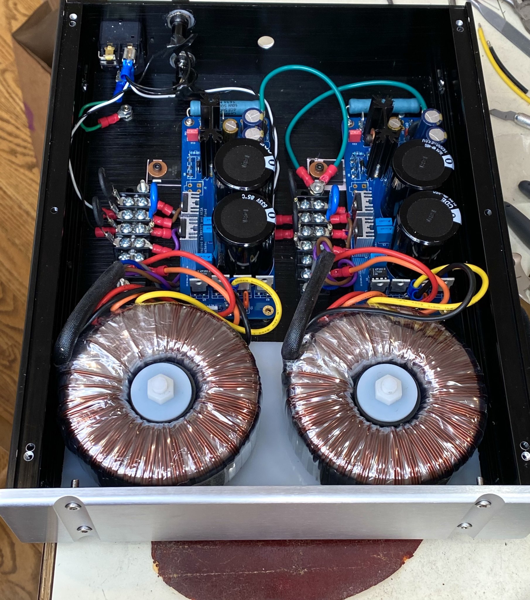

I think the final frontier would be to make some outboard 36v linear power supplies with some decent reserves..
Oh, and I need to adjust the resistor on the LED's at the new voltage... they are bright!

My higher voltage ACA builds have used very traditional linear power supplies; 300VA transformers, 24V secondaries, CRCRC filters. I did try a chassis mount Meanwell 27V SMPS in place of the linear rig, and it fell a little short in bass extension and definition.
The latest VFET amps use a larger 36V brick style SMPS, which look promising for the ACA if used with an appropriate filter. These are available on the store. It is a good, easy way to have a great sounding VFET amp without having to build your own PSU. And if you are willing to build your own dual channel linear PSU, it can make the VFET amp sound even better.
There are some newer chassis mount SMPS from Micro Audio that also look promising, but I haven’t tried one yet. Only a couple DIY builders have reported on their use.
For the time being, I remain convinced that a carefully built linear PSU will sound superior to the commercial SMPS units. More effort, worth it.

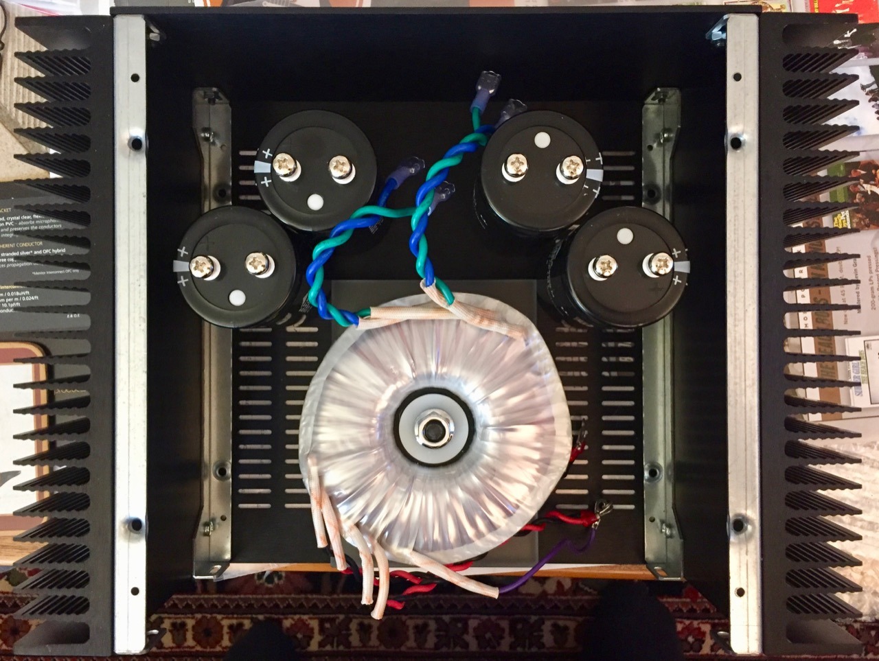

And... I am all in on building a dual mono 36v linear power supply like the one Tungsten has pictured above! Where do we start?

The basic, and certainly one of the best performing ways to construct a linear PSU is simple point-to-point. No PCB required. Fine examples of this exist in several threads. There are PCBs avaiable if one feels so inclined. They generally do not impose voltage or current limitations on their own. That is a matter of the capacitors which have been selected for the job. The Universal PSU boards on the diyAudio store may be pressed into service for single rail supplies, being mindful of the voltage polarities.
I have used several third-party PCBs for various builds. These have tended to be limited runs offered in the Group Buys forum. That's why I don't often discuss them. No point going into detail about something which isn't available. One variety of PCB which is still available is XRK's Smooth Like Buttah (SLB), which is offered in both single and dual rail. It is a capacitance multiplier, and does require some understanding of how this type of circuit operates for best implementation. I used two of the single-rail boards to build my 36V PSU for the VFET amp, as pictured above.
The choice of what kind and size of PSU to implement is influenced by the chassis in which the amp will be constructed. Or the size one may find available for building an external supply. In the case of the ACA, the basic kit chassis is too small to accommodate anything other than and external supply, whether linear or SMPS. Moving to a larger chassis does offer more options. Have a look at the picture below for an example of a parts fit study in the Mini Dissipante 3U x 250mm chassis. That transformer is the Antek 300VA, 24V.

Yes, the single-rail SLB is what I used in the external PSU for my VFET amp. It needs a transformer with 30V secondary voltage in order to produce an output voltage of 36V. Two 15V windings in series work well.
I also used the dual-rail SLB in my F6. I have built my own capacitance multiplier supplies without the aid of a PCB, so I was already familiar with the circuit. The SLB uses a complementary feedback pair (aka Szklai) for the high gain pass element. It is nice to have these PCBs available to make the job easier. The LT4320 rectifiers seem to work well at reducing the voltage loss due to rectification.
