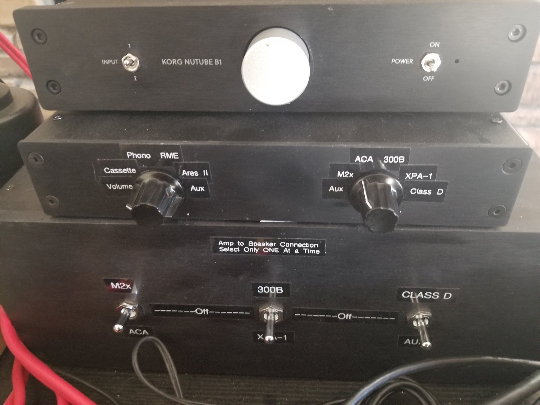

Yes, am building from scratch using the DIY boards and chassis. Here's why I decided to try this -- having already built two of the dual-smps ACAs.
I compare any of four installed amps in a process I term "Active Amp Selection." With this design, I can switch between pure class A (ACA), tube 300B SET, Powerful A/B (Emotiva XPA-1) and the M2X (variable with the selected daughterboard) in under 5 seconds. See the attachment for the two boxes necessary to accomplish this -- one for line in and the other for speaker selection. Consequently, have been doing daily tests on which amp sounds best for which source and/or music type/genre and, also, how the amps differ in sound.
To speak to your question of ACA versus M2X, the two sound somewhat similar if you use the M2x MountainView Class A Daughterboard but I prefer the Tucson DB with the Burson OpAmp. This sounds very dynamic and explodes with punch. The ACA, by comparison, sounds very "literal" as if the music is appearing somewhat "tightly" in front of you. The ACA suffered from a one-dimensional soundstage depth before the RKThatcher CRC filter was added -- then it deepened just a little. But the improvement was so marked it suggested to me that there was room to grow for the ACA boards with a much better regulated PSU -- and thus the new build goal of 2 PSUs for a large chassis ACA with the upgraded components.
Specifics:
The M2x has a much greater dynamic range from ppp to fff. It has more punch than, even, the powerful Emotiva XPA-1. It's timbral accuracy is OK but only OK. And it sounds great with all types of sources -- vinyl, cassette and digital (am using the Denafrips Ares II now for a more analog-type digital sound).
The ACA has the cleanest soundstage of any of the 4 amps with lots of room between instruments/voices and each of them tightly defined. It is the best with crescendos showing a micro-control that pictures the instrument/voice perfectly. If your source is a muddled vinyl record from the 1960s (read: poorly miked), the ACA will "clean it up" better than the other 3 amps. Timbral accuracy is OK but only OK.
The 300B Set amp has spectacular timbral accuracy placing the instrument/voice realistically in front of you. Relative poor damping, however, clouds their placement within the soundstage just a little. Dynamics are very good and all, of course, depends on the tubes being used -- the new Western Electric 300Bs are on my upcoming buy list.
So actively selecting amps for individual musical purpose has genuine worth and my investigations have identified a number of preferable matches that I automatically select whenever listening to that musical source. Worth giving a try.

Craigl59, Wow that is all really cool, it is so great to read those comparisons of the ACA. It really is sounding good! and I think you really keyed into the strengths of what it can do. I agree that a really good LPS is the final frontier. Don't be too hesitant about running 36v, really a super easy change to add R16.
I also love your switching devices, I do like to swap amps from time to time, I have a very early SAE 60w amp that is really nice, being able to just flick a switch based on music and source choice must be awesome.
