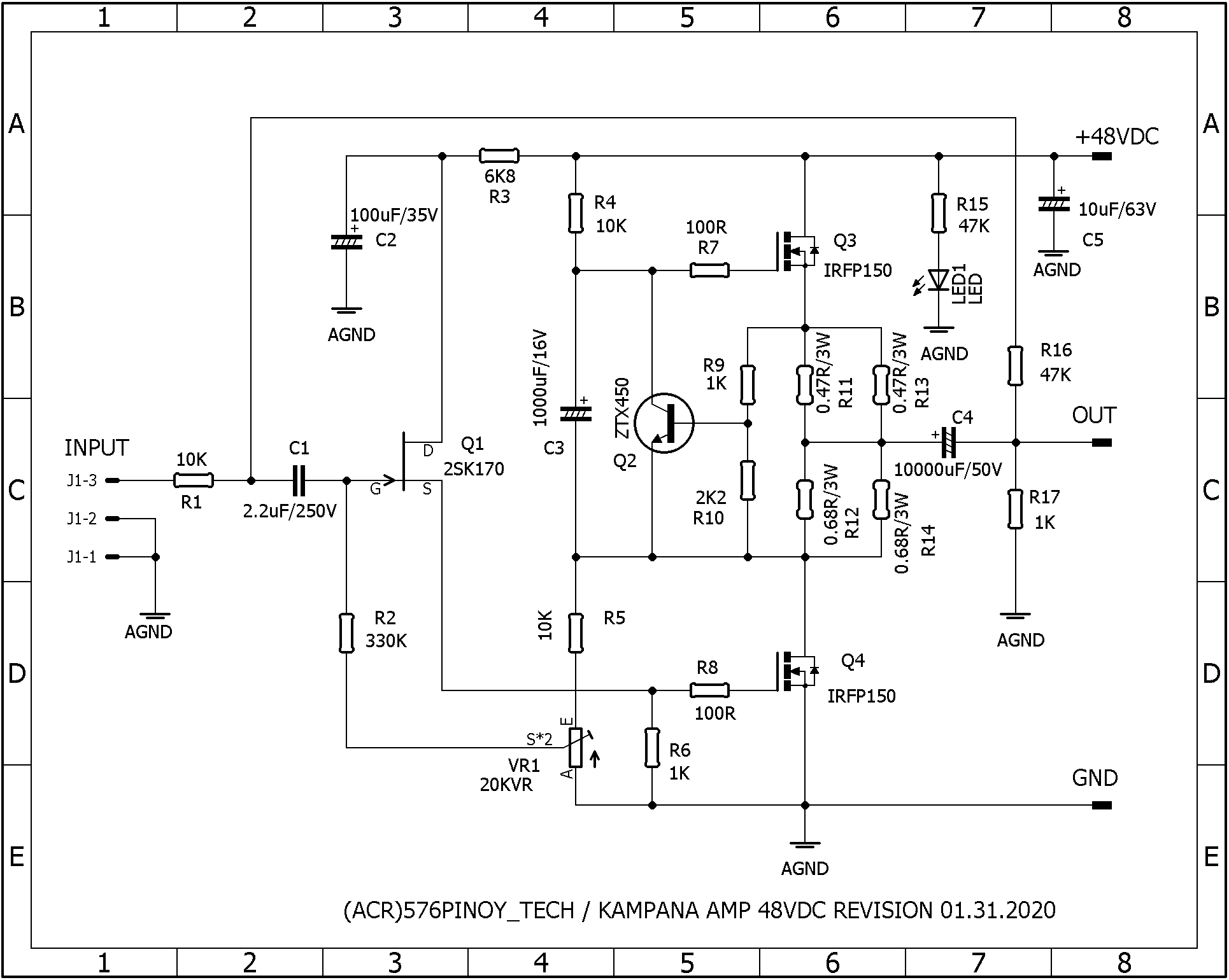

I am sure this has been answered somewhere in the 46 pages, but google hasn't shown me the answer....
This design is so similar to the Zen amps, and there is no PCB available anymore, has anyone put higher voltage parts on the ACA PCB, gave it 50v power supply and gotten results similar to or better than the Zen V4? I see lots about higher quality parts, and even new power supplies, but not much specifically about running the ACA at much higher voltages in the dozen or so pages I've read.
I ask because while I bought some Chinese Zen V4 boards, that was only a few dollars investment, and I am now trying to decide whether Zen V4 at 50+ volts or a pair of custom built ACA (turbo) amps is the right build. What I am looking for is the highest power best sounding single mosfet amp.

SoundWaveSteve:Have built the premium version with upgraded mosfets and supplied a second SMPS -- one for each board. Each at 24vdc with an added 1500uf cap.Have since added the rkthatcher CLC filter to the incoming SMPS voltage. The dual smps ACA amp sounds great AND has enough power to blow you into another dimension -- although I should stress that I am using high efficiency Tekton speakers. Check my posts above in this thread for more specifics.
Sure enough, I saved a copy of that one.
It might be easy to try a 36V version of this using the Meanwell 36V supply that is now available on the store.
