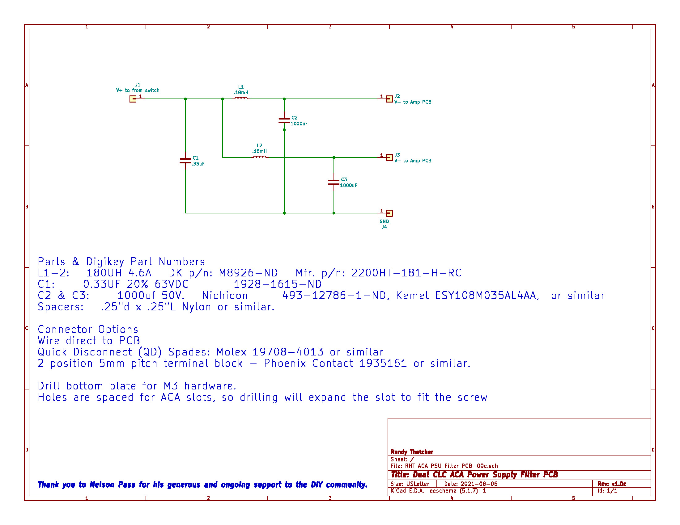

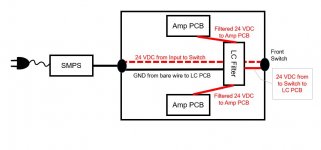

Think I understand now -- that is not a PSU but a CLC filter in rhthatcher's post, right? So the Meanwell goes directly to that and then to the PCB?

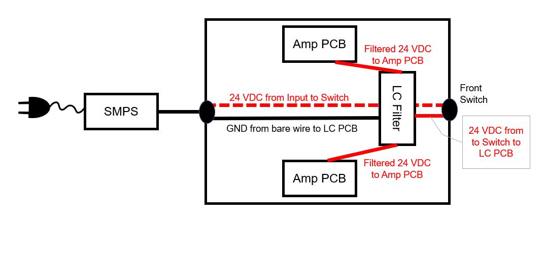

I'm attaching a pic of the concept. The SMPS feed runs through the input jack to the switch, then to the LC filter board, then splits into one LC filter per channel, then feeds each amp board.
Very clear, rhthatcher and thanks again.
Am assuming that each half can be separately wired for an individual smps and, so, the one board will serve for our 2-smps build.

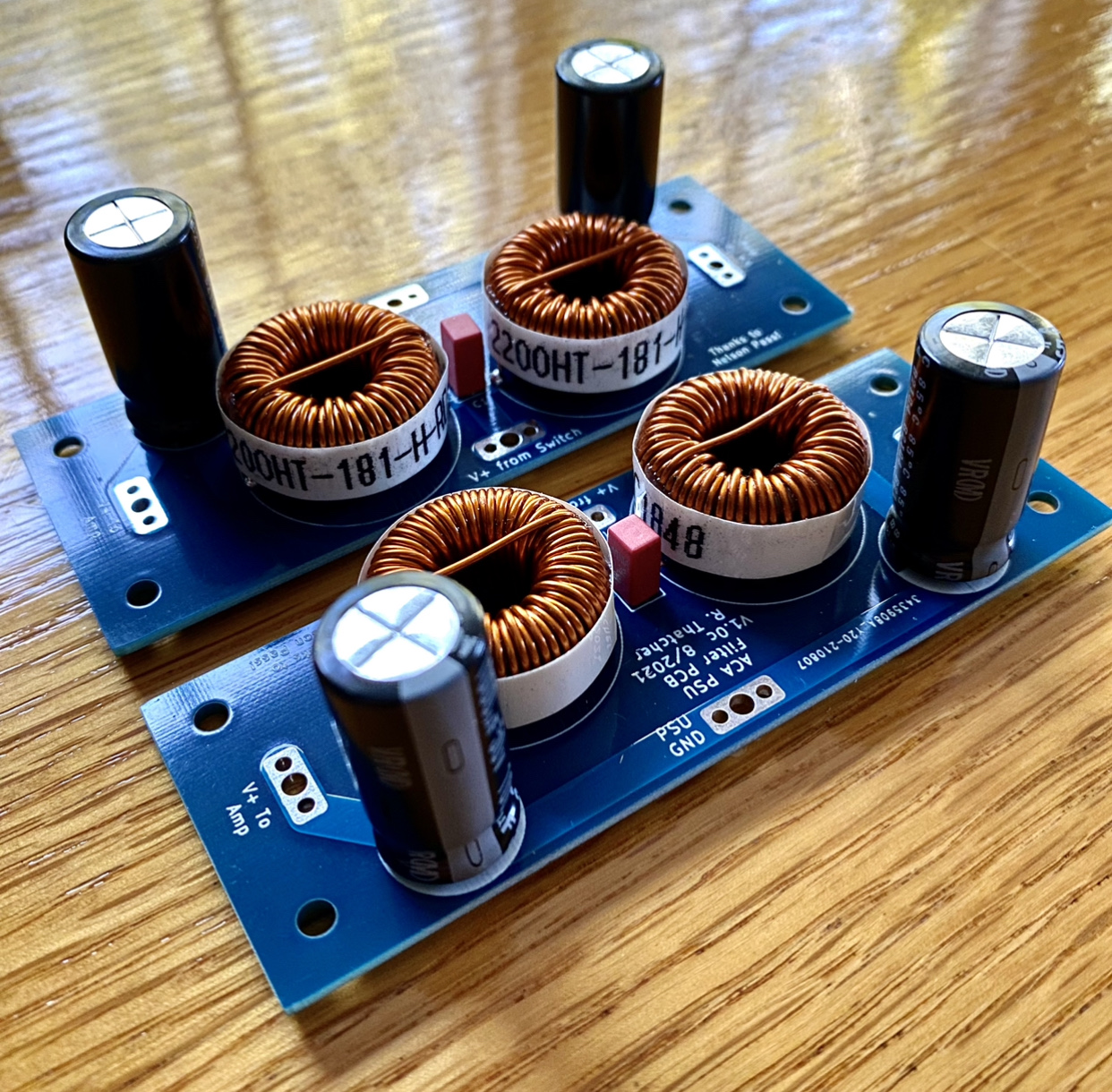

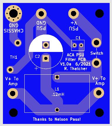

rthatcher: actually, if you make these available I will try one per board on my dual-smps build!
The board in the amps I just build is set up for single SMPS.

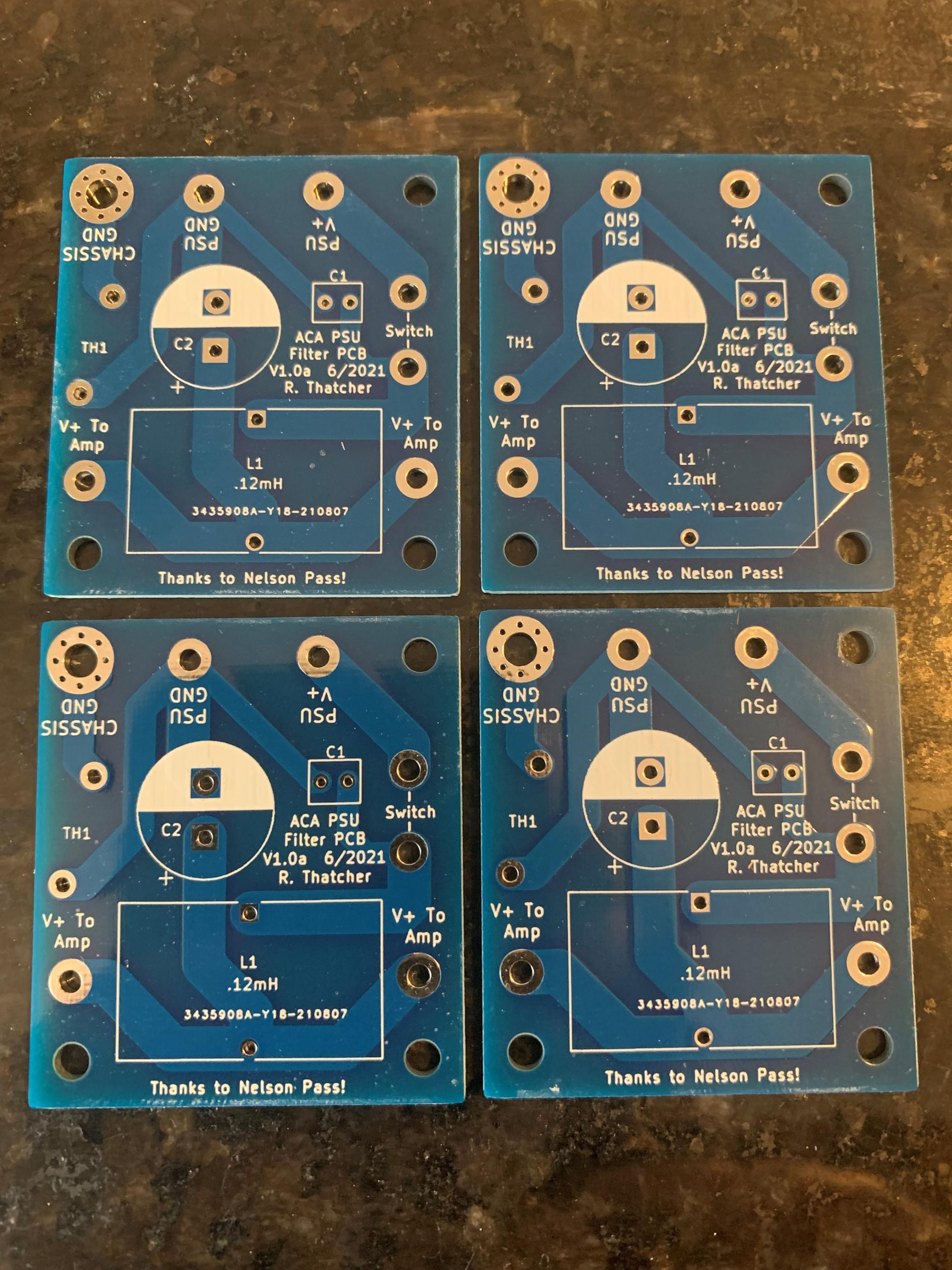

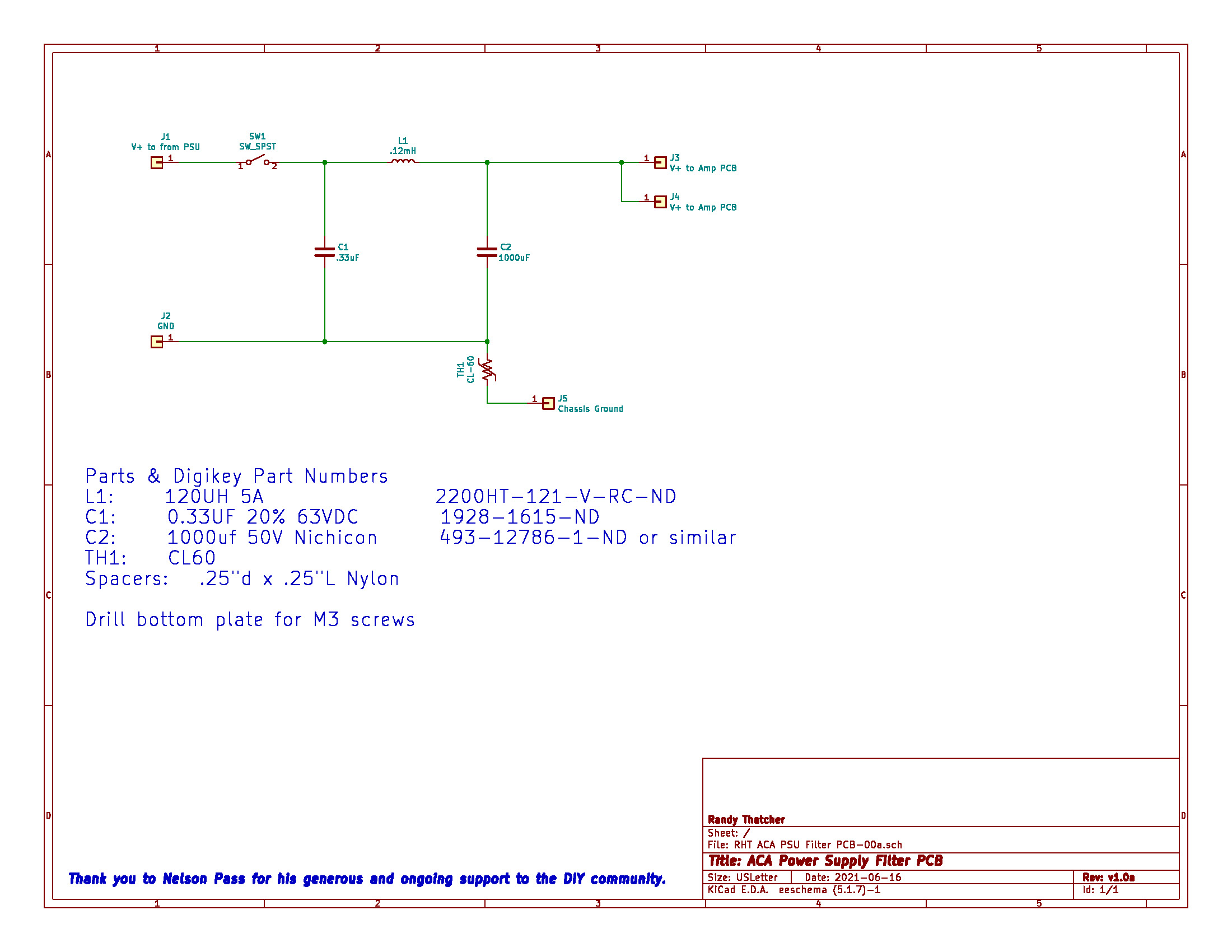

I made some "Rev 1.0a" versions that are basically the same as the VFET CLC board. For a Dual SMPS build you could use 2 of those, one per SMPS/Amp board.
Alternatively, I could make the next run of boards with 2 inputs and users would need to insert a jumper for 1 SMPS amps.
For this smaller board...
Ignore the Thermistor (leave it out, ACA is tied to ground at Amp boards already)
Only hook up one amp V+ connection on each board.
Drop power from the ACA front switch into switch hole by the "2021" text. You already have wire running from back of the amp to the switch - leave it alone...

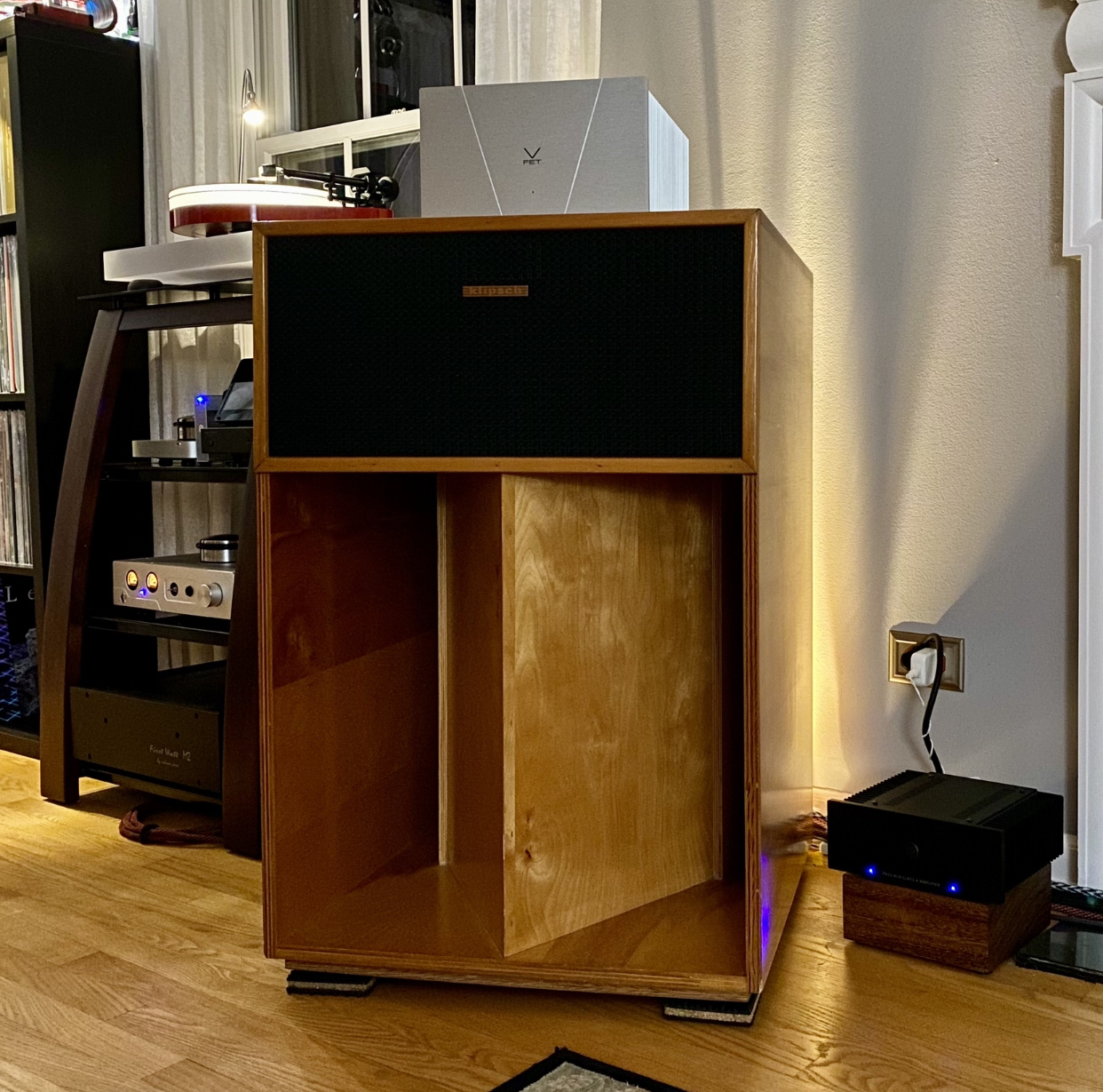

tell your friend that he can push the DIs as close to the wall as he wants -- JUST as long as he damps the back port. Owners talk about needing to move the speaker miles away from walls but this is nonsense. It is the low, back port that causes this need in their eyes. Foam will kill this phased-reversed garbage and so much the better.
That is an exceptional tip, and something that I had not considered. Placement of my DIs has been a PITA to say the least. I don't have an ideal room, and I have one node that I just can't fix. I'll try your tip. Thanks!
IAIMH: Thanks so much for the kind visuals...
Another point about the back port -- don't try and stuff foam directly into the port; this will dampen the woofer movement and make all worse. I get a 2'X3' sheet of 4" foam, cover it with speaker cloth, then position it on a support right behind the port. Works great. And from the studio world...as many first-reflection reverberations as you can kill in your listening room, the better the soundstage will become. This is because reflected music interferes with the clarity of the L/R balance created during the mix process. I use large sound absorbent wall panels behind the DIs, also covered in black speaker cloth.

Warning subjectivity ahead! I tried out the dual CLC filters from rthatcher in my ACA monos. I do not have the premium parts version of the ACA’s, but I do have a well appreciated pair of 1.6’s. Three days in of listening and they seem a bit more 3D. Which for my particular tastes is a nice little mod. I’m curious what others that try it thoughts are.
I have some PM's and some requests in the thread for the filter boards/kits. I worked up a group buy. See the following on the Group Buy forum:

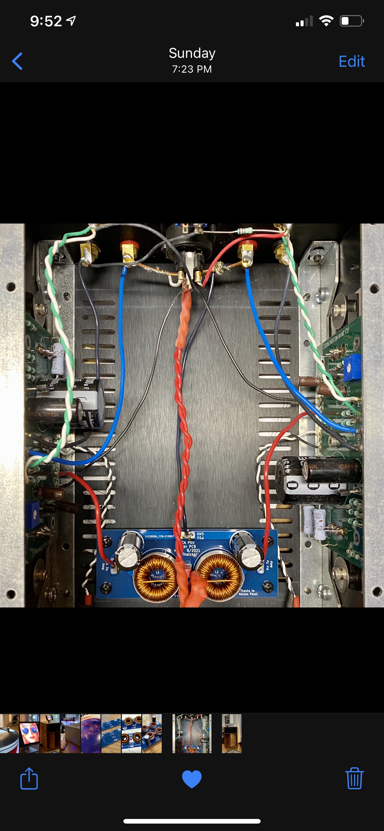

Just got the second dual-smps build finished and here is the news.
First, rhthatcher's dual-pole front switch works fine with one oddity. There is a groove on the ACA frontplate for the ridge in the switch housing to fit into and it only seats one way. With the switch oriented with the groove, the on-off movement is reversed. Down is ON and up is OFF. No way to adjust this by wiring or a different fit. Takes a while to get used to, but no problem -- and one switch turns on both SMPSs. the symbols on the switch remain accurate -- the circle is off and the line is on.
The unit turned on and worked fine from the start. Adjusted the bias to 12.5 volts for each channel to the Tekton DIs and the sound is mostly the same as the first DS ACA. Being a new amp, you can tell a very, very light "tight" or "plastic" character that wears off with usage. Same as the 1st ACA.
More surprisingly, this amp is definitely louder than the first one. Have been running some set-volume sources into it that I am used to with the first unit and the new build is clearly 3-5dB louder. Don't know why, for sure.
The only component changes made were Vishay/Dale resistors. Perhaps more telling, my first ACA was subjected to trying to bias with no load affixed. Didn't seem to cause any damage and both units are biased to 12.5 volts.
But it's the same amp and sounds the same "class A' way: great soundstage, superb dynamic naturalness, and good tonality.
These kits are over-the-top good at working right out of the workshop and the only problems I have had with both are the somewhat clumsy nature of bolting the parts together at the end -- requires a little ingenuity as the bolts are hard to seat and get to.
