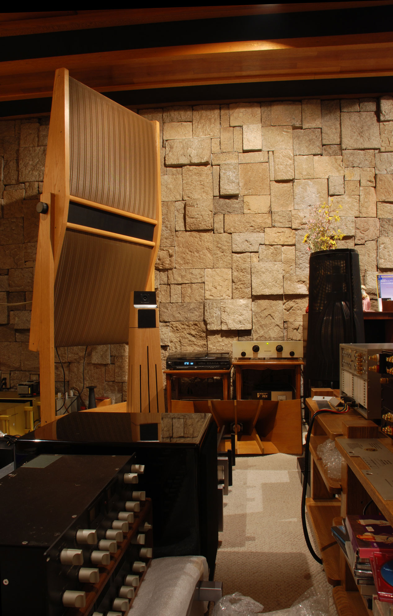

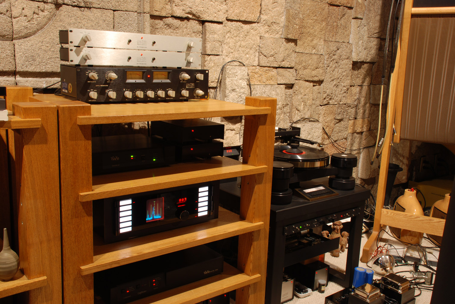

This is showing the Japanese admiration for old Threshold stuff:
https://www.diyaudio.com/forums/attachment.php?attachmentid=989140&stc=1&d=1633805919
https://www.diyaudio.com/forums/attachment.php?attachmentid=989141&stc=1&d=1633805919
Mark Levinson, Nelson Pass were a kind of heroes for the audio community.
Their Shinto believe (I Believe ;-)) says that every object has a soul. So they really like the souls of American made audio gear. They cherish it.

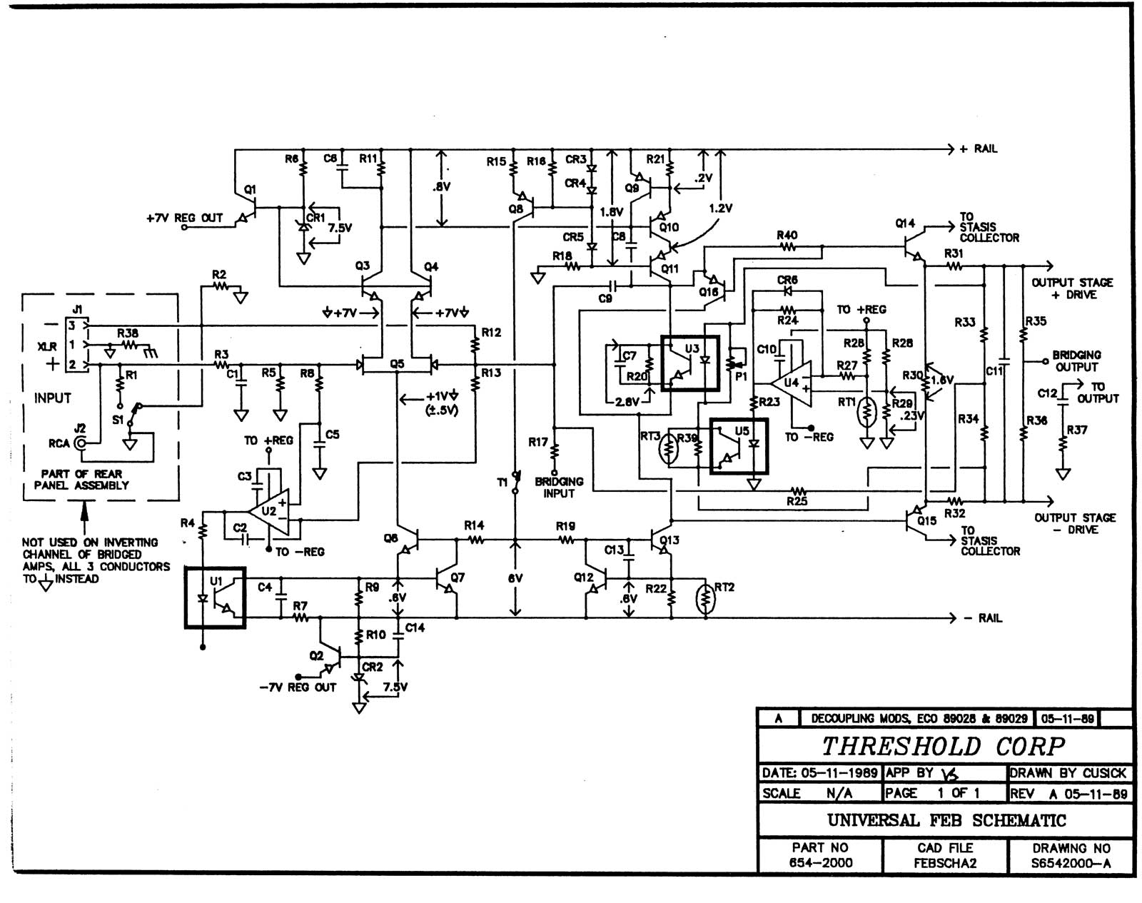

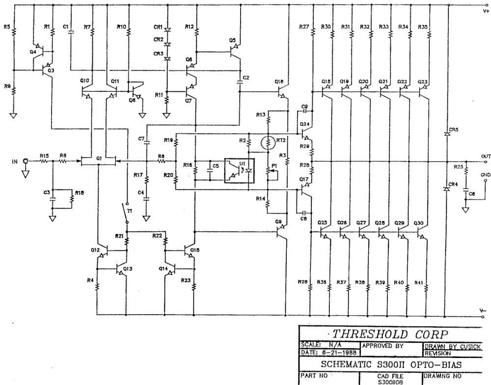

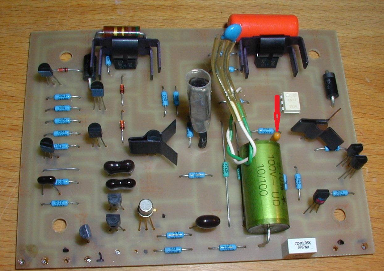

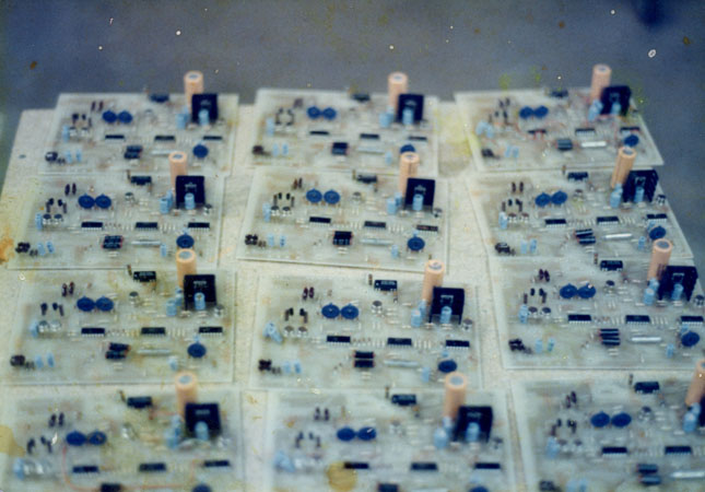

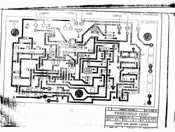

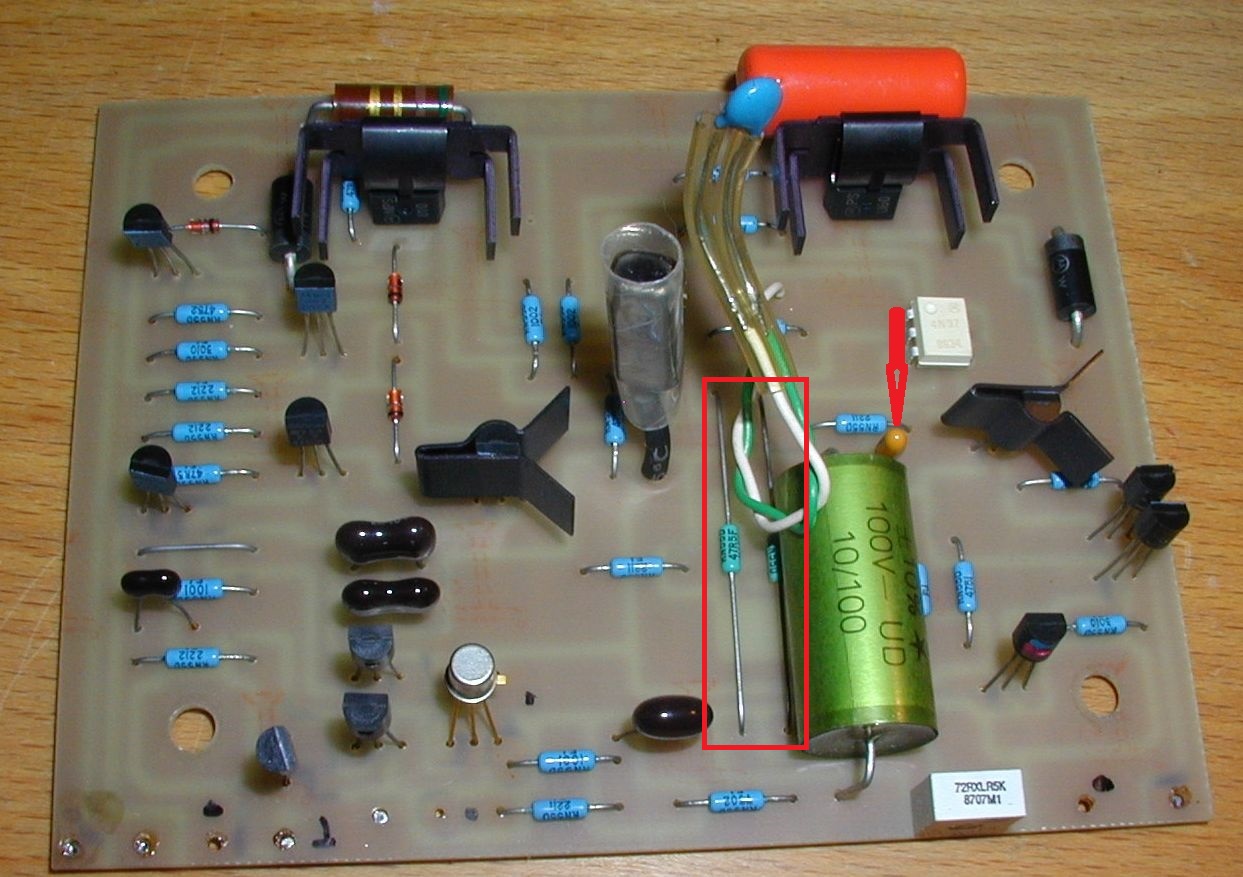

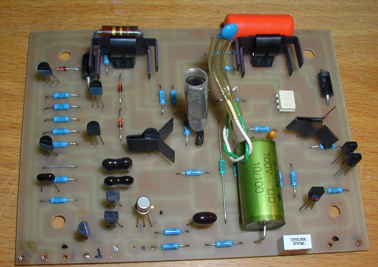

Tantalum to be replaced?
As said I have two S/500 optical bias versions.
Which part of the frontendboard should I replace. A tantalum I believe with what replacing part?
https://www.diyaudio.com/forums/attachment.php?attachmentid=989183&stc=1&d=1633810738
value of Tantalum?
(we are calling them Popcorns, nowadays)
I have no idea.
Will look further.

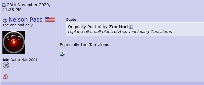

But is that the offender? That yellow popcorn cap?
yeah
if value permits (size) replace it with solid cap
in size is problematic, put decent electrolytic - these days they're better than Tantals of Yore ....... if nothing else, no Popcorning 🙂
see, He's making me green even with his oldest pcbs .......... two resistors in red
what is exactly written on?
I'm sorry, these where boards from my Threshold SA/1 amps optical bias. So I've now idea what is written on them.
But is it the yellow droplike cap in the vicinity of the green ERO filmcap?
i will look tomorrow for the values. I have a couple of Copper Teflon filmcaps lying around V-Cap CuTF but they are probably too big.
