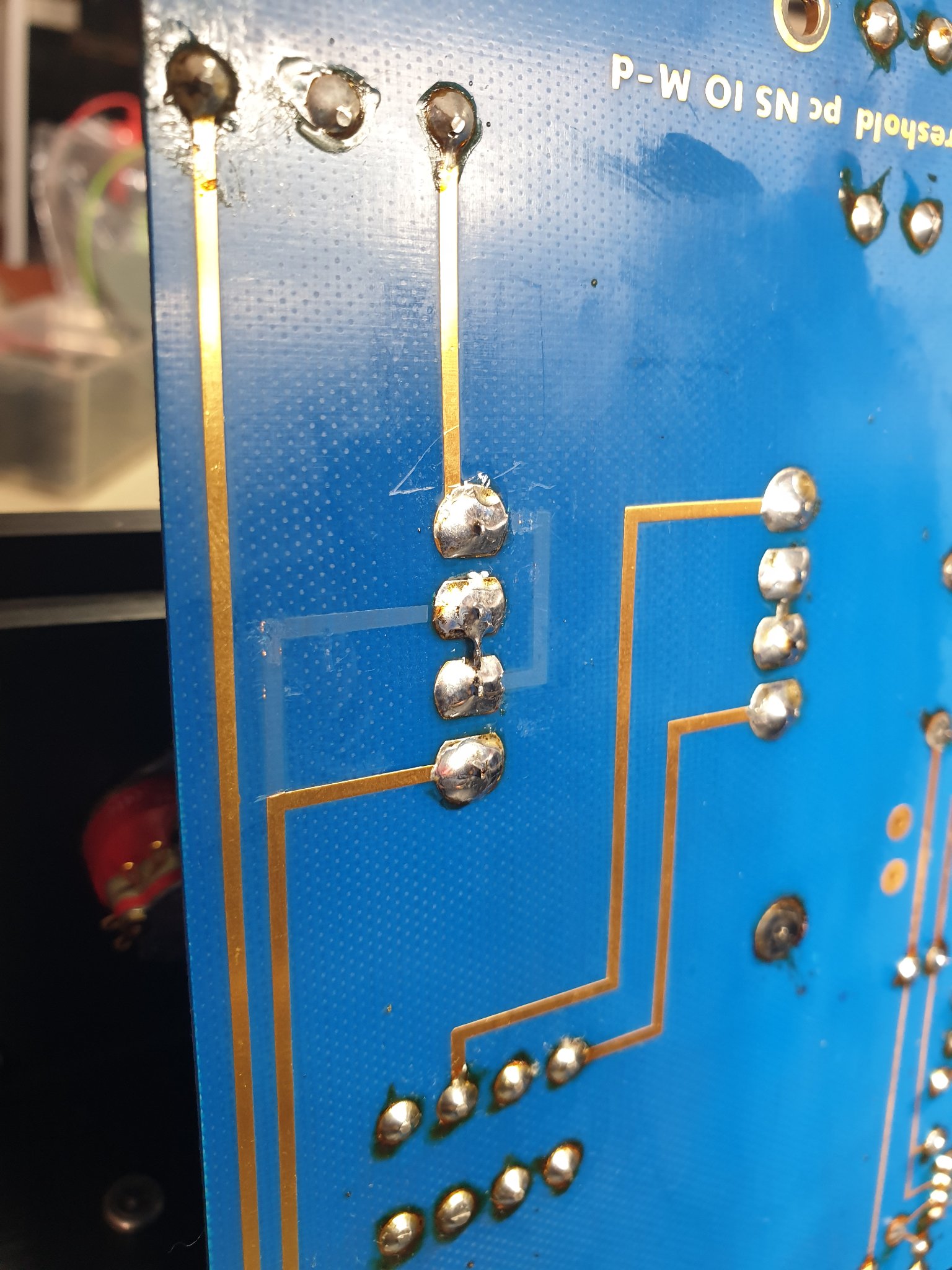

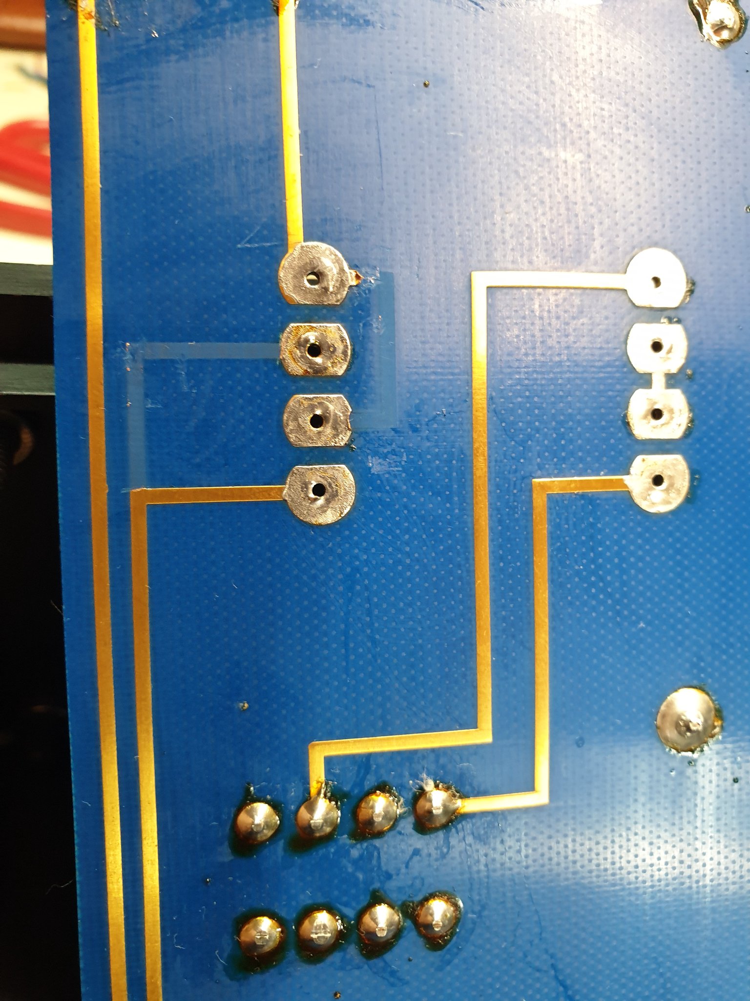

Hello.There's nothing complicated about converting the NS-10 to 220V.The original transformer is a 2x110V transformer with the windings in parallel.On my NS-10, I cut a track and connected the two windings in series.
