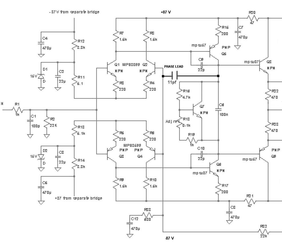

Hello
I have decide to ad a 11 pf phase lead capacitor to an amp that a friend ask me to modified, I was think to put it between the base of Q2 and the colector of Q6.
Just to be sure, is it the best place for a phase lead capacitor ?
Here is the amp input schematic.

cap is in the correct place. Allow for a series resistor in case you need to adjust. Or alternatively a parallel R+C to trim the stability/margins.
C8 & 10 might need to be retained but at much lower values.

AndrewT said:cap is in the correct place. Allow for a series resistor in case you need to adjust. Or alternatively a parallel R+C to trim the stability/margins.
Hello Andrew
I've found time to do those mods on the amp and a 15pf cap at that place do made the amp to sound better. The amp are a Sima 3050.
