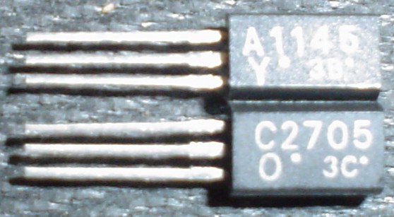

Dont sell the 2SC3423 too short, technically 1.5pf at 30v VCE 🙂, 1.8pf at 10V and higher than 30v even lower, but by .1pf or so, provided every specimen follows the datasheet specs
. This bjt was a revelation to me when I tried it in a previous amplifier as per Hughs suggestion, the 2SC2705 has identical specs but lower dissipation.

vynuhl.addict said:the 2SC2705 has identical specs but lower dissipation.
At 15-20 $C definitely a lot cheaper(and much easier to obtain) for a folded cascode VAS.
