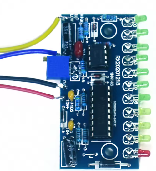

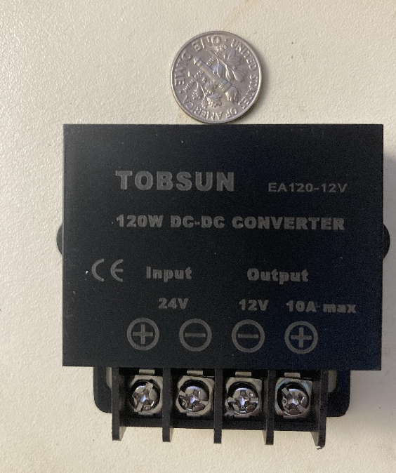

Now I will try adding led vu meter kits that require 12v supply.
Where would be the optimal place to draw 24v or 12v for the vu meter circuits? Would the switched power lead be safe for 24v supply to transformer?

I plan to reference the speaker level outputs at the boards for the vu meter input signals (they are designed to support speaker level input).
If I decide I want to try to "calibrate" the vu meters I will try using my scope, sending in a 1 khz signal to just below clipping amplitude and see if I can get the LEDs to match (although it was pretty easy even for my ears to detect clipping of the amps when it happened- like someone was playing a guido!).
