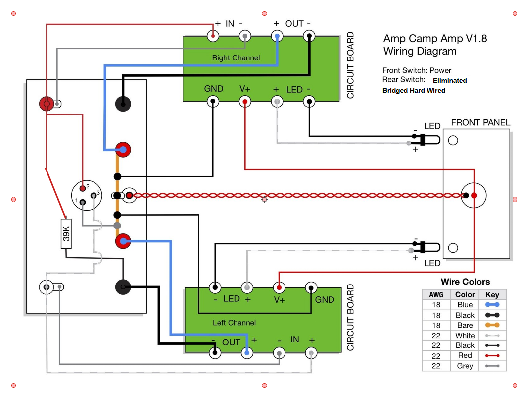

Don't power up until both your schematic and wiring photos have been approved here.
This is however a good idea for your situation, just keep good records so they can be rewired if ever necessary.

this can't be correct, it seems too simple 🙂
the 3 position switch is eliminated so no wiring to it. the concept then is that the left board's "negative out" on the diagram provides the input signal - attenuated by the 39.2k resistor - for the right board.
those are the internal changes.
then just connect source input and speakers as per 1.8 guide for bridged mono.

If you plan to run them perma-bridged, advised to disconnect the XLR connector. If you ever run them balanced, you'll have the left channel being injected out-of-phase into the right channel. Might also want to consider a dummy plug for the right RCA plug (or remove it as well).
Great, thank you guys. And I will keep the XLR and right RCA jacks off the panel for now. Can't hurt for cooling and since it's the back panel will not degrade cosmetics 😉

And probably I should delete the diagram I made? Now that I think of it, it looks too much like an "official DIYaudio" document, which of course it is not...

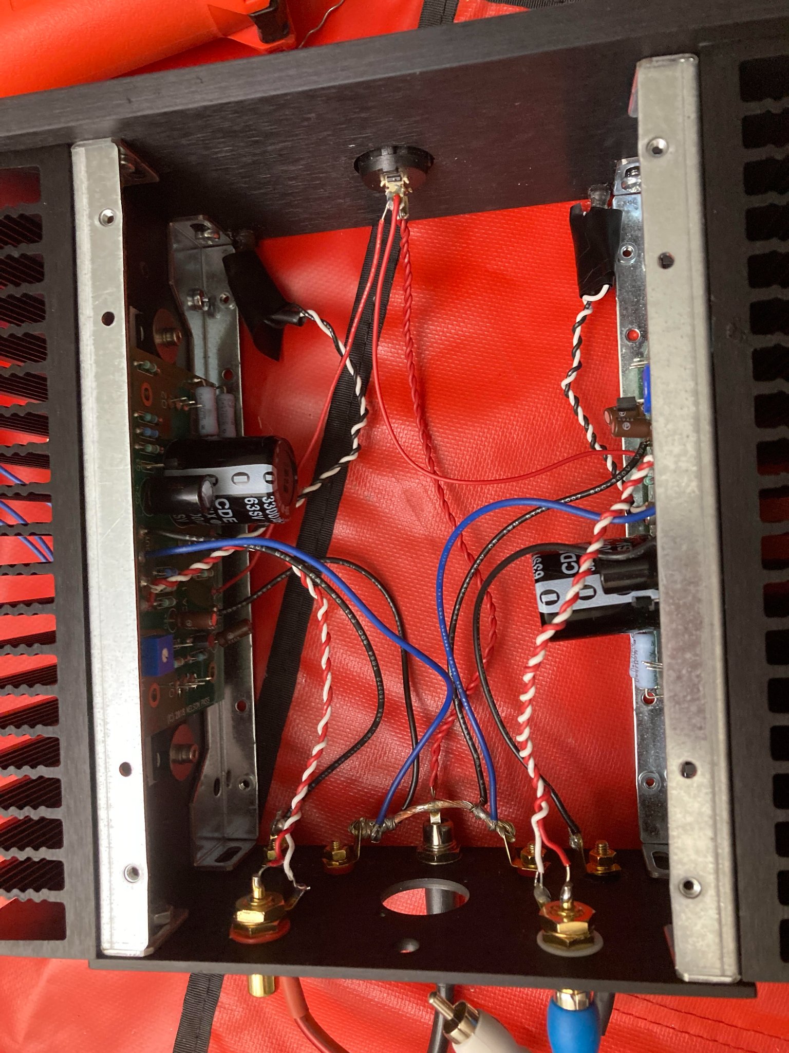

First unit completed, powered up and no smoke!!
Bias was easy to set just a slight tweak on both sides to bring them up to 12.5 v. I will check them again after some hours of running time.
With my ear right up to speaker there is zero hum, zero hiss.
Listening now to music tracks output as mono, and the one bridged amp sounds fine on my Pioneer sp-bs22-lr test speaker.
After about 15 minutes running time I can keep my hand on a heat sink for only 3-5 seconds which I expect is normal.

Been listening to the one bridged unit all day using stereo to mono cable from FIIO M11 Plus streaming TIDAL. Sounds excellent, so I decided to go ahead install the XLR input since the M11 Plus can output balanced, and I will add some heat shrink insulation in places that should have it...
