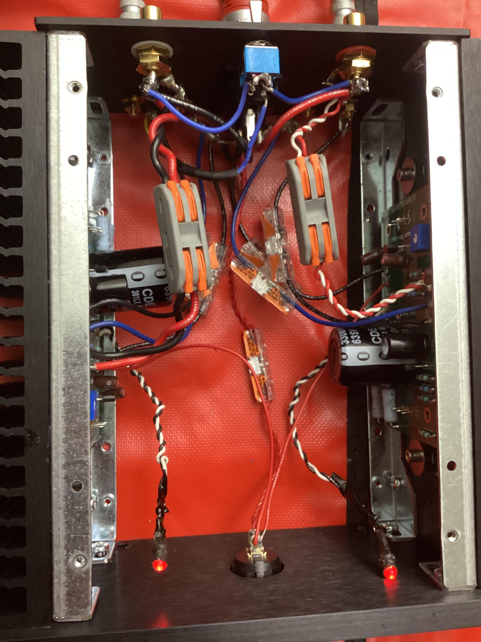

I will go ahead and install the output mode switches. Will be fun to be able to use both RCA and XLR inputs for bridged mode while I search for switch upgrade.

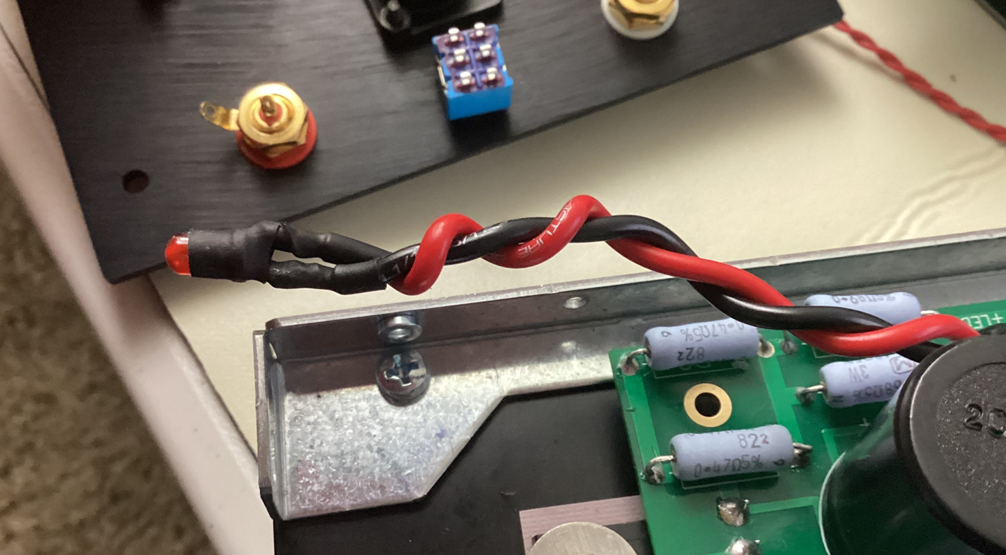

I learned a lot about the theory and topology of the amp from the first build and will post pics of the second unit's internals, and do a better job wiring and soldering (example LED pic).

Opinions on connectors?

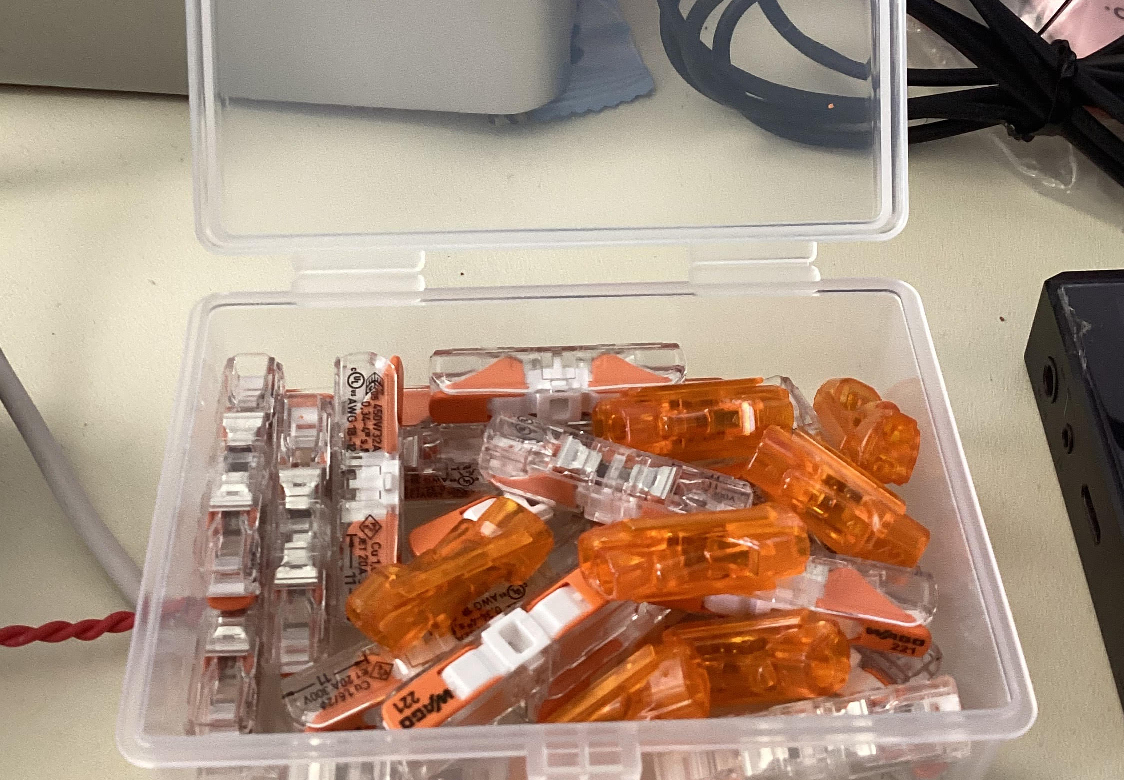

Would using wago connectors for the signal and power wires to the front and back panels cause any distortion or allow noise? I assume the connectors have no internal shielding. The first unit I built using soldered wiring only had absolutely zero hiss or hum 🙂
I will be experimenting with components and it would be great to avoid repeated desoldering/soldering cycles.
Would sure make mods and experimenting a lot less hassle...

hmm, looks like I will need 11 or 12 connectors to make the back panel "removable" without de-soldering. The interior will be crowded. Now I know why molex is so popular...Try 'em. Find out. You got a reference unit to compare it to.

Lever connectors seem to work fine. I did not perform before and after distortion, noise, power, etc. measurements with test instruments, just listening tests... If there is any added noise or distortion after adding the connectors I cannot hear it.
I did one at a time and powered up for listening tests each time to facilitate troubleshooting in case there was a problem.
I will add connectors from the boards to the front power switch and then I can change out the boards or back panel anytime with no resoldering.
Now it's time to get going with the second unit so I will finally have bridged stereo system.
Second unit completed with no issues and both units now running with balanced XLR input as bridged mono pair. Will listen for a week or two with my testing speakers before moving into main system that has external speaker protection device and DeCapo I speakers. For me, the lever connectors are very convenient although it would not shock me (pun intended) if there was some miniscule increase in measured distortion or noise from using them.
