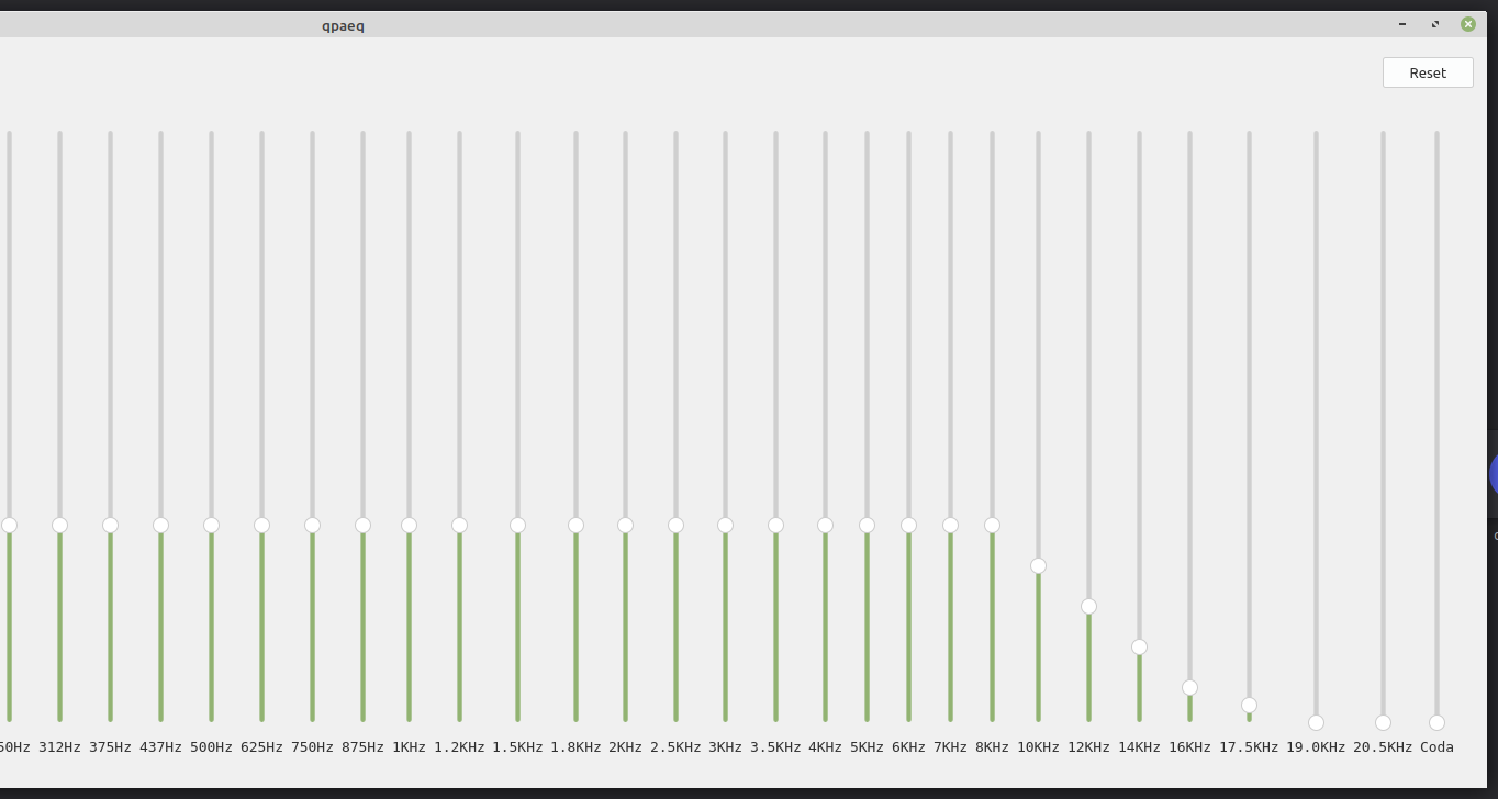

I was blaming the steel in the cabinet for giving me a headache until i started to play with an equalizer and fixed the issue. however, the software solution is introducing pops and clicks.
is there a way to do a linear roll off from 8khz to 18khz using discrete components. just trying to get some value out of my budget speakers here, without shelling out for a hardware equalizer.
the treble knob is a help, but not as useful as i'd like, impacts the audio too much without addressing the issue.
you can look at the attached eq sliders to see what values i have them set at.
