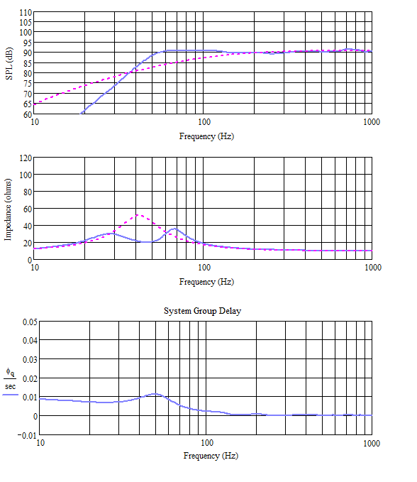

Is there a way around the bass notch flaw by using two different length cabinets with 4 ohm drivers in series for an 8 ohm load

It crops up from time to time, and in theory it's possible, in practice somewhat harder to achieve. Generally speaking, a better plan tends to be to use an ML-Voigt design that doesn't suffer from these issues in the first place, or at least to an extent so far reduced that it becomes a non-issue. It's largely a question of design optimisation. For e.g. the attached. This is an ML-Voigt; as you can see however, pipe harmonics are suppressed sufficiently for the overall frequency / amplitude response to be reasonably linear. It could be made more so on the graph with a little extra damping, but in practice it's unlikely to require more, and some may prefer a bit less.

The pipe I provided plots of above is no harder to build than the LCofN Voigt pipe. It looks very similar, there are no additional panels, no additional vents, nothing. It's just designed for a specific drive unit, and relatively more highly optimised to suppress the unwanted harmonic modes.
Nope, no internal panels, unless you feel like adding some bracing. This is (was) one of Dave and my old commercial designs, so I'll have to dig the pdf out -I'm currently on my laptop rather than the desktop. Remember though, that is a speaker design, not a generic pipe: it's designed and [reasonably] optimised to a specific drive unit and will not give that result with anything else. ML-Voigts, aka ML-horns, tapped horns, Voigt pipes, Voigt-horns etc. are no different to any other enclosure type -for best results, you design the dimensions & tuning to a specific driver (and as relevant amplifier) combination, as far as possible anyway.
