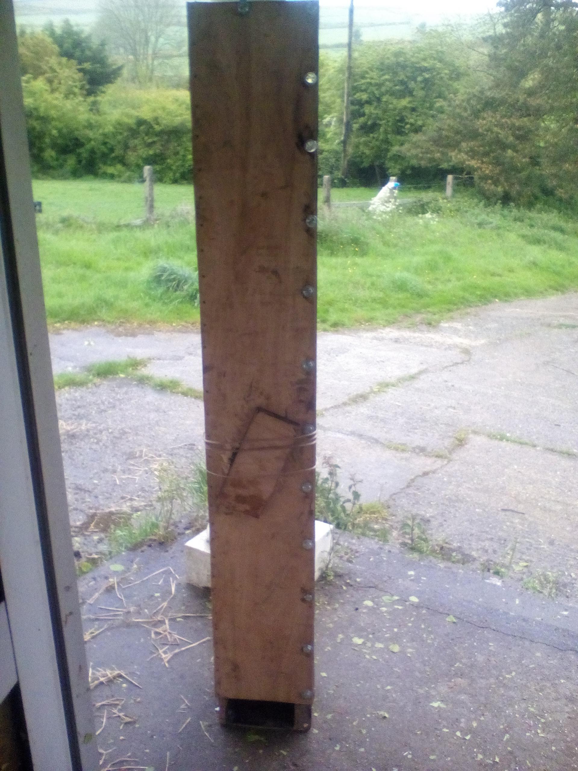

It rained all day so i spent the day completing the composite voigt pipe. after a false start where i realised the new pipe was exciting the old pipe passively i removed it from the room. i stole an 8 inch 8 ohm driver from one of my monitors to install in the pipe.
The pipe seems to be acoustically dead. when i strike at the base like i did with the other, it doesn't continue to ring at all, just gives one ping and that's it. i wasn't able to put my ear up to the speaker port as it was installed.

In theory this should be better than a cabinet with a lot of material inside as the internal geometry is close to ideal. the only compromise i made was a slightly smaller bottom port due to an extra bracket to bolt wood to steel.
I ran into difficulty with a gap between the two wooden surfaces. it is vibrating with strong bass. I'll have to buy a glue of some kind. I'm thinking of heating up hot glue in a saucepan and pouring it along the join. the gap was caused by the mating surfaces not being absolutely flush due to the steel warping while welding. wood is not my preferred material for working with.
I can crank the wattage up so high i fear the speaker will blow and it stays clear. i pause the audio and it's instantly dead silent, the old pipe would ring for a few seconds.
In some percussive music i can hear the steel tone the cabinet imparts. i'm fine with it so long as it doesn't ring. i guess if i had a wooden pipe there would be a wooden tone (which there is actually, but not noticeable)
I will make the other pipe in a mirror image. all in all i think the project was a success.

It seems counterintuitive because you would expect steel to ring but it silences any oscillation instead due to the mismatch in resonant frequencies of the materials used. pretty cool idea, works on all frequencies and no downside apart from cost and aesthetics. I'd say you could do the same with the frugel horn by replacing the hidden internal plate with a steel one.
