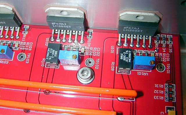

Dear members,
I tried to find how adjust all trim pots on Shine7 solutionBPA300. What should be done to achieve the lowest DC on output ?
I tried to find some explanations on Intrenet, but there is no straight procedure to do it.
As you know there is 3 LMs and 3 trim pots, so what to do to receive famous 9 mV on output?
Sorry for stupid question, but I have to…
Thanks in advance, regards,
Boris

you adjust the pots before installing the load sharing output resistors.
set all six output offsets to be as near to equal as possible (and as close as possible to 0v).
i use a temporary 12R load on each chip output pin.
The problem I see (I have never tried to build any of the multi-chip implementations) is that the output offset varies as the chip/s warm up.
You can set the output offsets to match when completely cold and watch them wander off and destroy the amp as the imbalance becomes too great for the output stage

you can set the output offsets to match after the chips have warmed up, then watch the amp destroy itself due to unmatched output currents during start up and the following warm up offset error.
A DC servoed amp that is "zeroed" when cold and uses the servo to maintain that "zero state" during warm up is in my view the right way, based on the FACT that National show a triple servoed version in the ap note.

Thank you all, but how position trims? To the lowest or the biggest value before powering up?
Nothing is the problem for me except adjustment. Always there are many questions, doubts, and opposite suggestions.
Is there any cookbook by Alex which can explain what to do and when?
Someone say desolder output resistor, others say no. Someone say measure on output pin number 3 but what to measure and what to set on this pin. We have 3 pins on eash board. Do I need to set 3 mV to achieve 9 mV in total or anything else?
Is there any potentional posibility of damage any of circuits if I apply wrong measure procedure?
Once again thanks to all, but I'm still blank.
