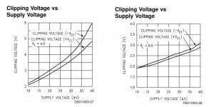

If one chip can supply 22 Volts to a load. What is the maximum voltage that 2, 4 or 6 parallel chips supply?
The answer is 22 Volts. No need to do the maths. 2, 4 or X chips the answer stays the same.
If there is no increase of the voltage and the load stays the same, the maximum power also doesn't change.
Calculate the maximum power for one chip with the rail voltage and load impedance, if you have one chip or six the maximum power stays the same.
Please explain.
It's another way of saying you should think and read a datasheet before posting.
Try figure 33 in the 3886 datasheet.
That still doesn't get you near the claimed 160 watts into 8 ohms.
It is my lack of knowledge that is showing, or my attempt at over simplifying things.
Wouldn't that calculation be for a 2 chip amp? IE PA100? I didn't run the numbers other than in the Overture Design Guide from National. It claims 160W into 8 ohm with 6 paralleled LM3886 with a +/- 24V supply.

it's part of the no-good-deed-goes-unpunished paradox. Mark Whitney was simply using rough estimation in trying to get the OP to understand that there had to be something fundamentally wrong with the spreadsheet results for what was supposed to be 8 ohm load and +/-24v rails. despite the later on and silly +/-42v red herring, we now know that the spreadsheet's error was caused by its arbitrarily substituting another load instead of the 8 ohms the OP thought he was using.
For those that missed it, Jacco is referring to a lower clipping voltage (higher output voltage before clipping) at higher load impedances. The datasheet does not state the clipping voltages for 16, 32 or 48 ohms, this leaves you guessing. A 6 chip 24 V parallel amp may squeeze an extra one Volt at the output compared to a single chip.
And a 6-chip bridged amp with 24V rails can't do 150W in 8 ohm.
figure 33 expresses (for 20hz-20khz THD+N 0.1%) single chip output power vs load resistance at +/-28 and +/-35 so a reasonably accurate estimate is possible.
ex: if each chip "sees" 12 ohms then figure 33 puts a bpa300 (6 chip) at pretty close to 180W using +/-28 (volts at full load). of course this does not account for mains variation etc.

Each chip will see 6 Ohm impedance for a 6 chip into 4 Ohm load for a bpa configuration.
Or 12 Ohm with a 8 Ohm load connected.

An amplifier that has fixed supply rails will deliver a particular voltage and it's commensurate current into a specified load.
The maximum Voltage is Vrail minus the amplifier loss. i.e. Vpk = Vcc - Vloss.
Vloss depends on the current passing through the amplifier. Change the load and the Vloss changes.
National's Clipping Voltage graphs show this.
Parallel a pair of identical amplifiers and the effective load seen by each amplifier is roughly half the actual load plus whatever balance improving resistors have been added.
Multi-paralleling of identical amplifiers achieve even more Vloss reduction, but again the balancing resistors add in their losses.
The overall effect of PA style (National's Parallel Amplifier topology) amplifiers is that there is an increase in Vpk less the Balancing Resistor loss resulting in a small increase in Vk and a small and almost insignificant increase in delivered power to the load.
The claim that Rowland can get 160W into 8ohms from parallel combinations of 68W into 8ohms amplifiers is simply impossible.
There is something else going on. Almost certainly Bridging combined with Paralleling, i.e. BPA style amplifying.
